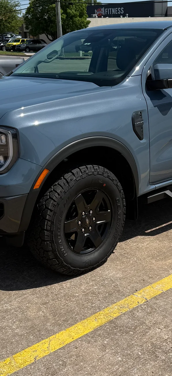

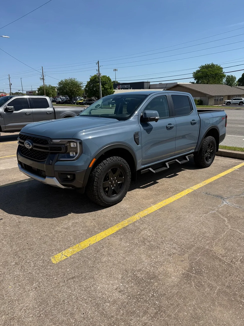

Here’s what I did, see what you think. 2025 Ranger Lariat with stock 255 65R18 Goodyears. After combing through the forums I bought Black Diamond take-offs from Bronco with 700 miles on them. LT265 70 R17’s General Grabber ATx, load Range C, severe weather (snowflake/moutains icon). No drivability issues, clears everything well. The only thing you may need is TPMs sensors if you cannot use yours.

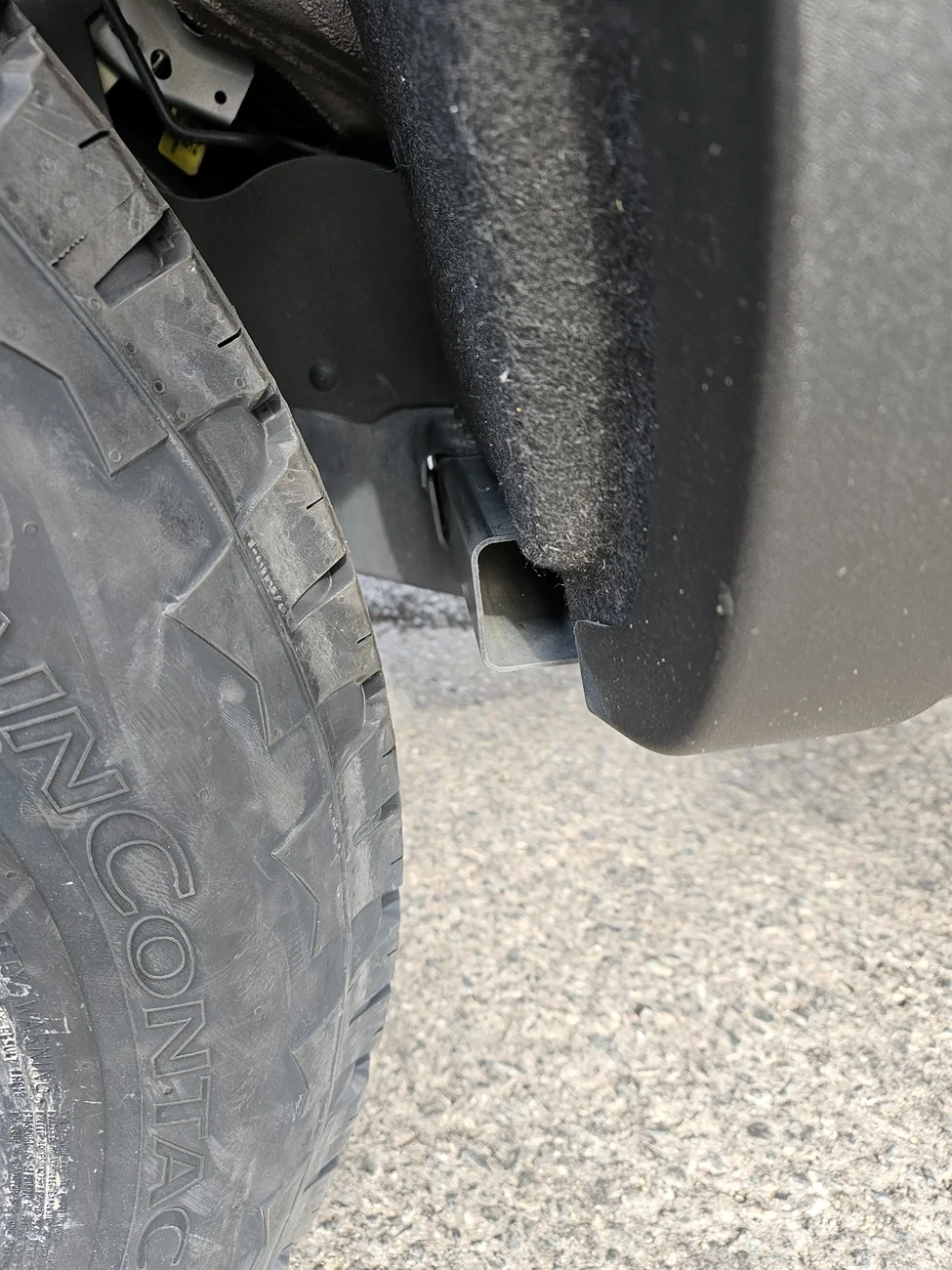

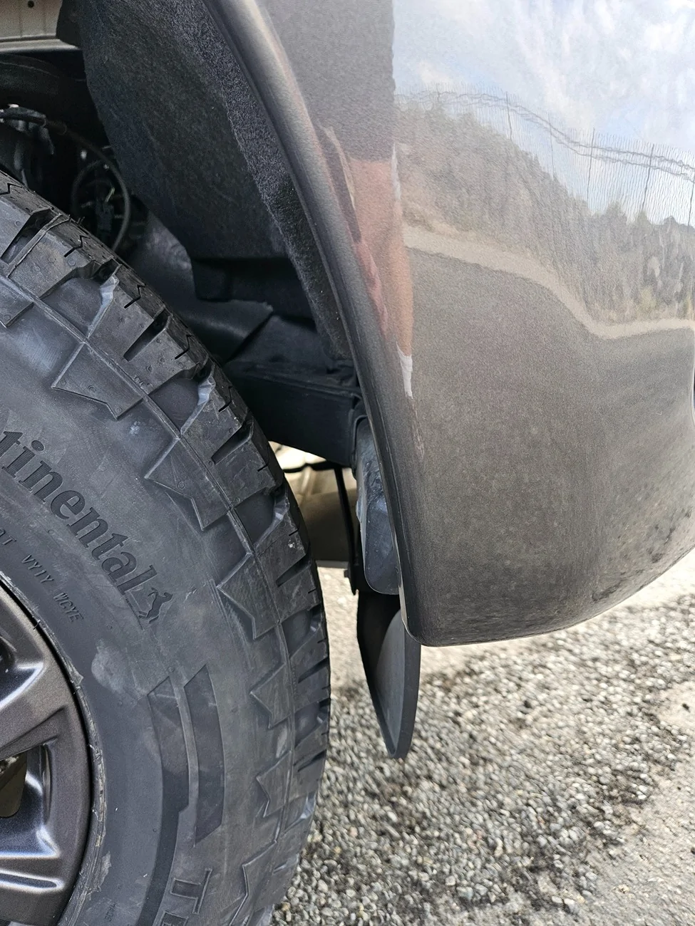

If you move the crash bars to their most forward angle, you can usually get away with 285/65r18 (285/70r17). I ran the 28570r17 on my stock Ranger and *barely* kissed the crash bar in reverse, but I hadn't moved the crash bars forward yet. All tire manufactures vary in their physical sizes vs claimed sizes. BFG runs a tad small. Your best bet it so have a local shop do a test fit. If you're near a Discount Tire/ America's Tire, they will do that before you buy the tires to make sure they are going to fit.
If you want to be safe, 268/70r18 is only 5% bigger than the OE 265/65r18 and should fit without any problems. Again though, have someone test fit them for you. That is the only way to know what will fit.

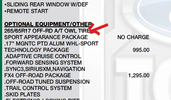

Mine came with 265/65R17 from the factory and as stated above, I went up to 265/70 with no issues.

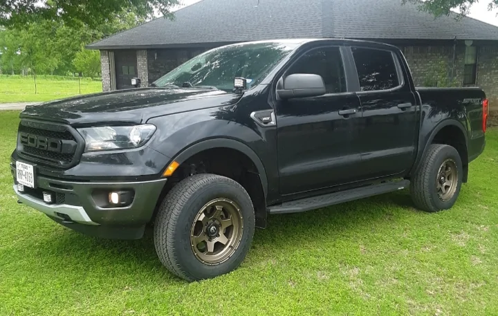

I took a different approach on the wheel/tire/level combination than most of the other members on here.
I have a 17×9 wheel with the stock size tires, all season Goodyear Wrangler HTs, with 5100s all the way around with fronts set at 1.8.
It's a highway flyer.
