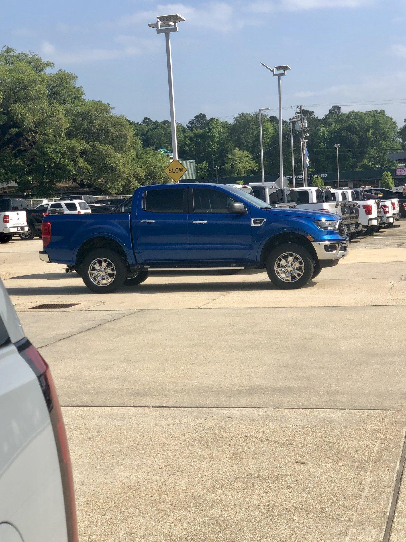

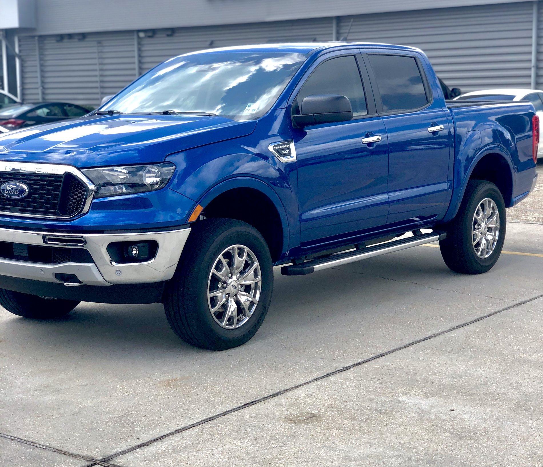

After recently purchasing my new 2019 Ford Ranger XLT 2WD supercrew I had a 2.5” leveling kit put on. Now looking to put on a bigger tire and wanted to see what my limit would be. I was thinking a 31” or 33” would look pretty good. Any suggestions ?

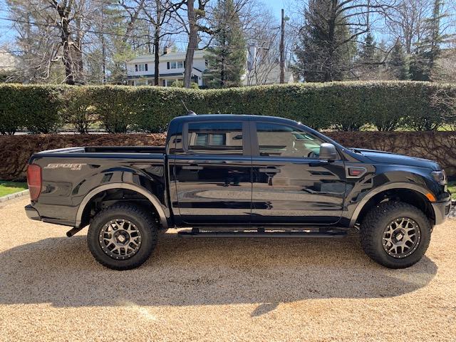

I also did the 2.5" BDS/Fox Lift and i was able to fit:
Wheels: KMC Wheels XD127 BULLY Off-Road 18"x9"/+18
Tires: Nitto Ridge Grappler 285/60R18 120T XL 31.46/11.5
Front rubs a little when backing up while turning. Did have to remove some metal piece from the inside bumper (crash bar)
