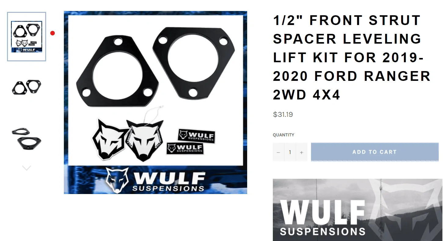

Wonder what stress it would put on the half shafts to add a 2-2.5" level as some have already done on their Tremor package trucks. I don't see where Ford changed the axles and from what I have read you shouldn't exceed 3" +/- from stock height and the Tremor already has 2" up front. Not thinking I'd go more than a half inch to an inch max.

Hi TBR,
It would be nice if Benny could verify if in fact there is a different part number for the axles for Tremor.
