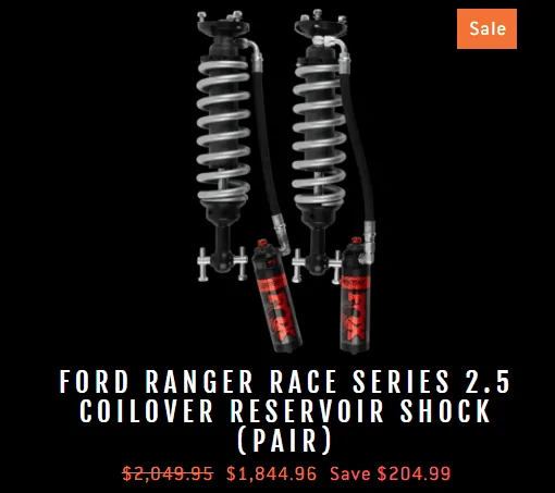

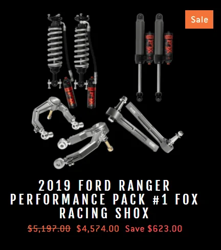

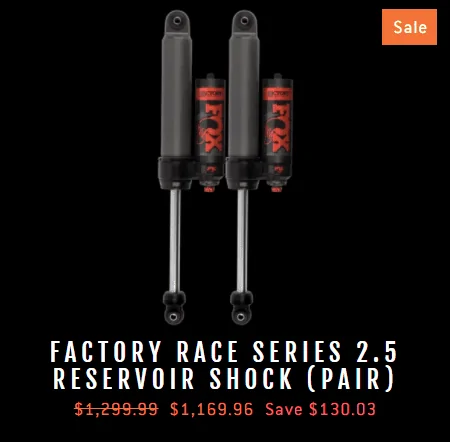

Stock 2.0s on a Tremor have no ride height adjustment. In order to get more lift without replacing the 2.0s you'd likely have to do a spacer above the assembly (leveling kit). Not sure if I'd take the assembly apart and gain lift with a different coil in the stock 2.0. If you want 3"+, you could replace the fronts with 2.5s which can be 3" + and add a 1" block to the rear or add a leaf.
Fox 2.5s front and back, replace the control arms and leafs for not much more than what you spent on the tremor package.

If you go with a kit with new Upper Control arms, make sure they are compatible with your truck. Most, if not all of the Tremor's have cast spindles and not aluminum. Only ones I've seen compatible are Camburg and APG. If you look at ICON kits with upper control arms, they will state for aluminum spindles only. Hope this helps...
