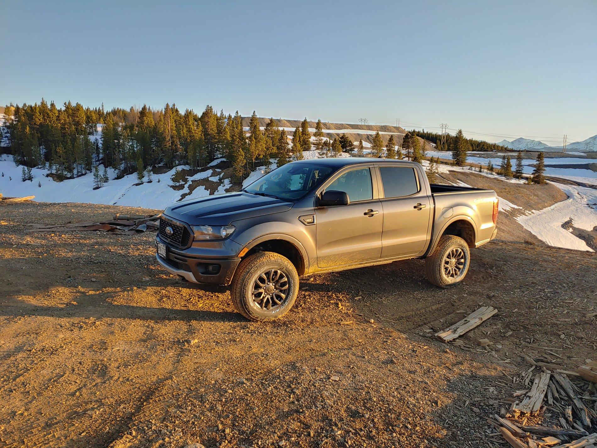

If you want a PROPER lift then I would suggest the Old Man EMU lift by ARB!! I have it on my Ranger and I love it!! The street ride is cleaned up and the offroad performance is nice for what it is!! I am in the High Rockies in Colorado and have been offroad quite a bit before and after and I can say the difference is great!! The one thing for comparison is one trail I did the whole teeter totter in one spot when stock. With the Old Man EMU I went through the same spot without having to worry about it!! Here are some pictures of it!! I also went with 265/70-17 Bridgestone Dueler AT Revo 3's.

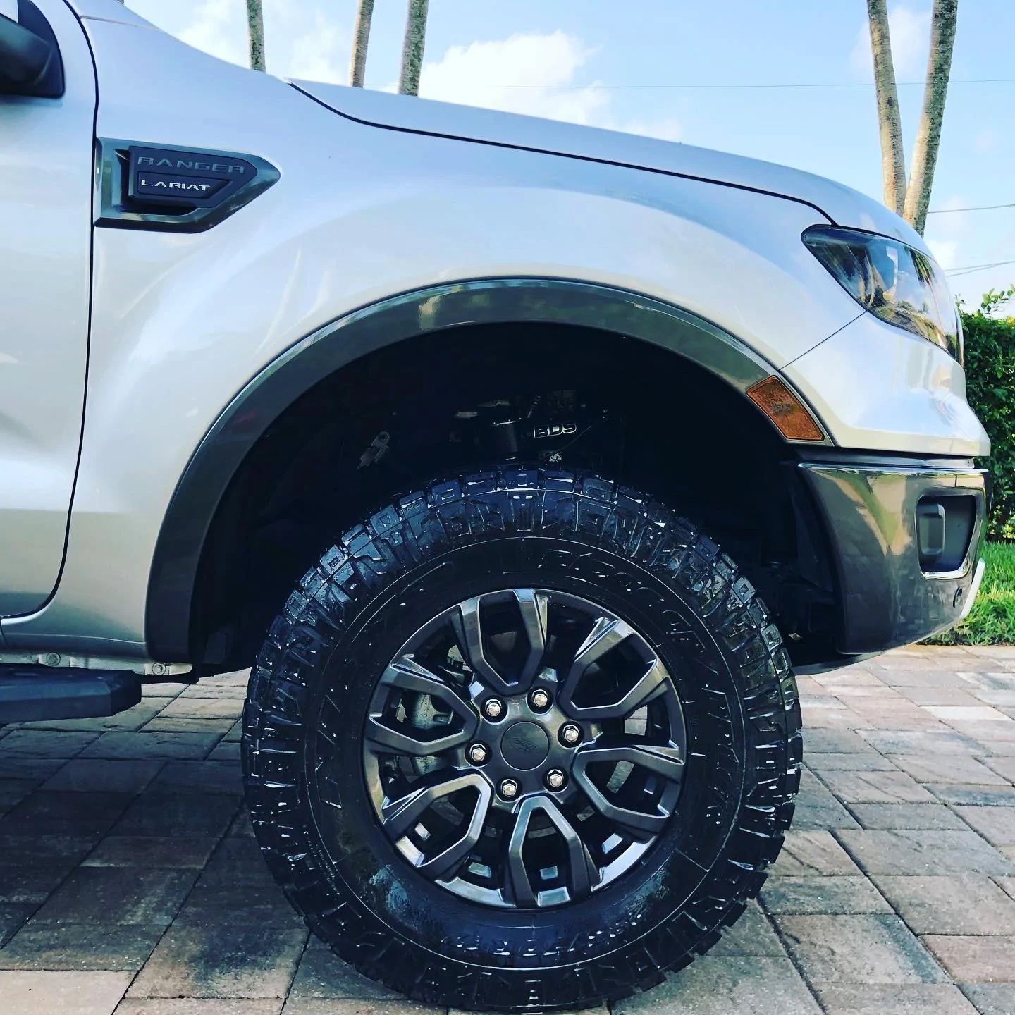

I am also running the FOX 2.0 w/ BDS UCAs and I love the end result. Great height and really good ride quality. Very happy with the whole set-up.

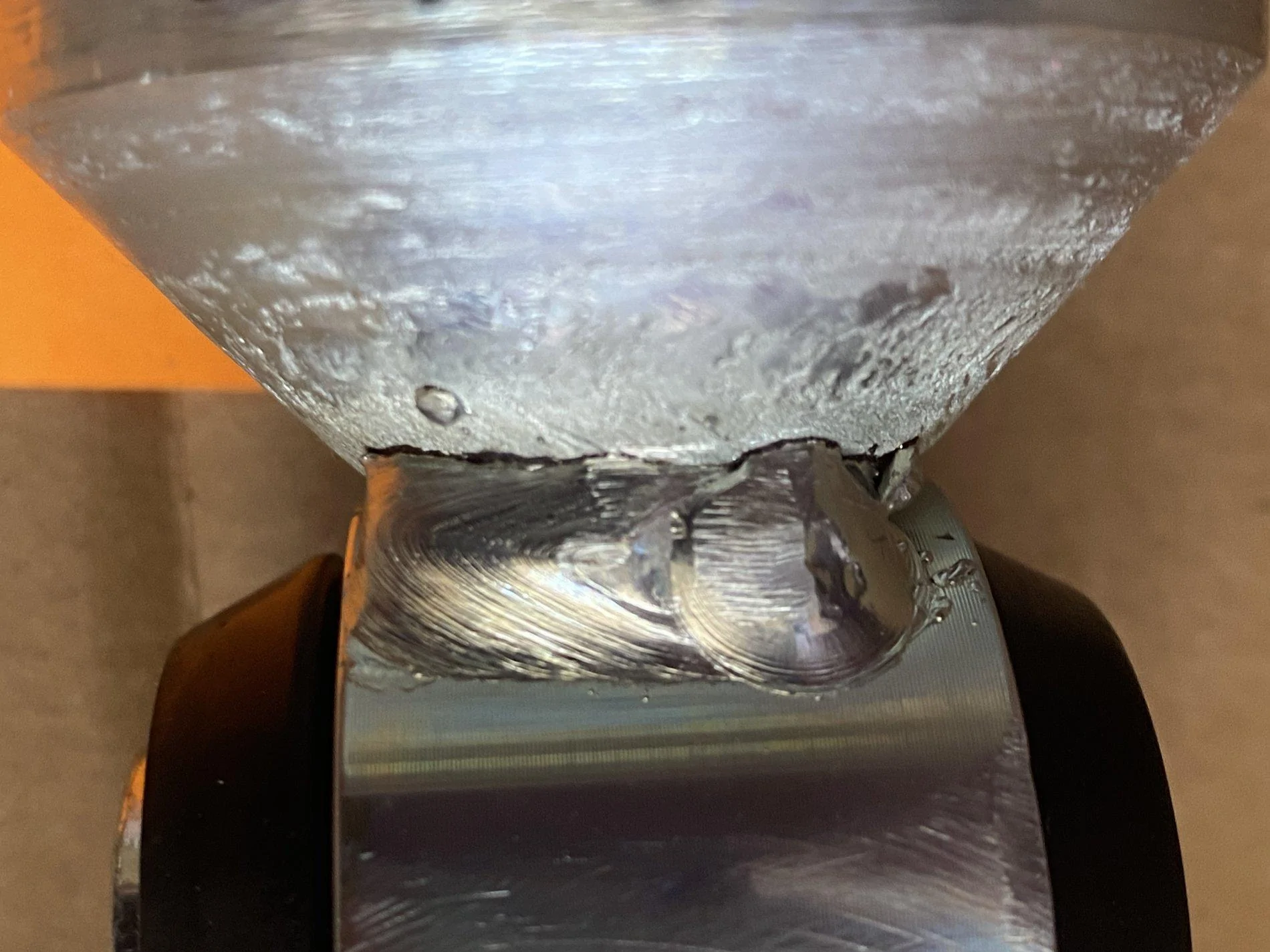

Thanks for all the input. I ended up going with the Eibach setup with icon UCA. Got the front installed but the mechanics would not install the rear shocks due to defects in the welds.
waiting on the rma to come but COVID is delaying that a little. I’m liking the ride so far but can’t wait for the full setup to be installed.

Hi Tim,
Kudos to your mechanics. Clearly not properly welded. Good catch!
