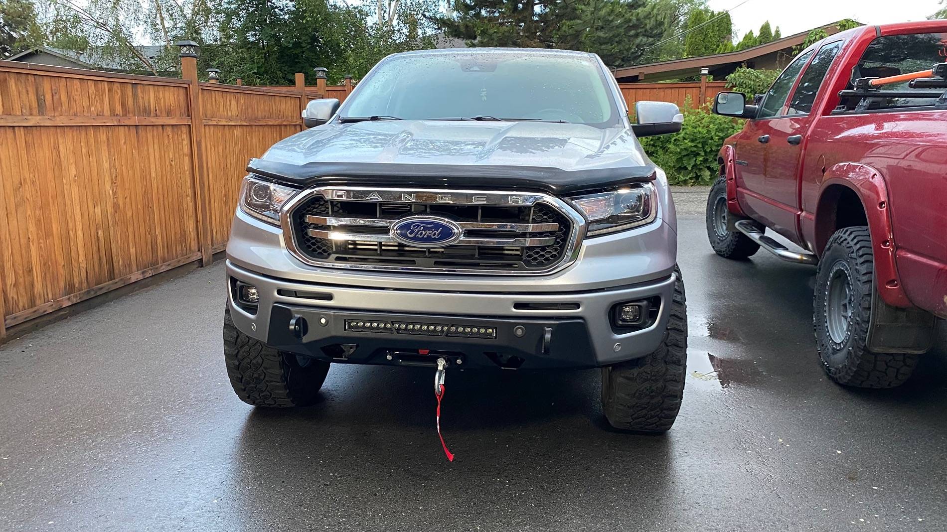

I run that warn winch and a small bumper insert from JCR off-road, bilstein 6112 upfront and had no droop, if that helps

Not off hand but I believe it’s approx 100lb over stock, in the 600’s … I believe

they are also adjustable so could compensate but like I said mine never sagged. The back end of my truck is a different story with topper and drawers etc.

Yes, 600lbs. I love my 6112's. I'm running the Ford Performance bumper and a Warn Evo 10S. I'm looking to go to a different spring, but your gonna be real happy with the product as is.
