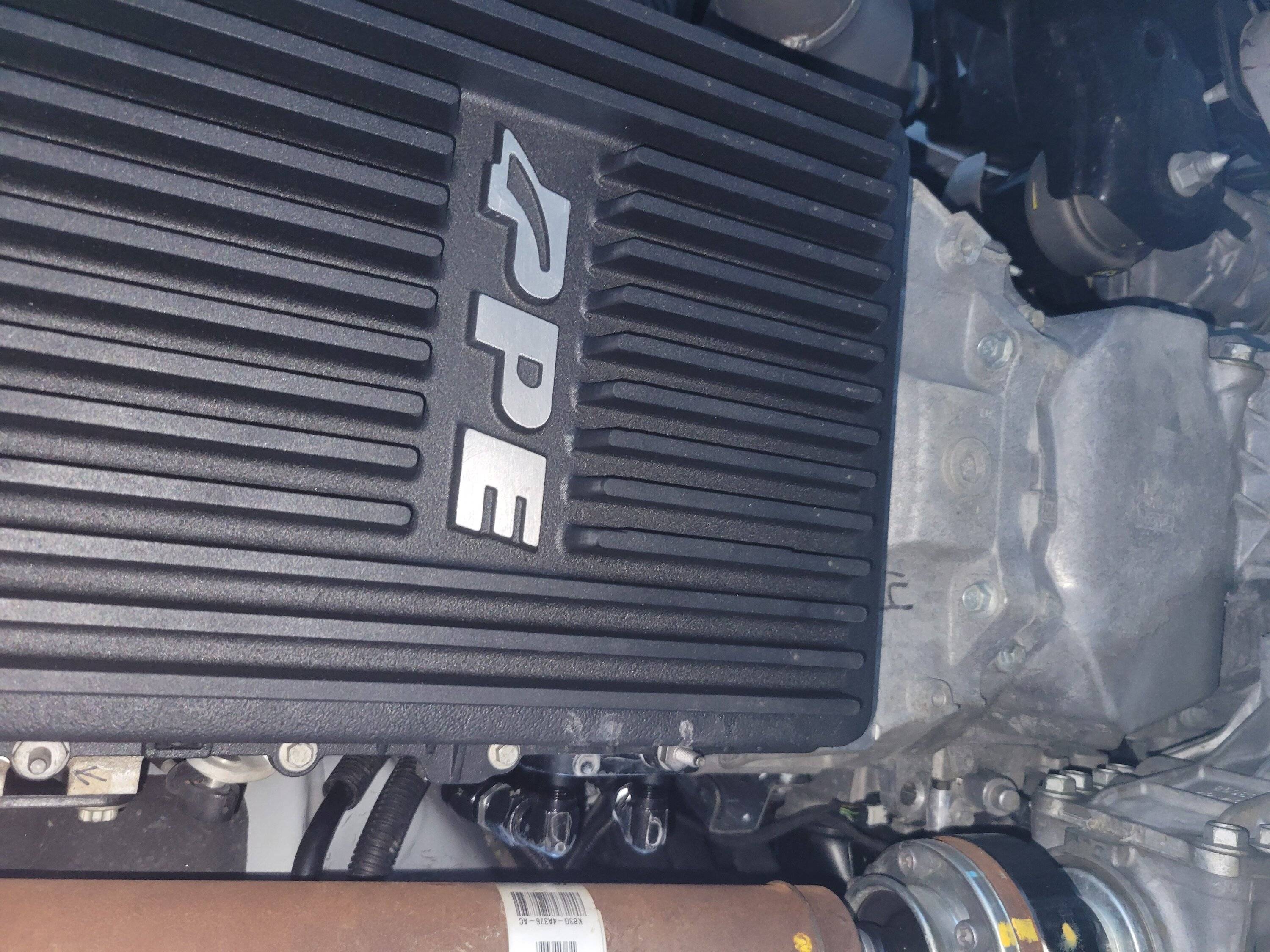

How did you end up doing your remote trans cooler? I’ve been trying to figure this out for a year and I absolutely need help. I do a lot of heavy and long towing. The highest temps I’ve seen were 241.

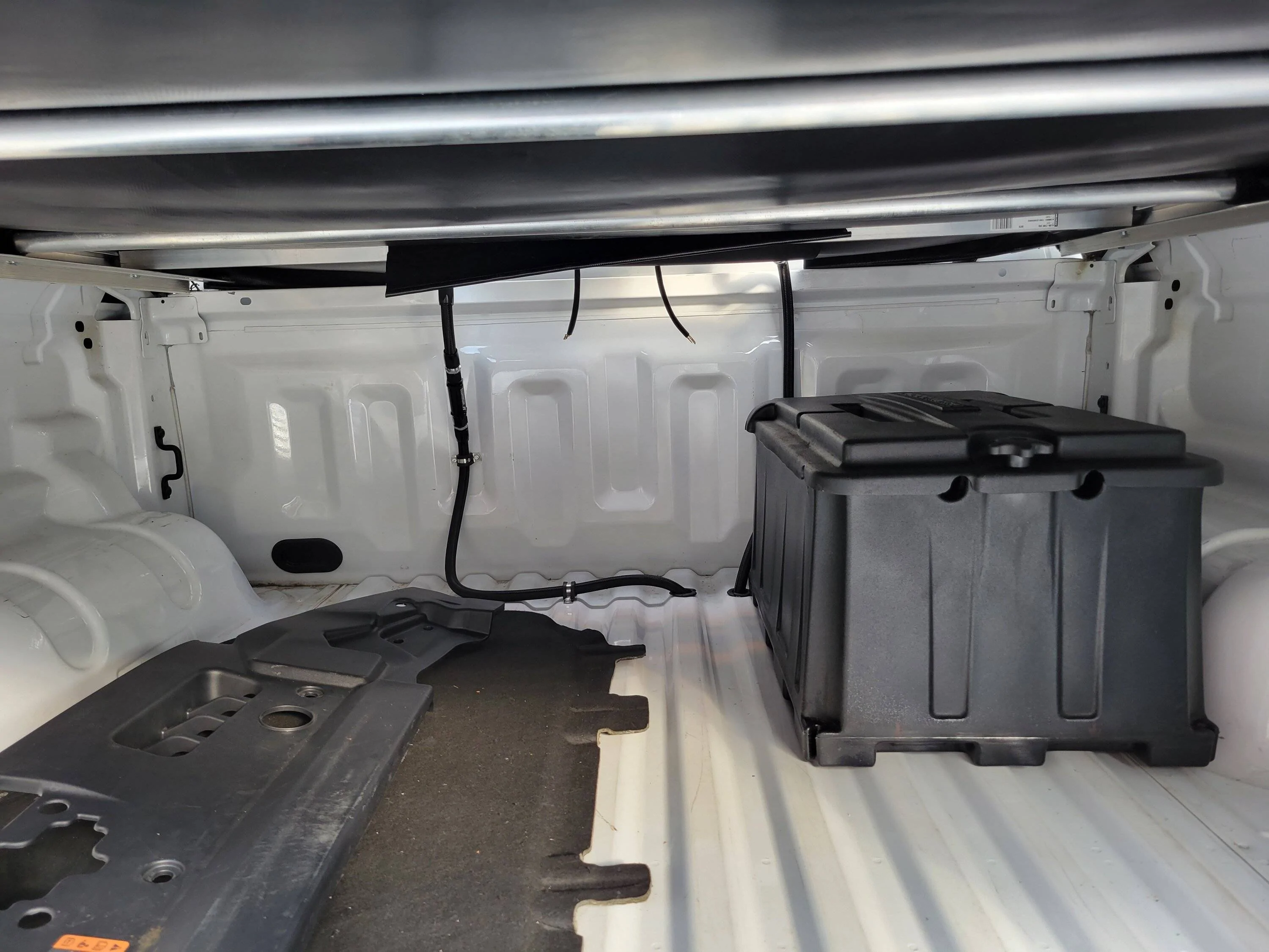

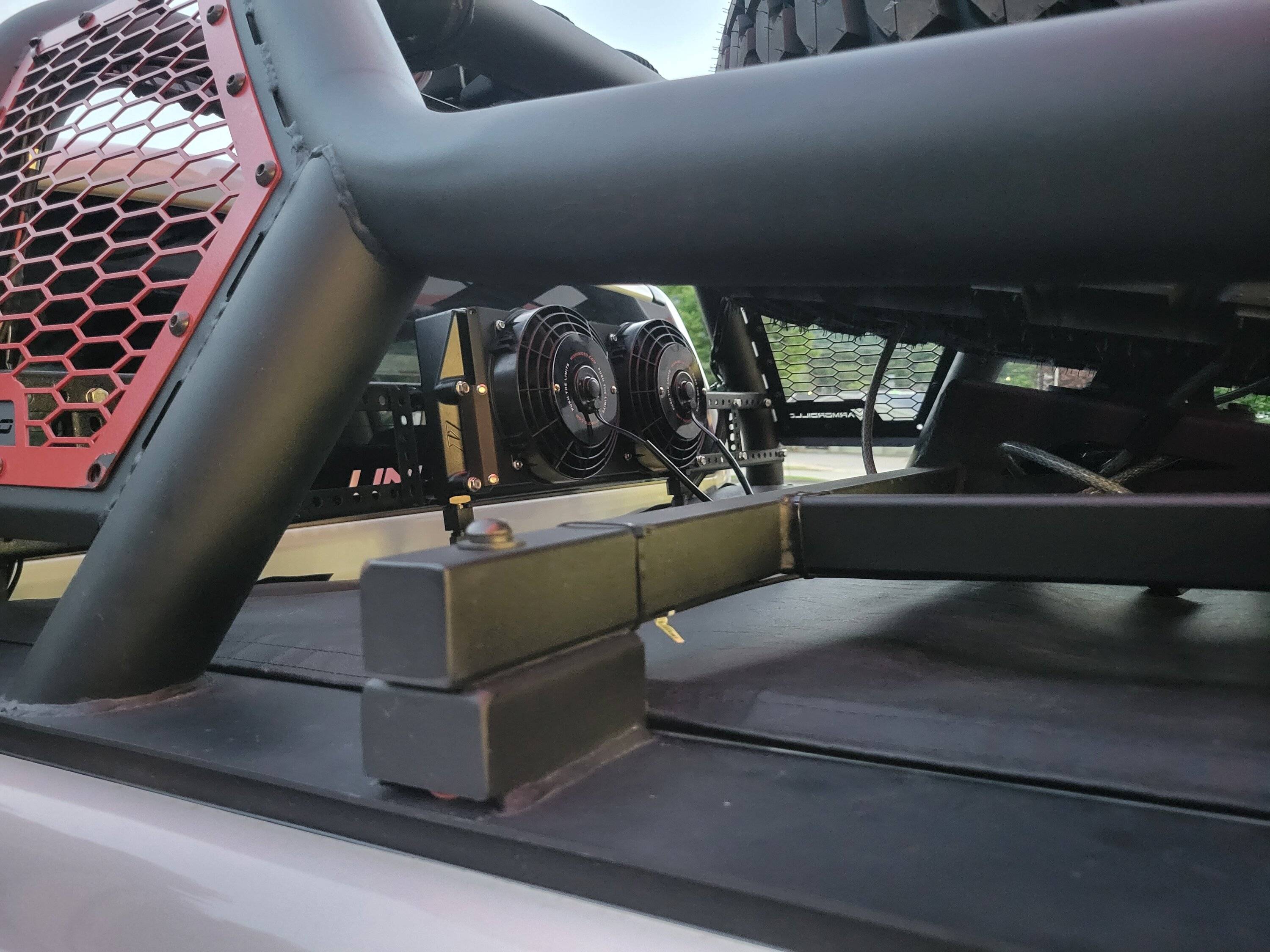

The way I did it was built my own kit. The 10r80 in our rangers is basically the same as the raptor and mustang. Ours uses a heat exchanger that in my opinion is not efficient and will always stay above 200. I removed the exchanger, rerouted the coolant hose that went to the exchanger. Then installed the aftermarket remote connector from a mustang kit, ran the hoses to the bed of the truck, installed a fan temp controller, extra in line trans filter and tied it together with the mishimoto 2 qt cooler and dual fans. Between the 30 ft of trans line added and cooler. I increased fluid by 3 qts over factory. Added a metal pan but not the deep pan. Temps now stay at 165 - 180 on a 70 degree day. If you go crazy it will hit 185 for 3 mins till the fans kick on. They do offer pre made kits for the 10r80 as well but still require rerouting coolant and placing a transmission cooler somewhere.

Sir you are my hero. Seriously thank you so much. I now know that what I originally had planned will work. What adapter did you go with?

Here is the link. I used their fan temp controller as well. Used mishimoto transmission lines and made them with the an fittings. Used some math for the trans lines since they were so long. 30 feet came to 3/4 qts added fluid. I will say that the heat exchanger is a massive pain to remove. Either the shift has to drop or you have to cut the one long flange off. I cut it with a cutting wheel.

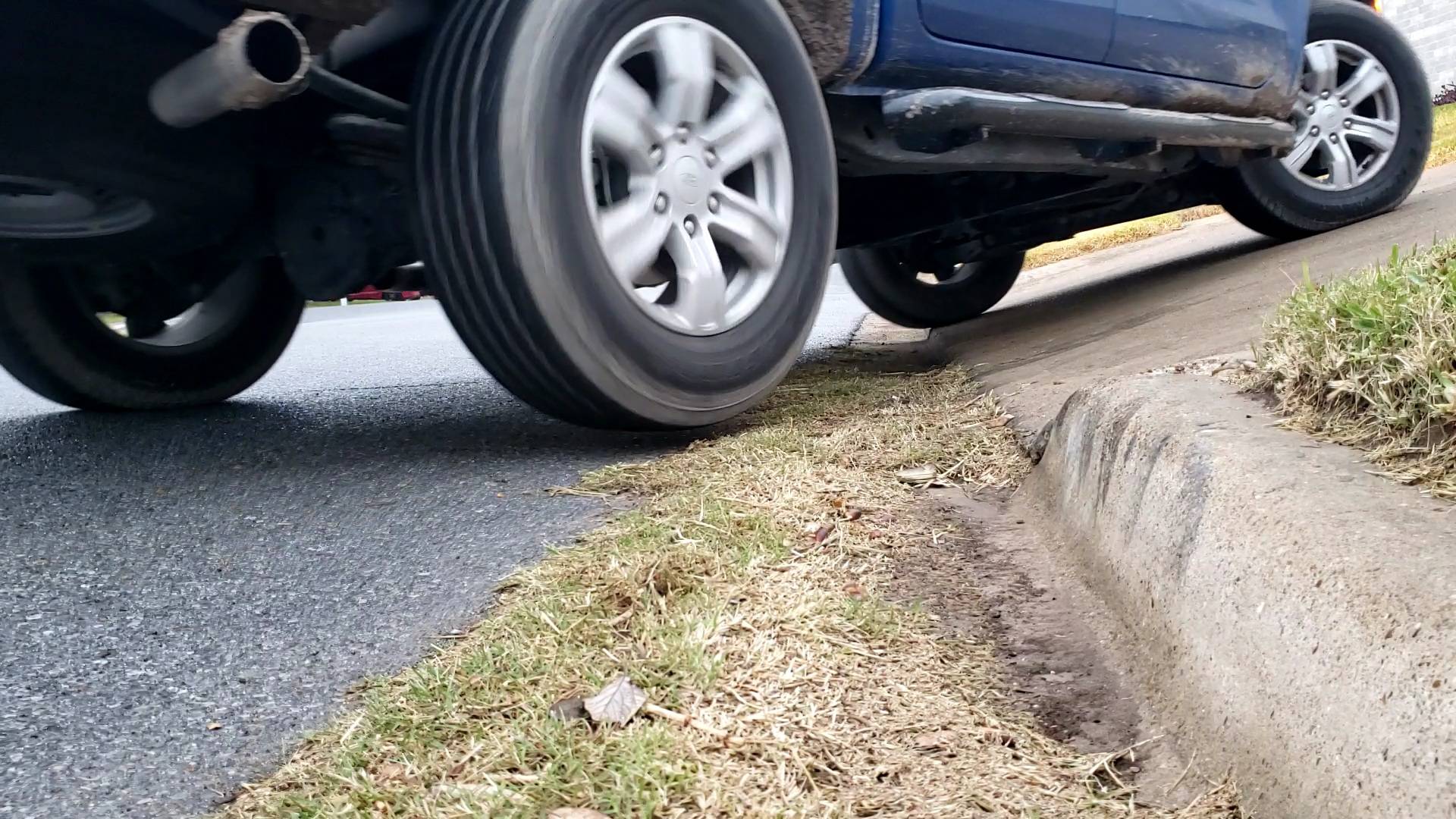

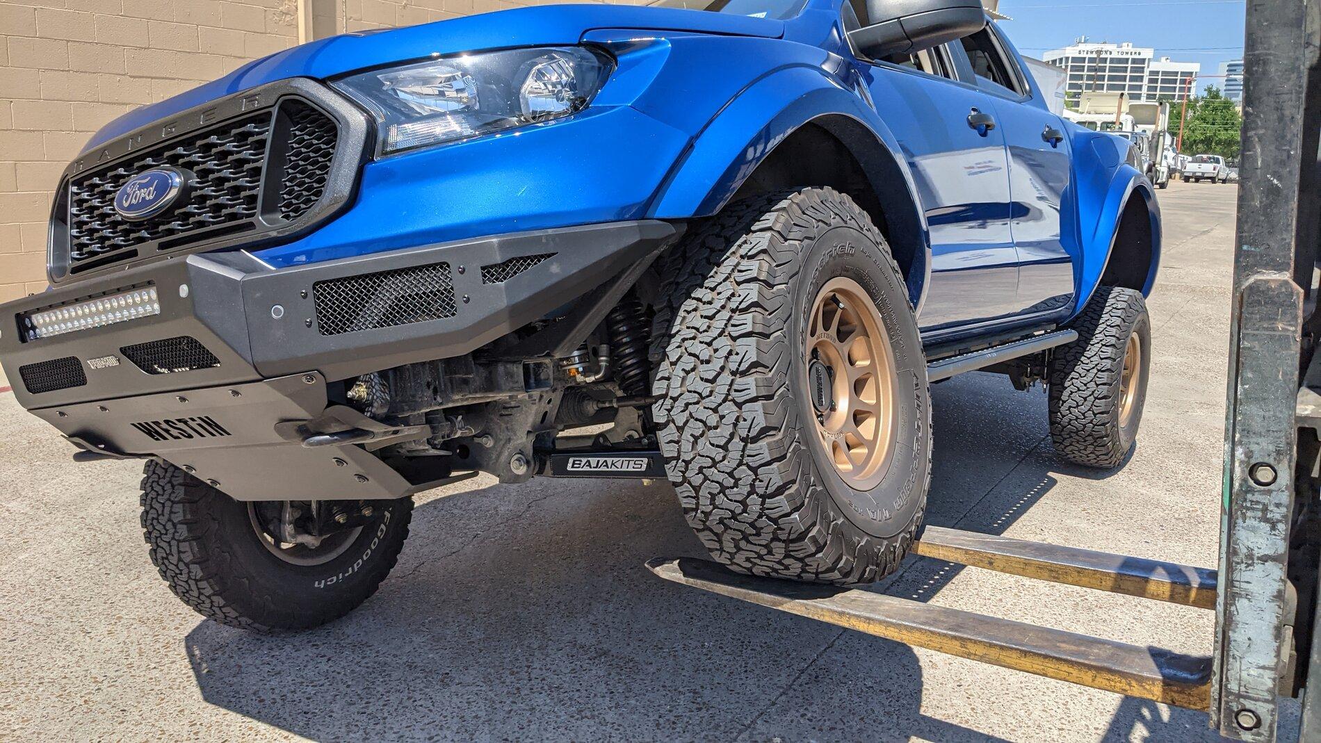

I just want to drop these photos here.
is this when you had the ext travel or before?
flex isnt to bad the thing that makes me sad is the rangers geometry just seems to be lacking to get lots of flex like other mid size trucks

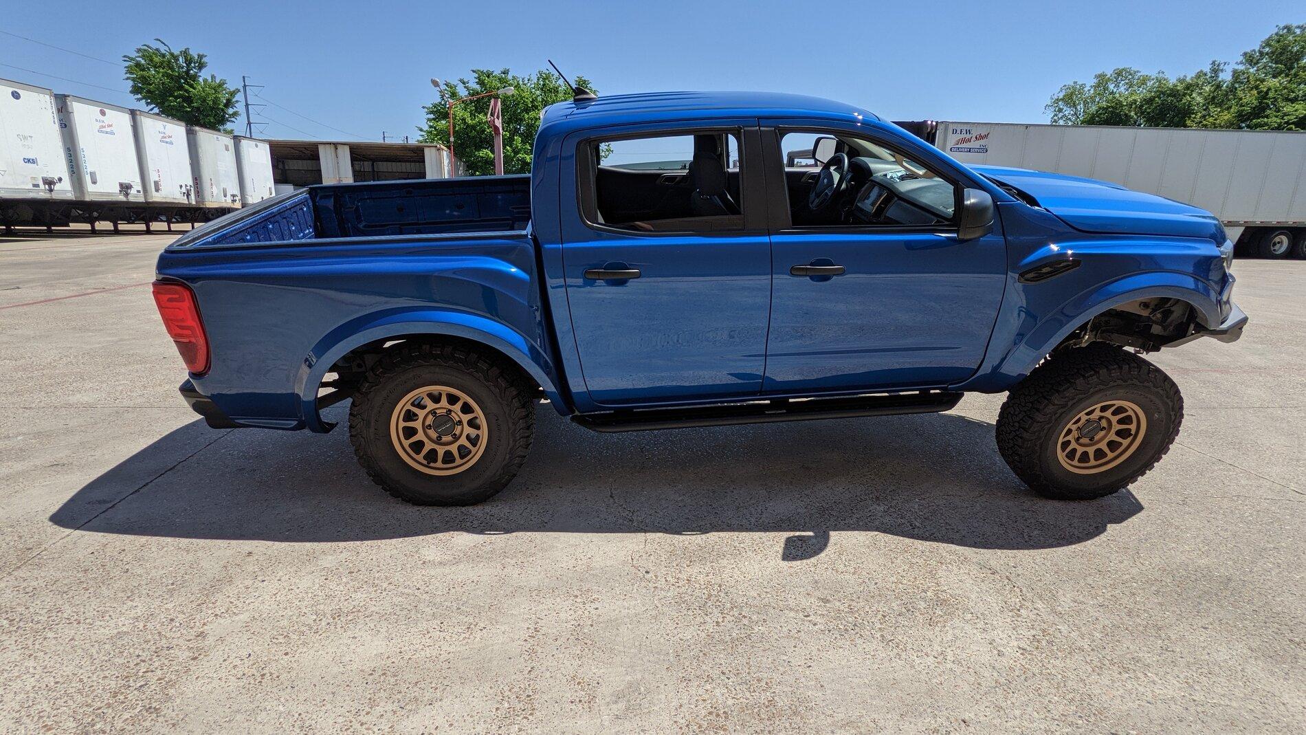

This is the same setup I have now minus the 3" rear billet adapters.
Bajakits arms, icon 2.5 ext travel coilovers
Deaver springs, icon 2.5 piggybacks

gotcha gotcha i was wonderin haha
