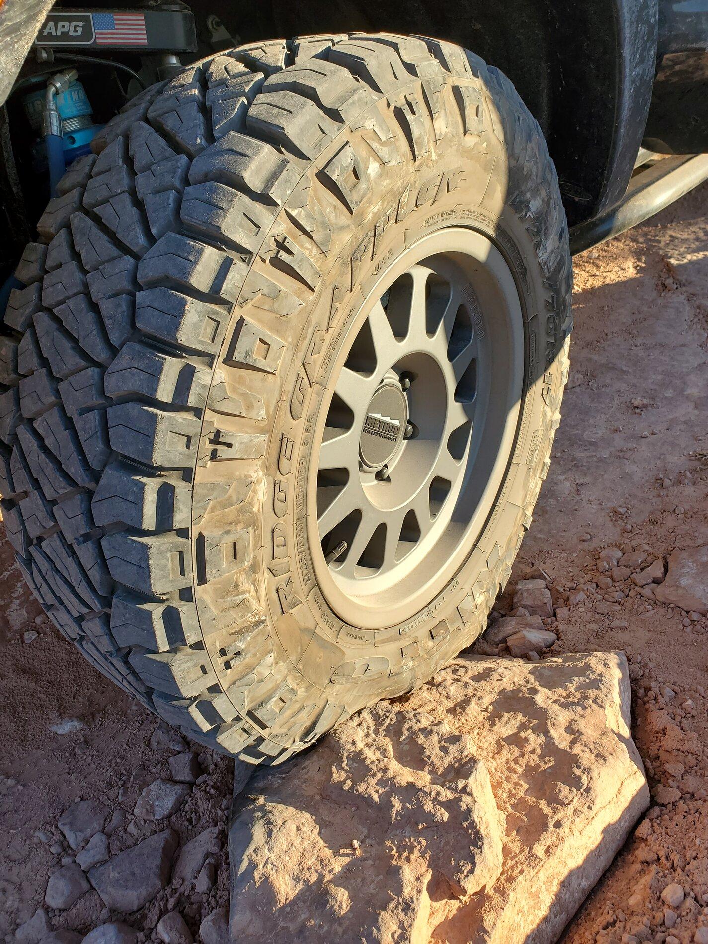

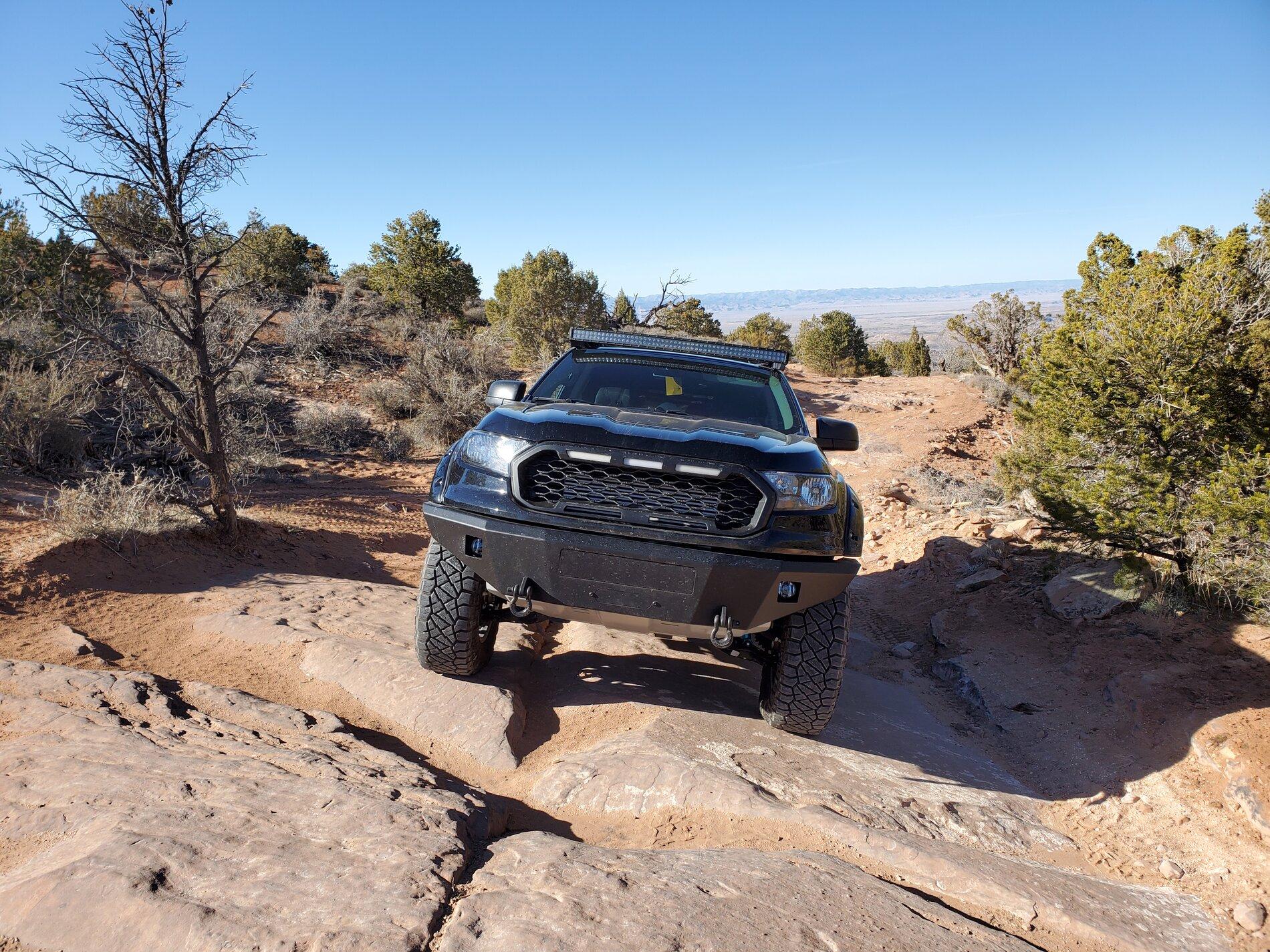

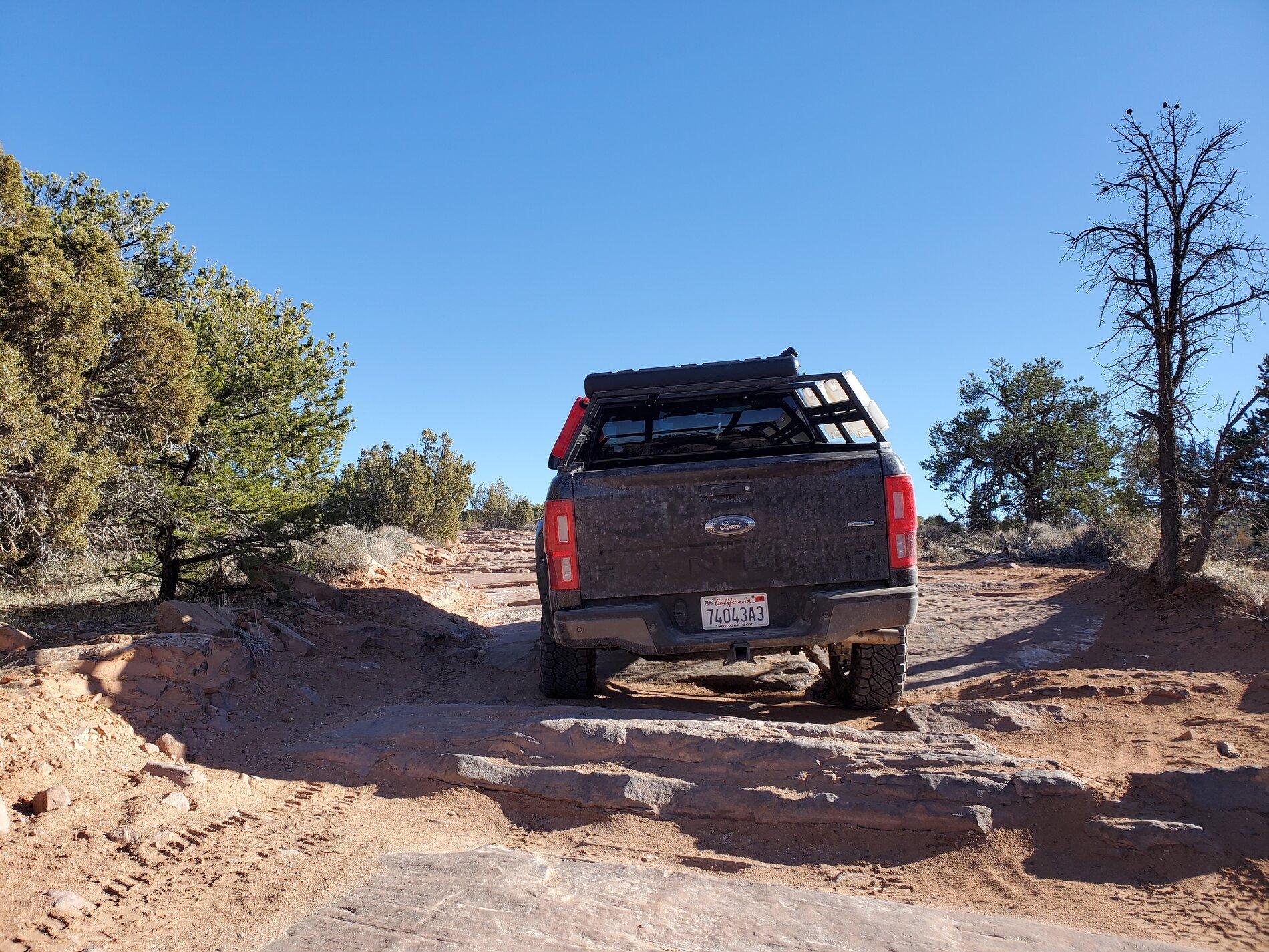

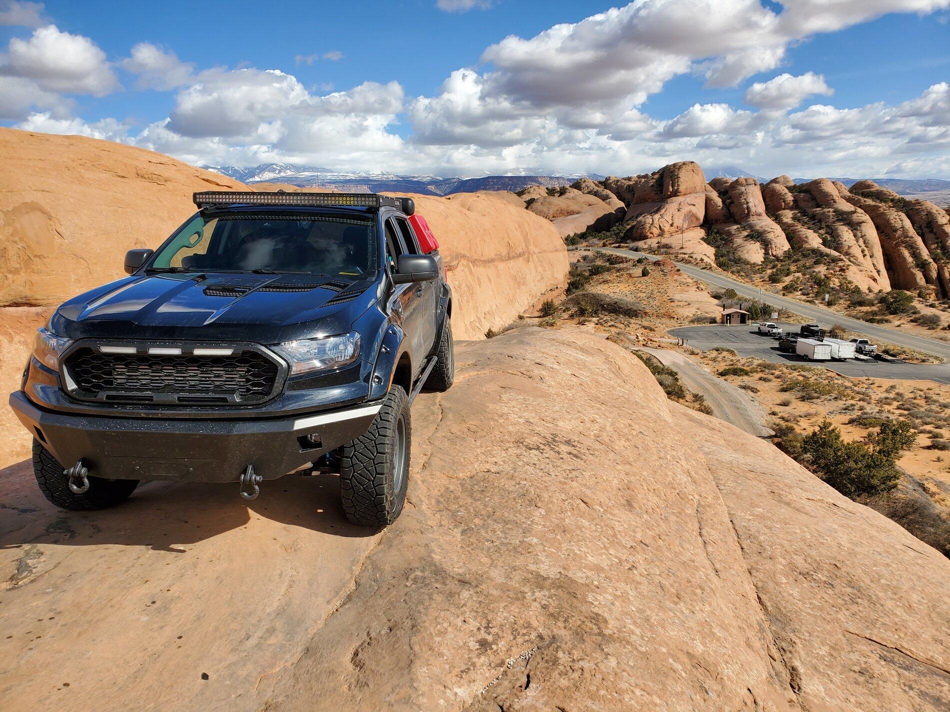

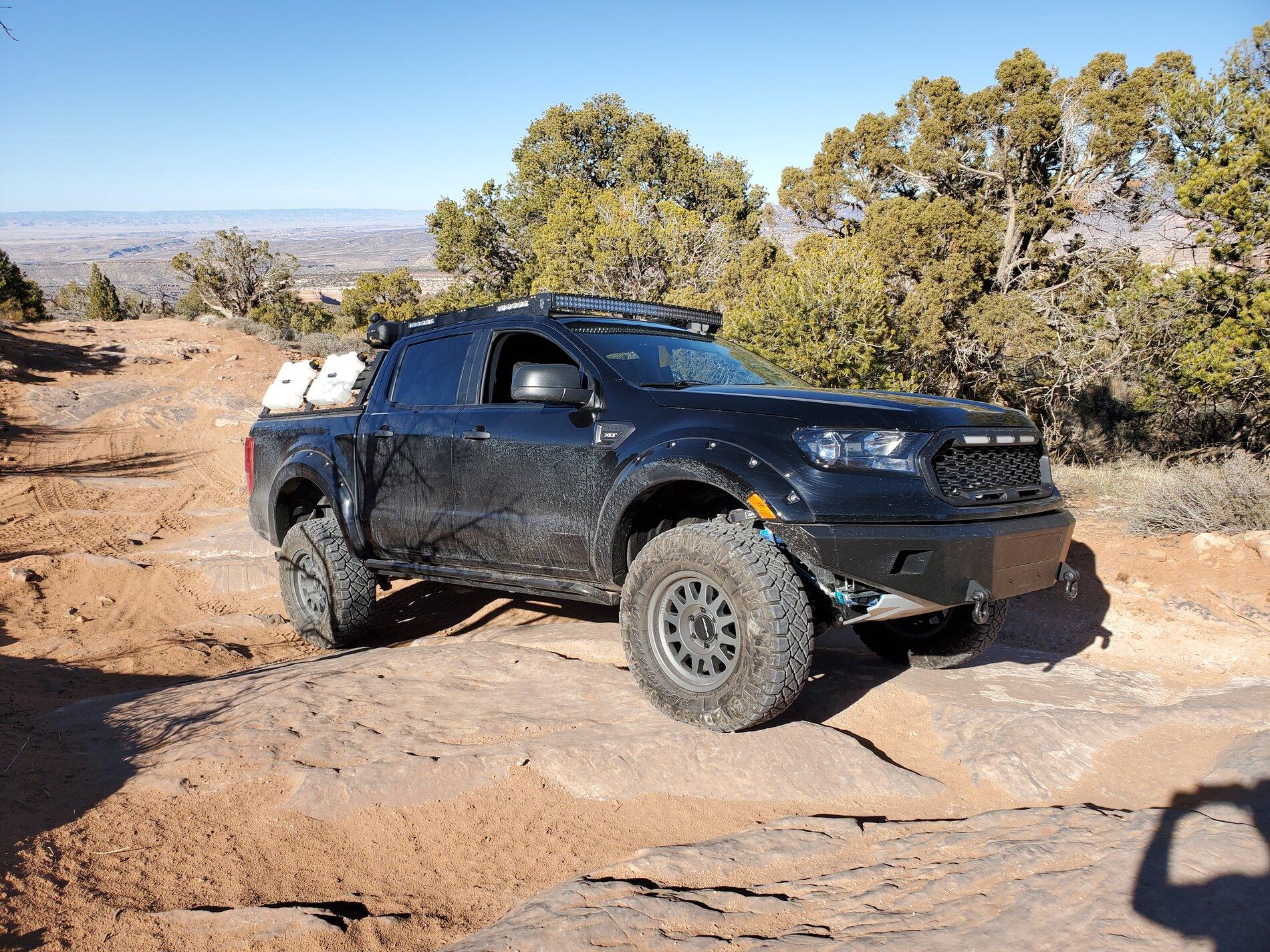

33" tires. King shocks. (Just leveled in the front.) APG/Deaver HD leaf springs. The rest you can see. But one of the best mods is the bumper... So much clearance; no scraping on all the spots you see marks on the trail. Has limits for sure but goes pretty far.
My recommendation for light crawling:
Good tires.
Good shocks.
Skid plates.
Rock rails- but still haven't really used them.
High clearance bumper!
Lift it too high and you will just roll it later.
Good luck on your build, have fun and stay safe. Know your (truck) limits.. although when you surpass it you will know....

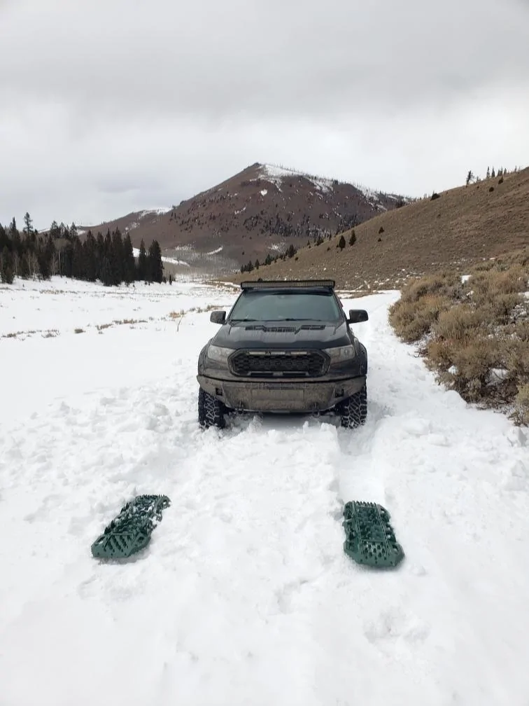

See snow pic attached. Didn't realize how deep the snow was (1.5') and was ice packed. 2 hours to dig truck out with wife and kids in the middle of nowhere and had to hot dog it back out the way we came to do plan B. I know how to drive in the snow but the truck, diff, everything was high centered. Give and take of speed and going off the edge into deeper snow. Was flooring it on the way back though to not get stuck.
