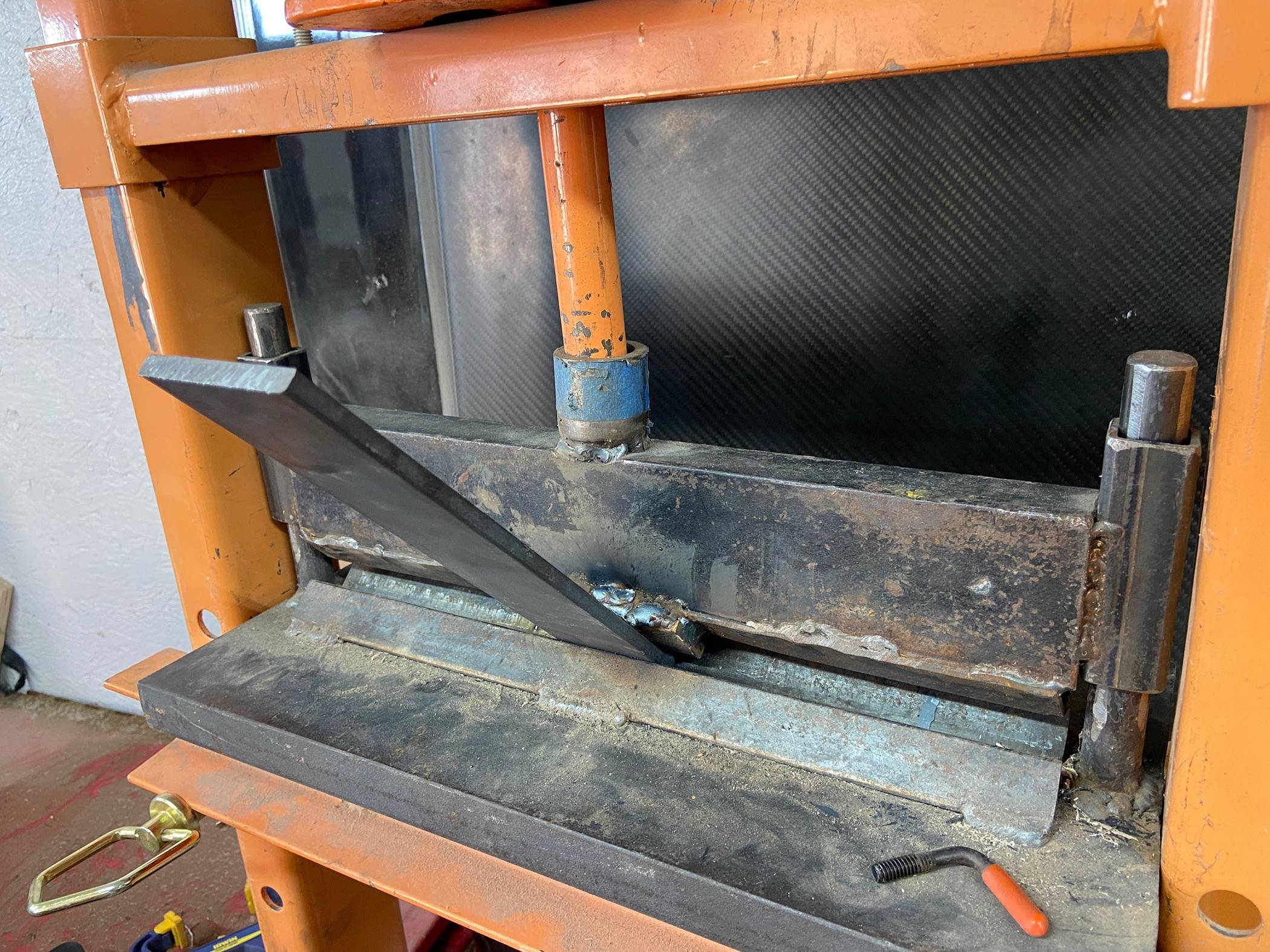

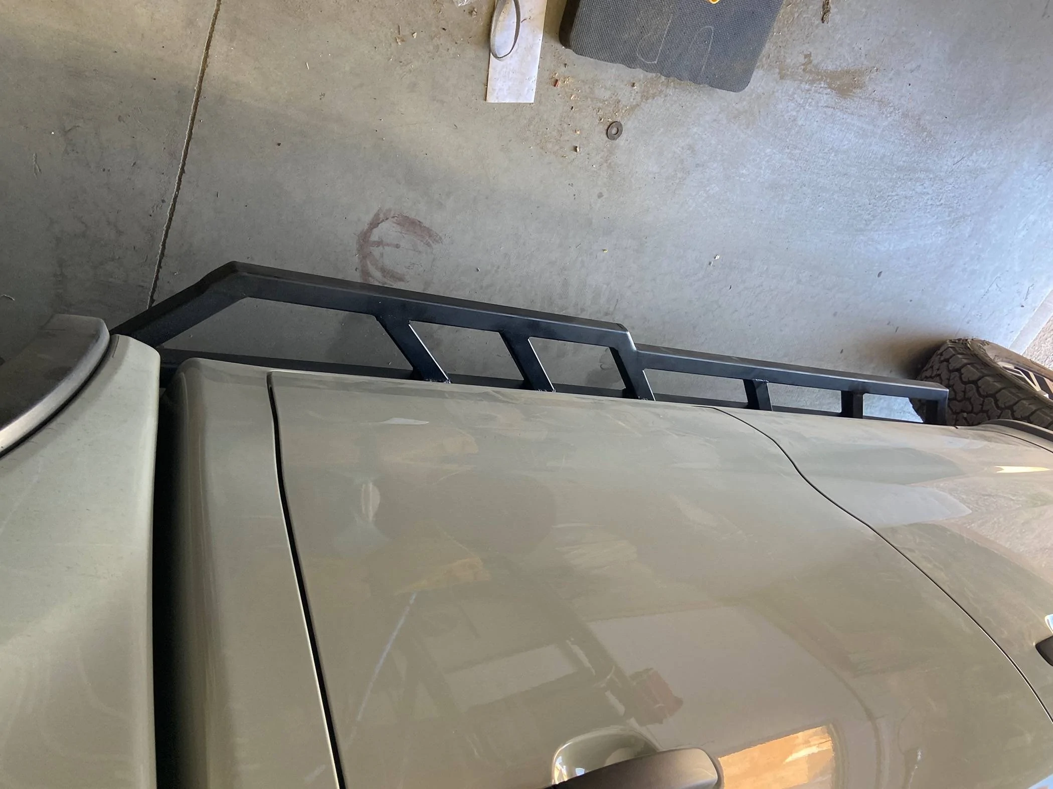

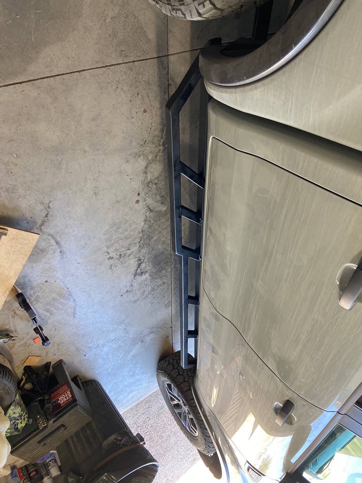

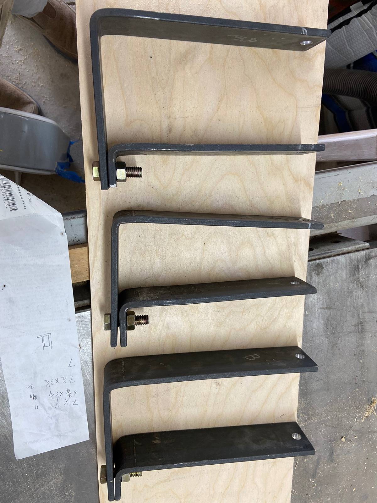

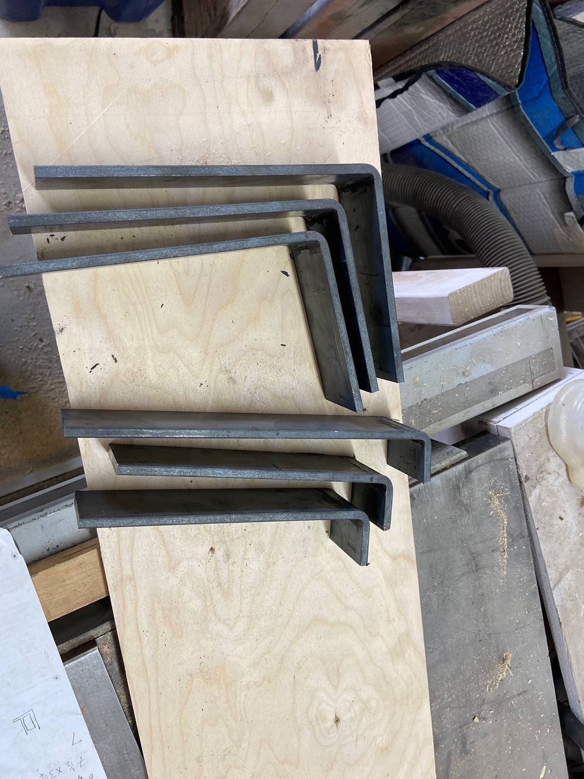

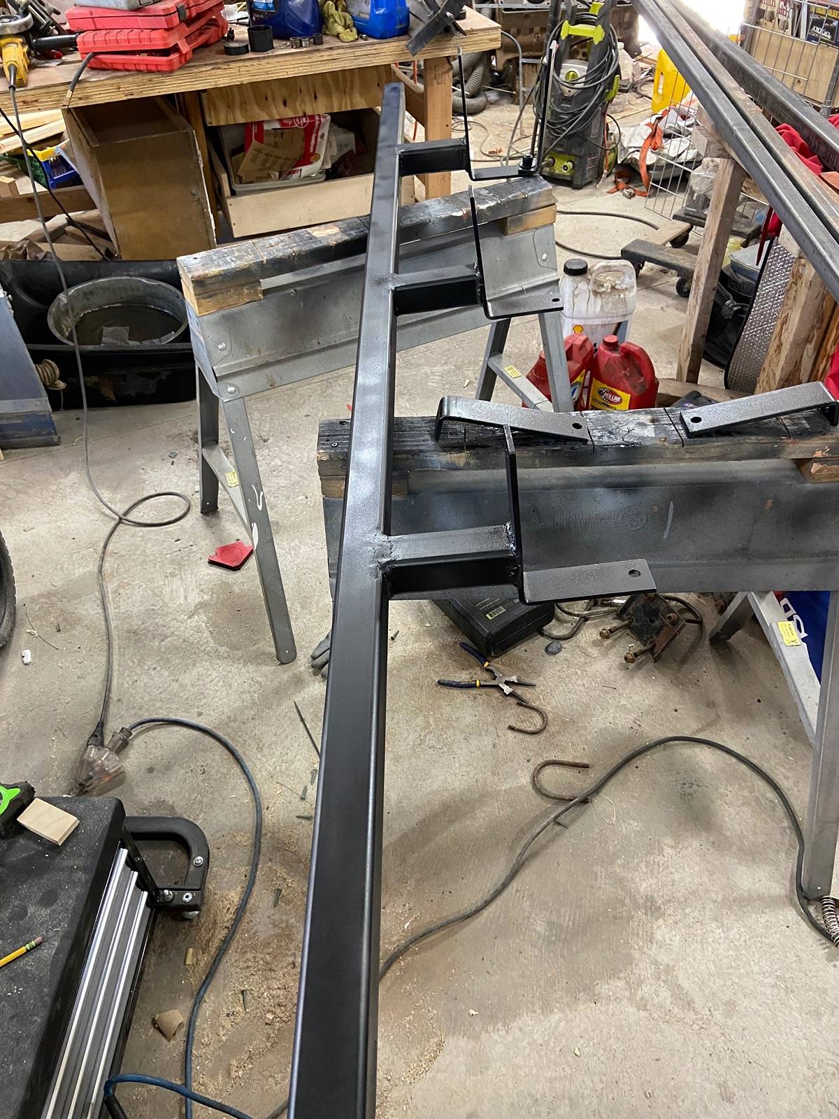

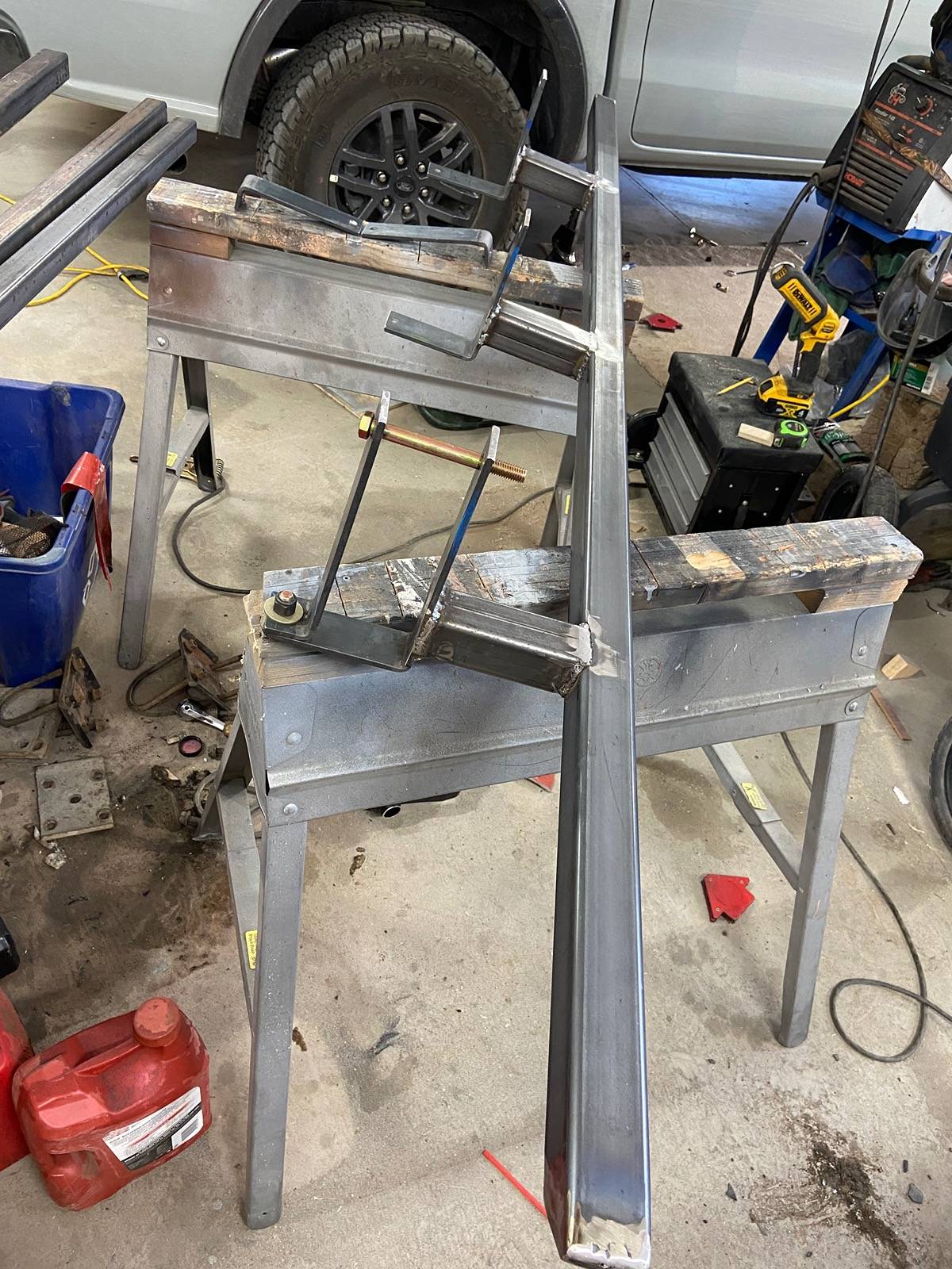

I built a set of frame mounted rock sliders to my 2023 Tremor.
I did not want to drill or weld to my frame.
I also did not want them mounted to the rocker panels like the factory ones.
Here is what I built.

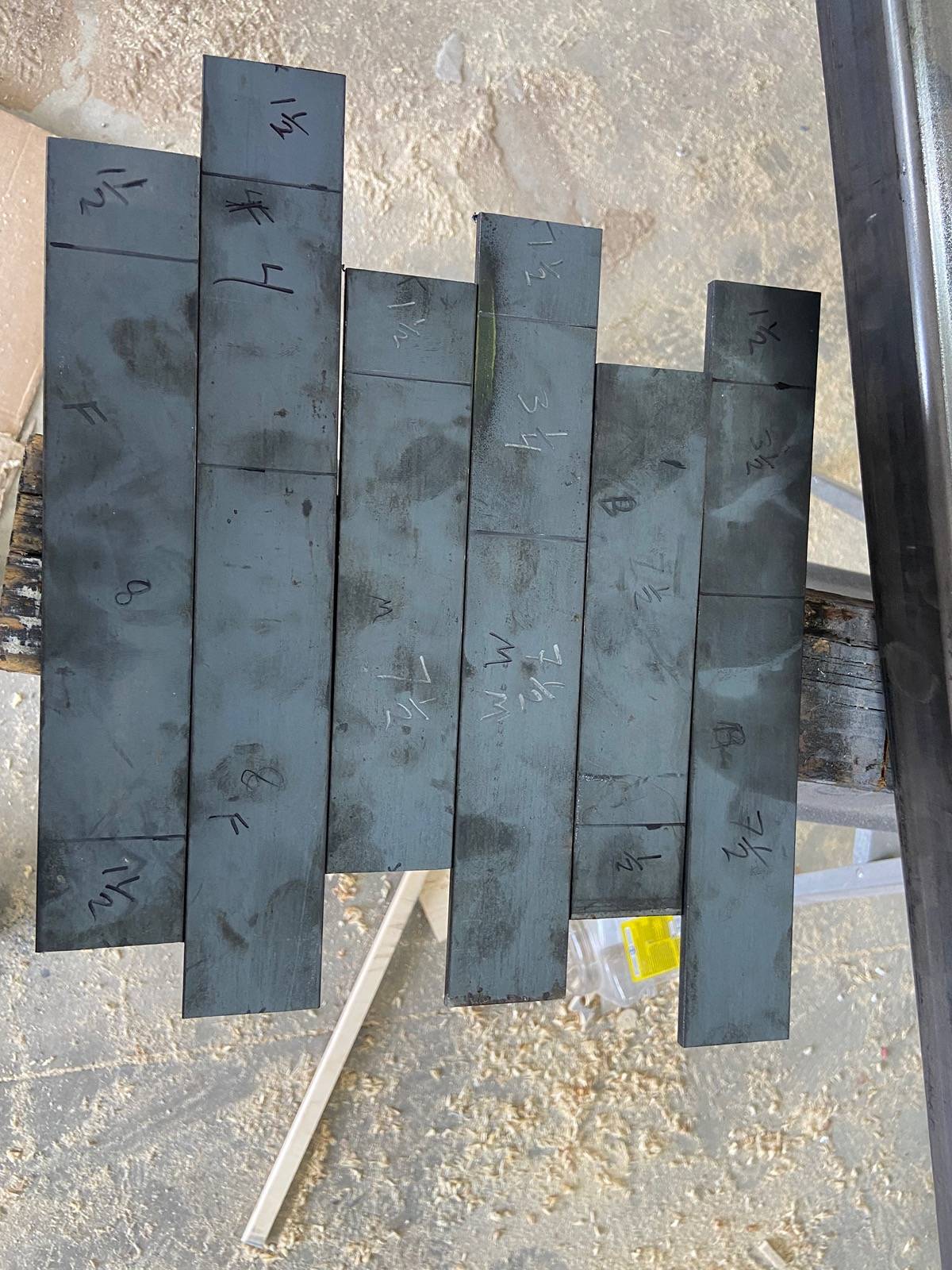

Started off with some bar stock
