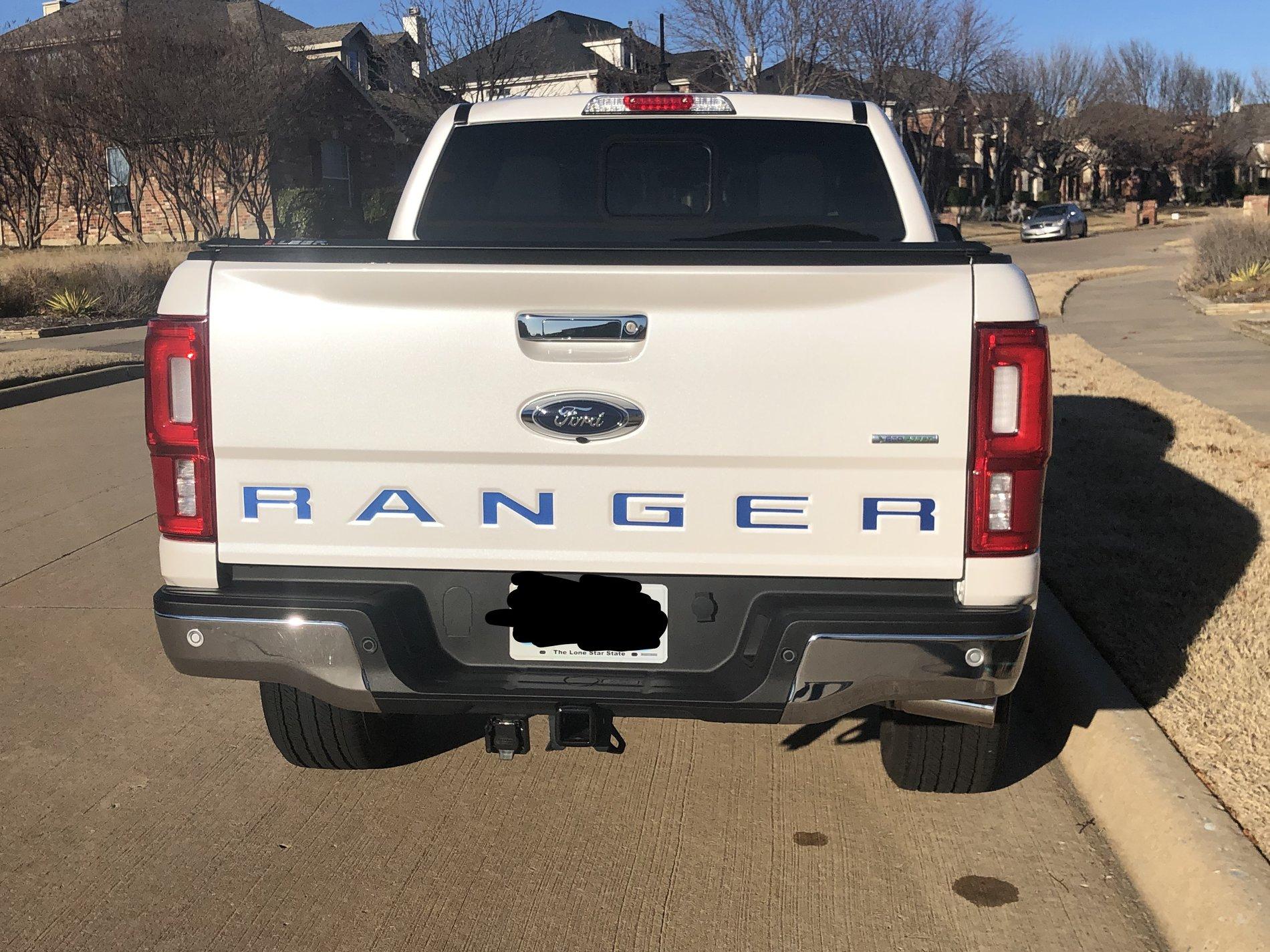

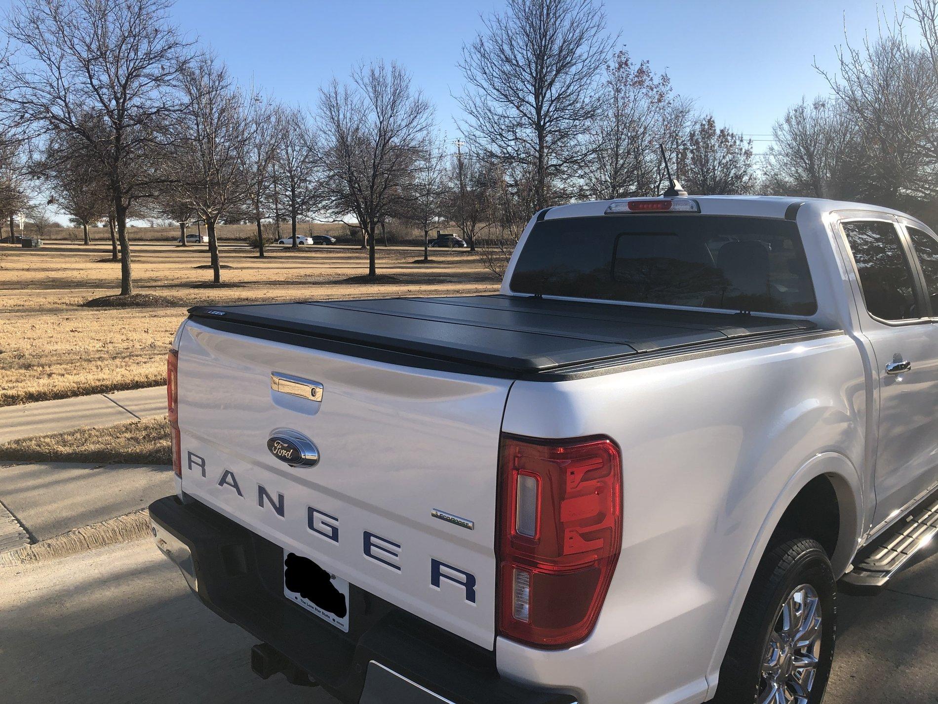

Here's the photos of the Leer HF350M. I also added a little bling with the metallic blue vinyl tailgate and front grille letters. I just washed it and waxed it with the Meguirs Hybrid Ceramic wax. This is the 3rd coat since I bought it in March.

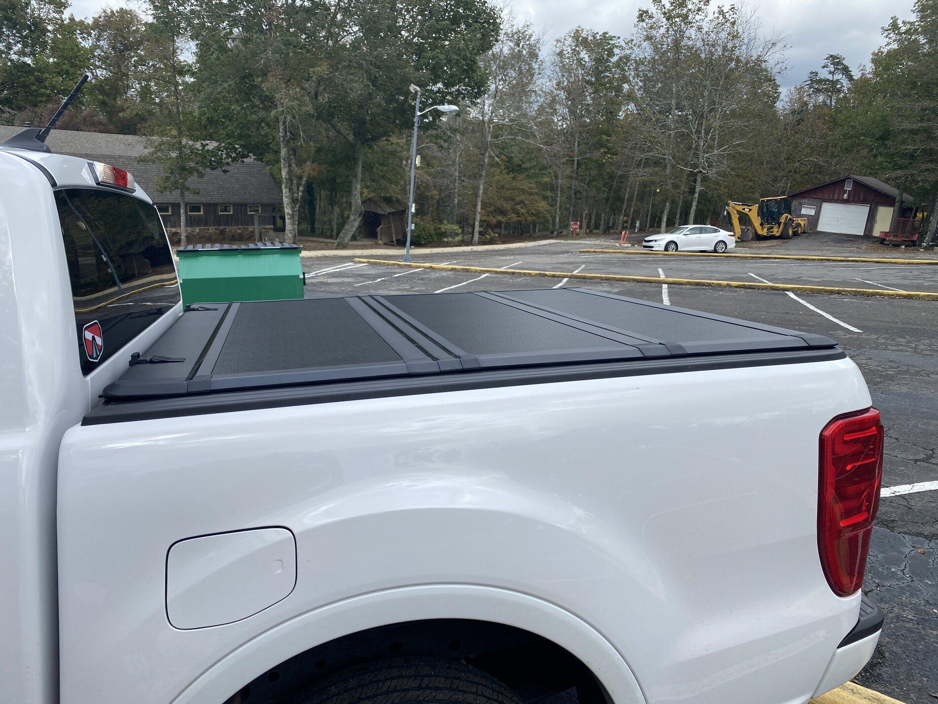

I'm still fighting with the fitment of this stupid cover the instructions are terrible they don't have any measurements of how far to mount the rails and where the cover should be in relation to the bed. dont have any description of where to use the butyl tape, dont tell you how to apply the toyota foam seal; I've already broken one prop rod lock. the front of the rail has a slight lip upwards which is causing the cover to not sit flat, at the front. you can hear the seal flapping at 65-70 MPH and its very annoying, Anyone who's installed this thing and has gotten the front to sit flat and you take a picture of the rails at the tailgate and where you mounted the cover in relation to the bulkhead I either need to move my rails back or the cover forward or both. I am about ready to pitch this thing for a solid one piece.
Thanks,
Jay
Jay, Were you able to solve the seal flapping issue? I have the same problem on the highway at 65-70mph. Quite annoying.
I tried to stick the outside corners of the seal with some of the butyl, but tht didn't work.
JaysOnTheEDGE
Jay
Oct 17, 2019
806
1,492
Office Equipment Technician
Steve,
I was able to solve it by using 3M double sided trim and molding tape. the gray stuff with the red backing i bought a roll of it and ran it the entire length of the seal and stuck it to the outside of the bed. just wipe down the seal and bed paint with alcohol to remove any dirt and after you stick it wedge some foam or something in between the bed and cab to put something to pressure on it so it sticks better.

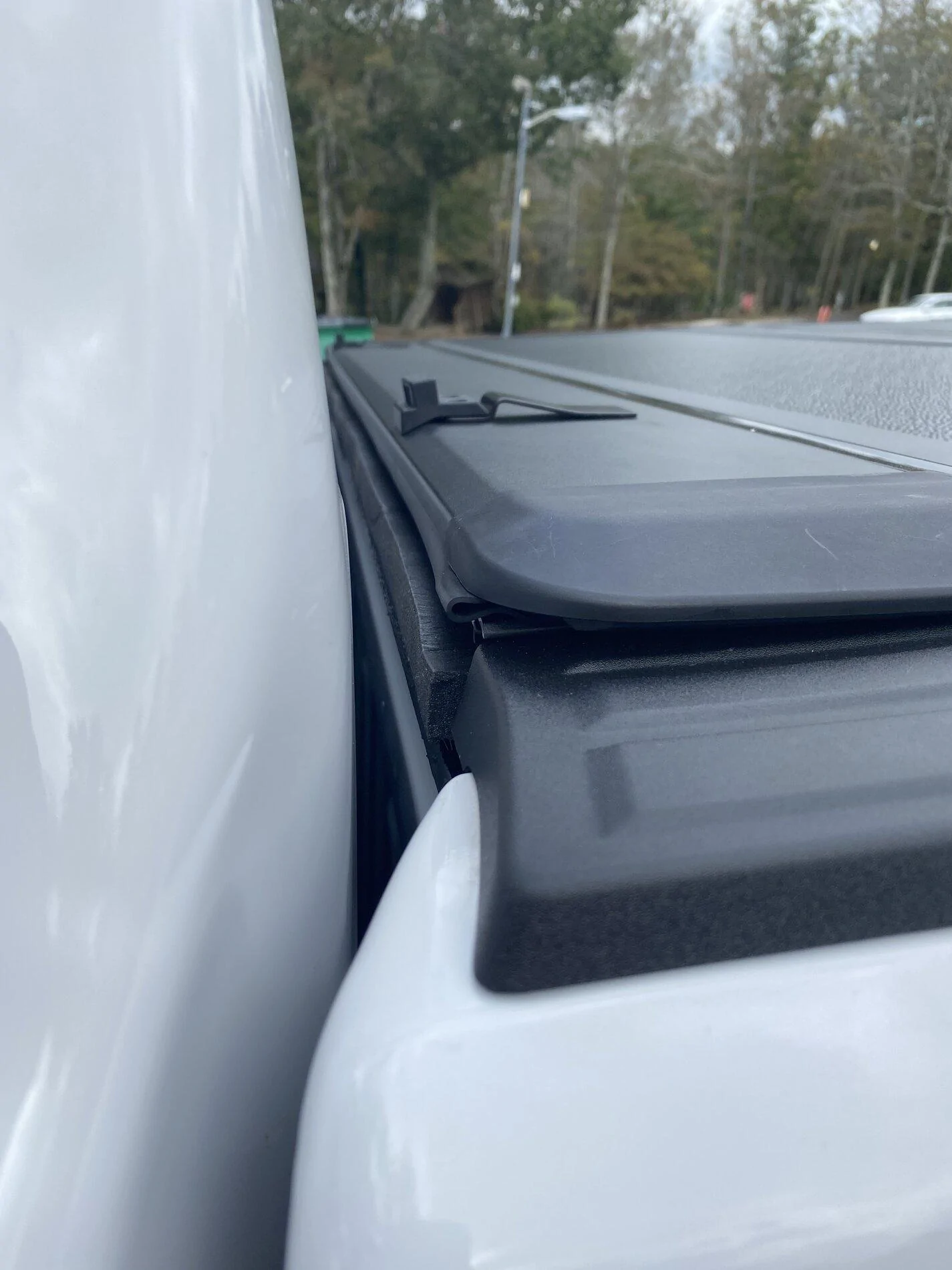

Just got my cover installed today. I love it. Looks great. I’m not so sure the front edge was done correctly though, isn’t a piece of rubber supposed to covering the foam?
HarryD
Sep 3, 2019
197
129
Western MA
2020 Ranger 4X4 SuperCrew Magnetic Lariat Sport
If you go to SN13's original posting of his install, toward the end of the installation photos you will see how the rubber strip is supposed to overhang the foam filler strip.

Hey everyone!
Yes, the rubber should cover the foam.
Also, if I were installing this again, the only thing I would change is I'd likely stick the foam TO the rubber flap, and then JAM it into the crack.
The only long term downside I've had after a year of use is that the rubber flap sometimes flaps in the wind and makes a "flick flick flick flick" sound. I solved this mostly using the black butyl tape that came with the install that I had no idea what to do with... I just put pieces down the foam/rubber strip and that took care of it 99%.

I have this tonneau and like to very much.
I bought a sheet of 3/4” thick neoprene closed cell foam, and cut one piece 1-1/2” wide to slide in between the rubber flap and the cab to secure the flap as well as filling the gap to keep debris out.
I also cut a piece of the neoprene 1-3/8” wide to replace the open cell (sponge) foam filler piece at the top of the front bulkhead panel.
