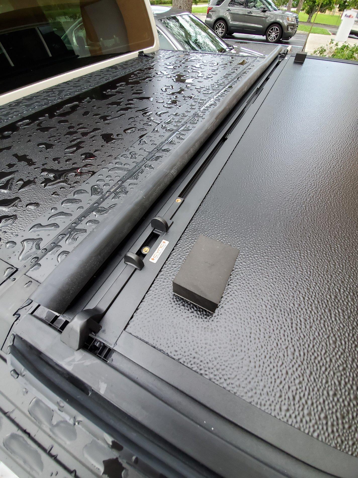

I'm still fighting with the fitment of this stupid cover the instructions are terrible they don't have any measurements of how far to mount the rails and where the cover should be in relation to the bed. dont have any description of where to use the butyl tape, dont tell you how to apply the toyota foam seal; I've already broken one prop rod lock. the front of the rail has a slight lip upwards which is causing the cover to not sit flat, at the front. you can hear the seal flapping at 65-70 MPH and its very annoying, Anyone who's installed this thing and has gotten the front to sit flat and you take a picture of the rails at the tailgate and where you mounted the cover in relation to the bulkhead I either need to move my rails back or the cover forward or both. I am about ready to pitch this thing for a solid one piece.

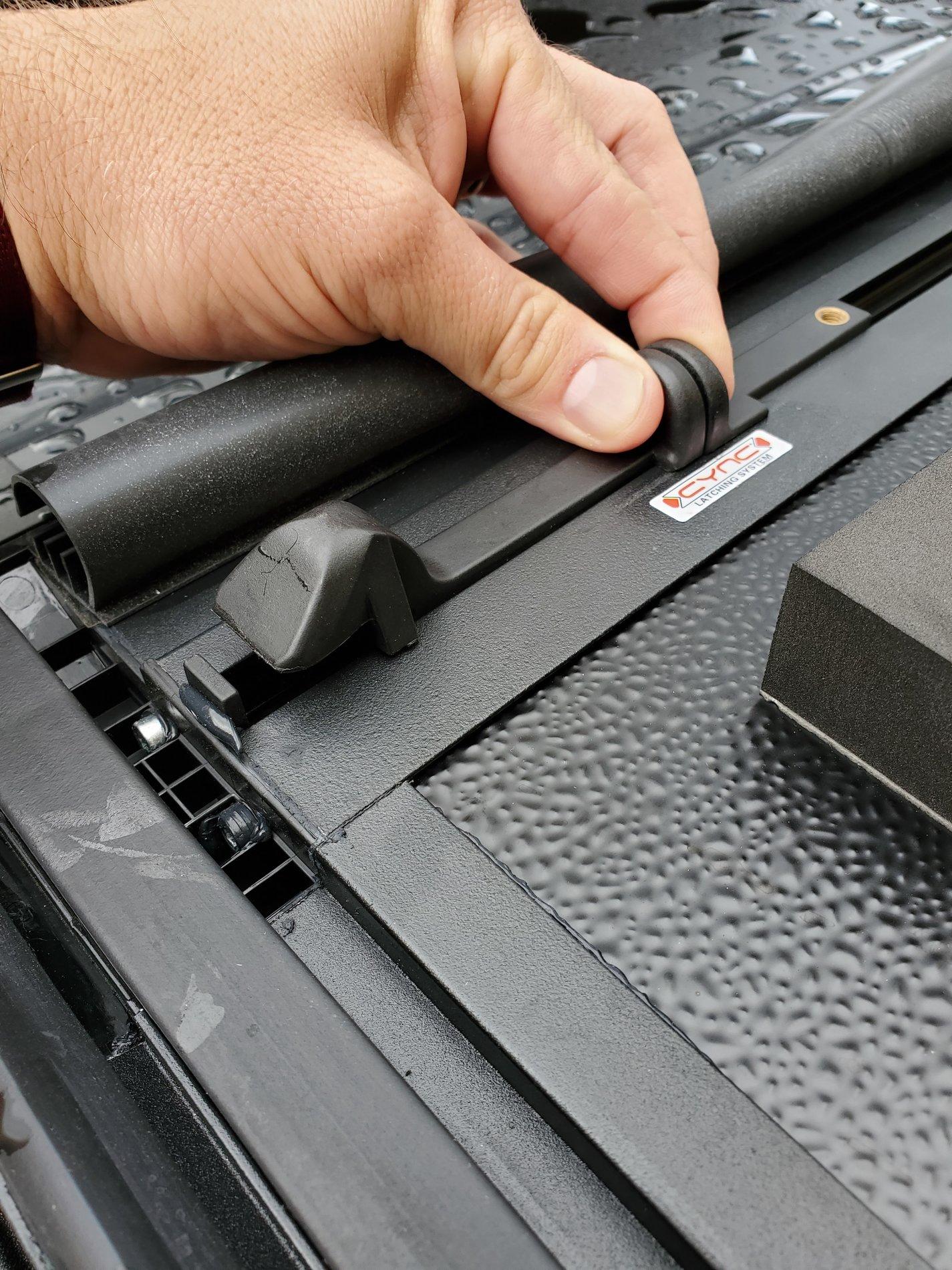

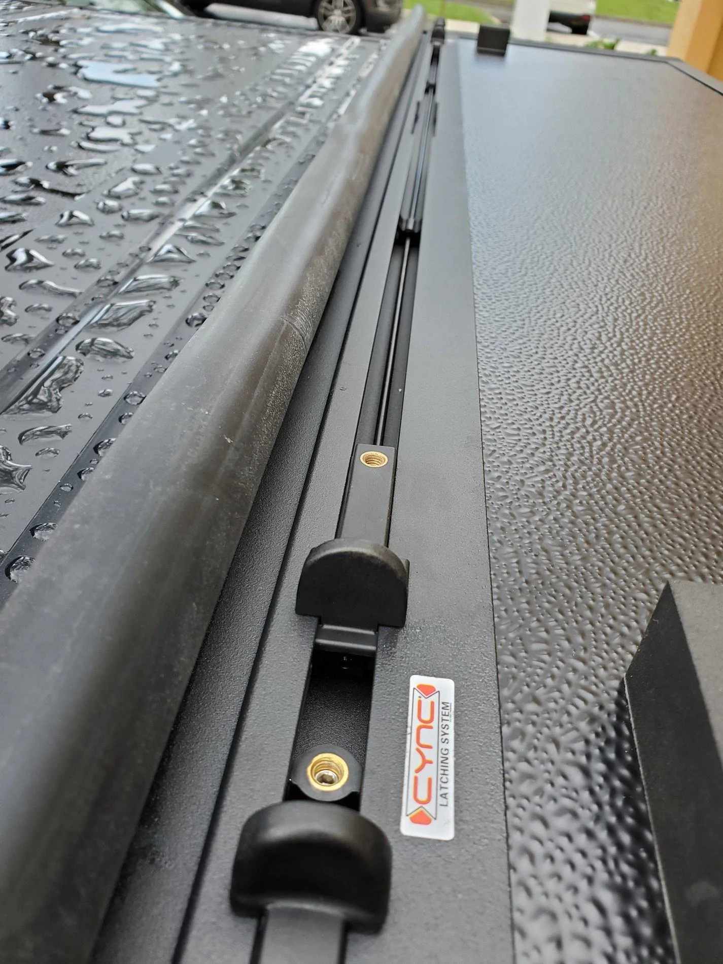

This cover looks very similar to the Undercover Ultra Flex. You mentioned something about the cable actuated latches not being as secured. I haven't seen a detail of how this cover is latched.
Also curious which covers you found that specify they can't be driven in the propped up position?
Sorry it took a while to get the photos of the latching mechanism.
Finally got around to it.

No problem! Those are great, detailed shots! I appreciate that! Definitely looks like it's a more secure latch setup than the dangling cord style of the other covers. :like:
