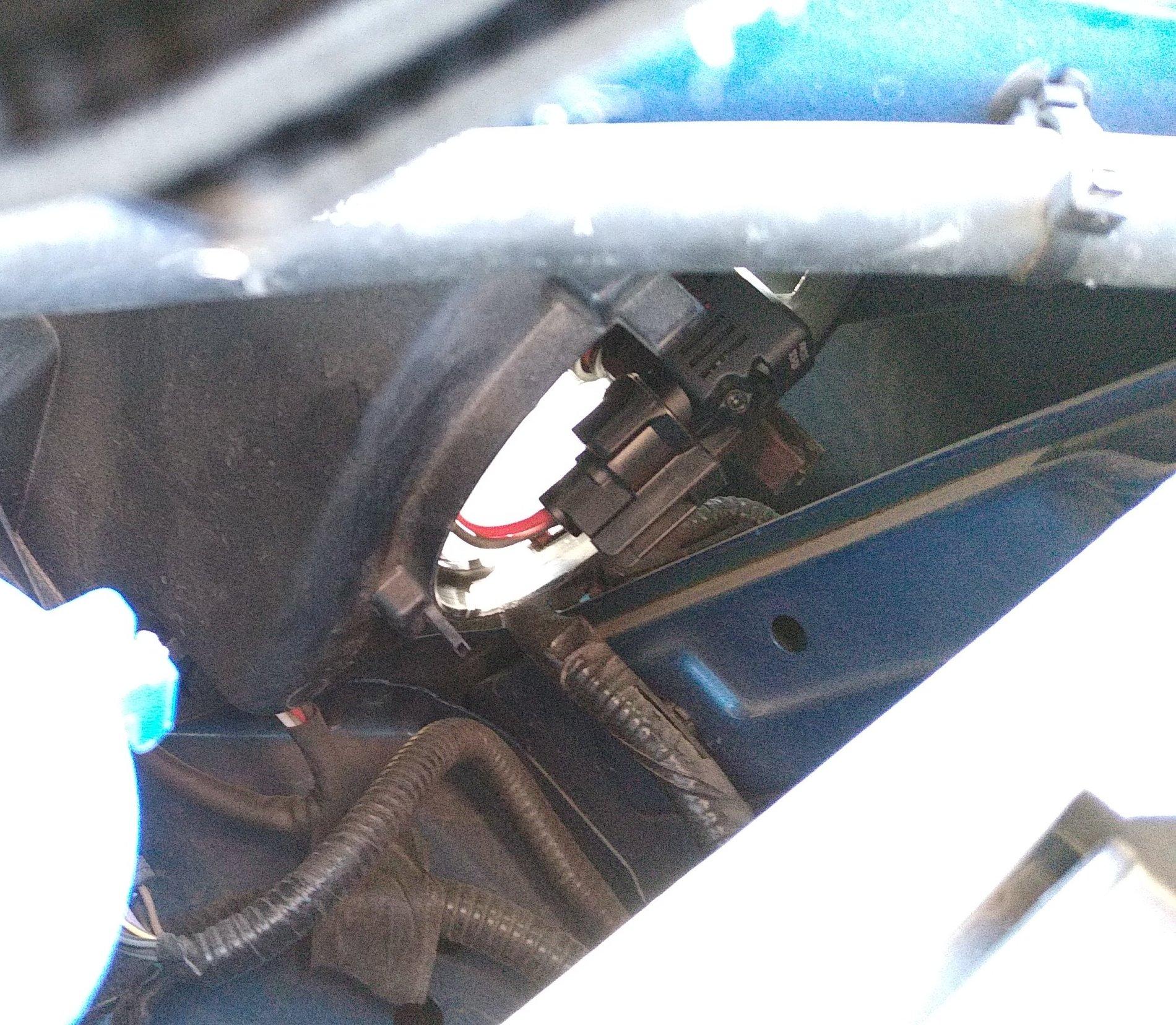

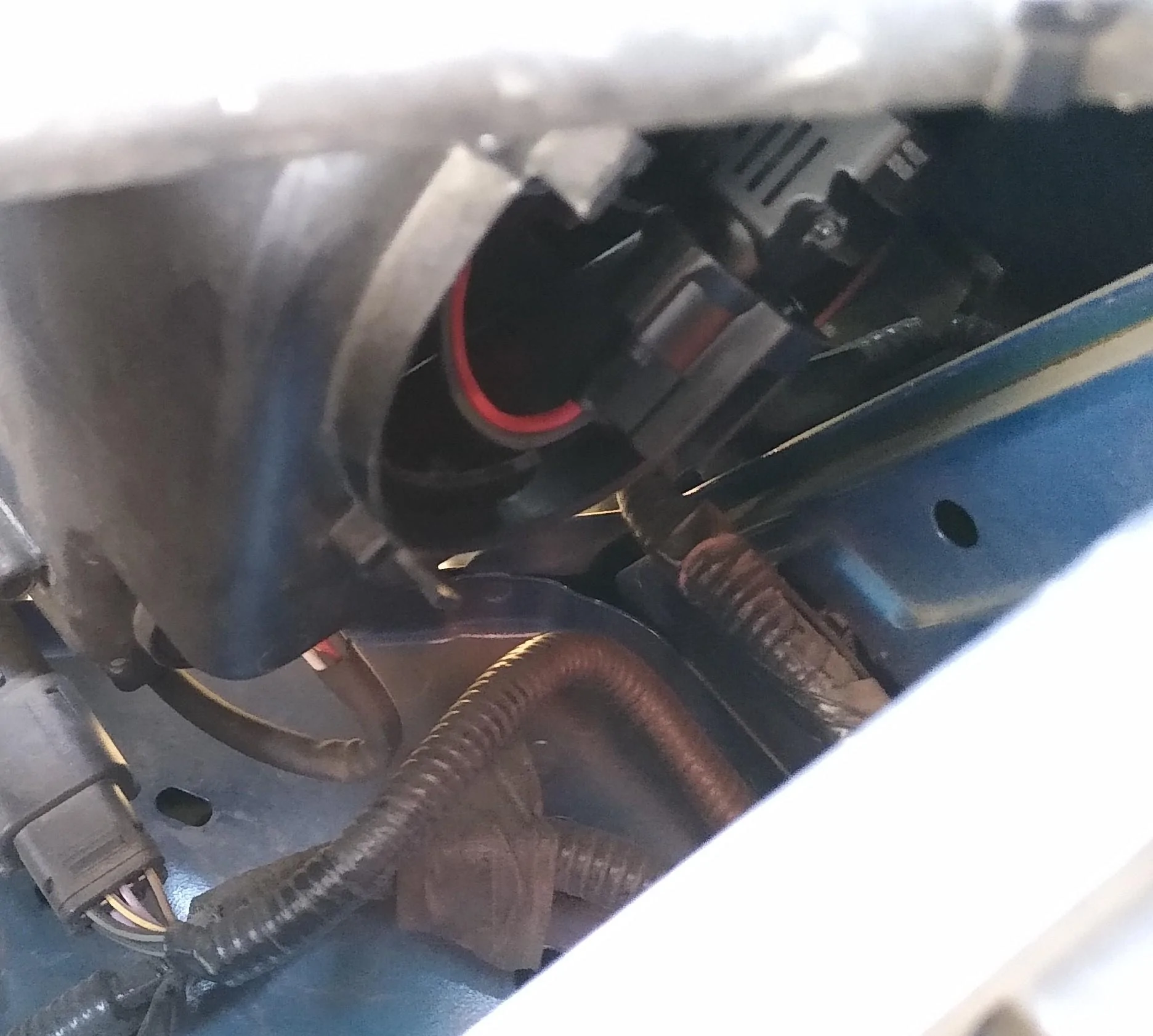

When you have some free time, could you take a picture of the back of your passenger bulb with the dust cap off so I can see where the wire harness lines up. Im trying to determine if theres something funky with my housing before ordering another set.

It's difficult to get a good shot but the connector on the bulb kinda sorta points to the wiring connector mounted on the headlamp assembly.

Thats perfect, thank you. I ordered those JDM's and they will be delivered today by 9p.m. so I should be able to give this another shot tonight.
in your picture, you were able to lock them in a bit more than I was the car rovers so hopefully this works.

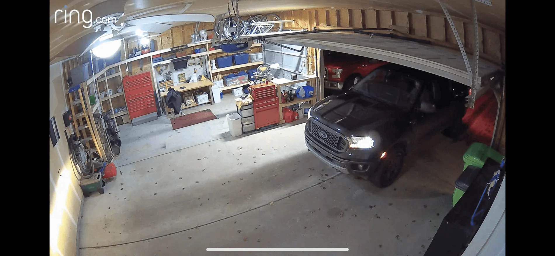

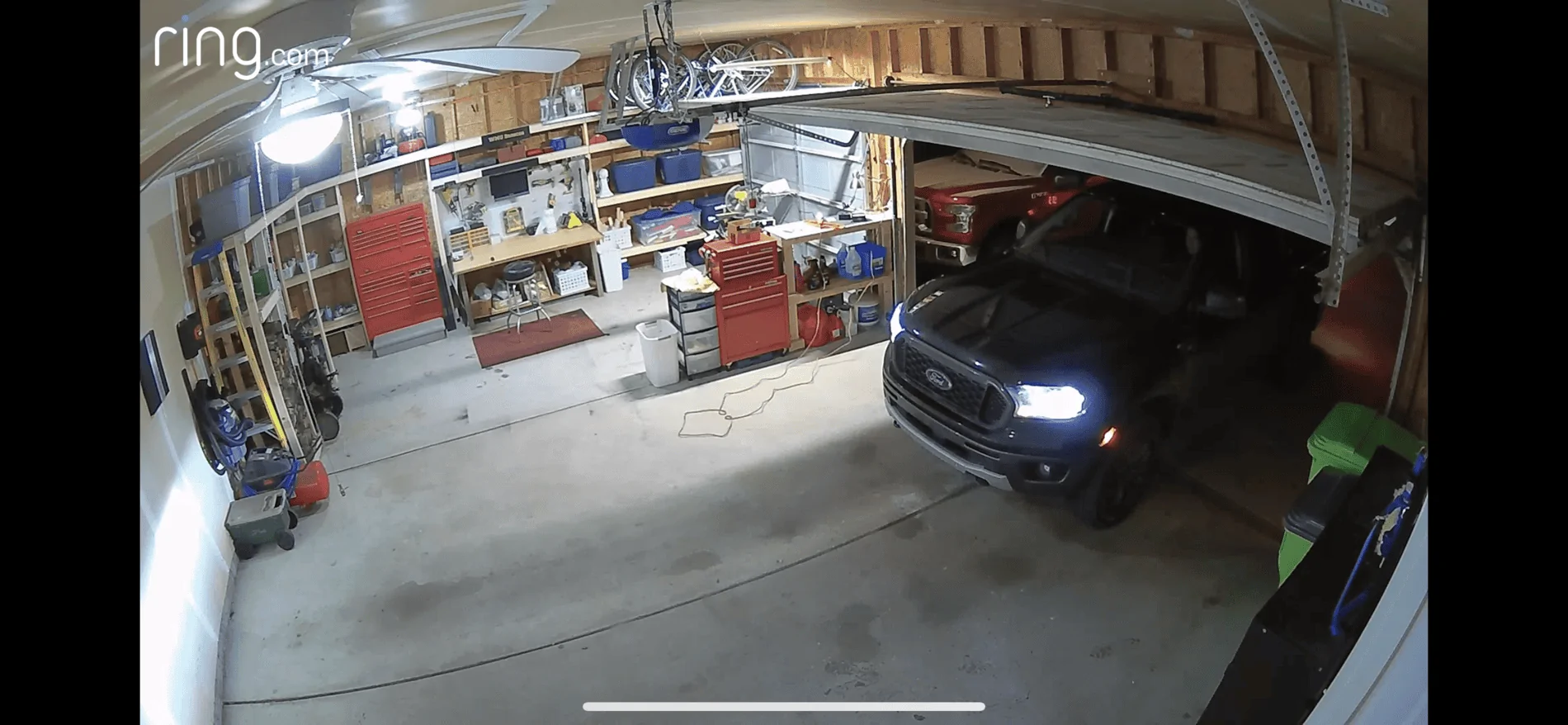

I’m currently running Auxito mini’s in my low beams and not happy with the lack of cutoff - probably due to the high lumens - 16k over driving the projectors.
I’m thinking about the JDM Astar 1.1 as you guys are using. I notice they are not clockable. Any issues with getting these in the right position?
it didnt seem to matter on these. The drivers side is running 2 and 8 and the passenger is running 10 and 4. The hot point is nicely centered and the cutoff is even.
We have an ice storm happening at the moment so I havent drove with them yet but you can get an idea of the cutoff from the images I snagged off my garage camera. Halogen vs JDM’s.

Those look really good. The Auxito’s have so much scatter that the cutoff is almost non existent. I’ve had them in a week or so and adjusted them down a bit (after my level) and only been out a couple times in the dark. Haven’t been flashed but expected to. I’ll probably run them for a bit and see what happens but I like the look of the JDM.
