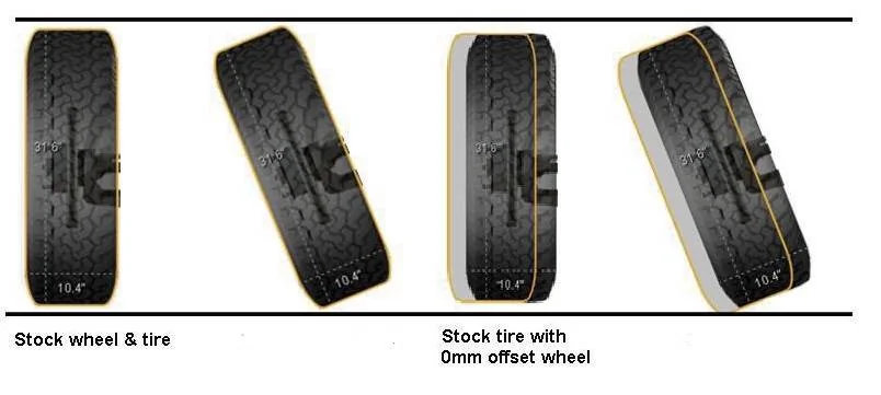

Offset’s a funny thing - the larger the hub spacer , the more problems you might have. Big hub spacers are like having lower or negative offset wheels.
Spacers and lower offset push your wheels out. Think of it this way, turn your wheels all the way left, the hub is now at an angle, now put in a two inch spacer, and you’re pushing your tire closer toward the crash bars.
The picture below tells the story - the horizontal bars represent the crash bars, the shaded tire represents the new tire position with a low offset wheel or adding a spacer.
Now add in the reality that the more lift you have, the higher up you are in the tire’s arch and the more room you have to clear crash bars.
So, with those wide and tall 285s, you need to:
  1. Clear the knuckle (1/4” to 1/2” spacer will do it)
  2. Not push your tires into the crash bars (keep factory wheels)
  3. Hope your Tremor’s factory lift is high enough (likely)
There is a 1” front level kit on the market if needed but should be a last resort.

Yep totally understand offset and impact on crash bars. I am convinced crash bars need to go (or be replaced with low profile). Also suspect will need to decrease offset to clear suspension. Totally understand all of that.
Really just asking to see if anyone has done this with stock Tremor suspension.
