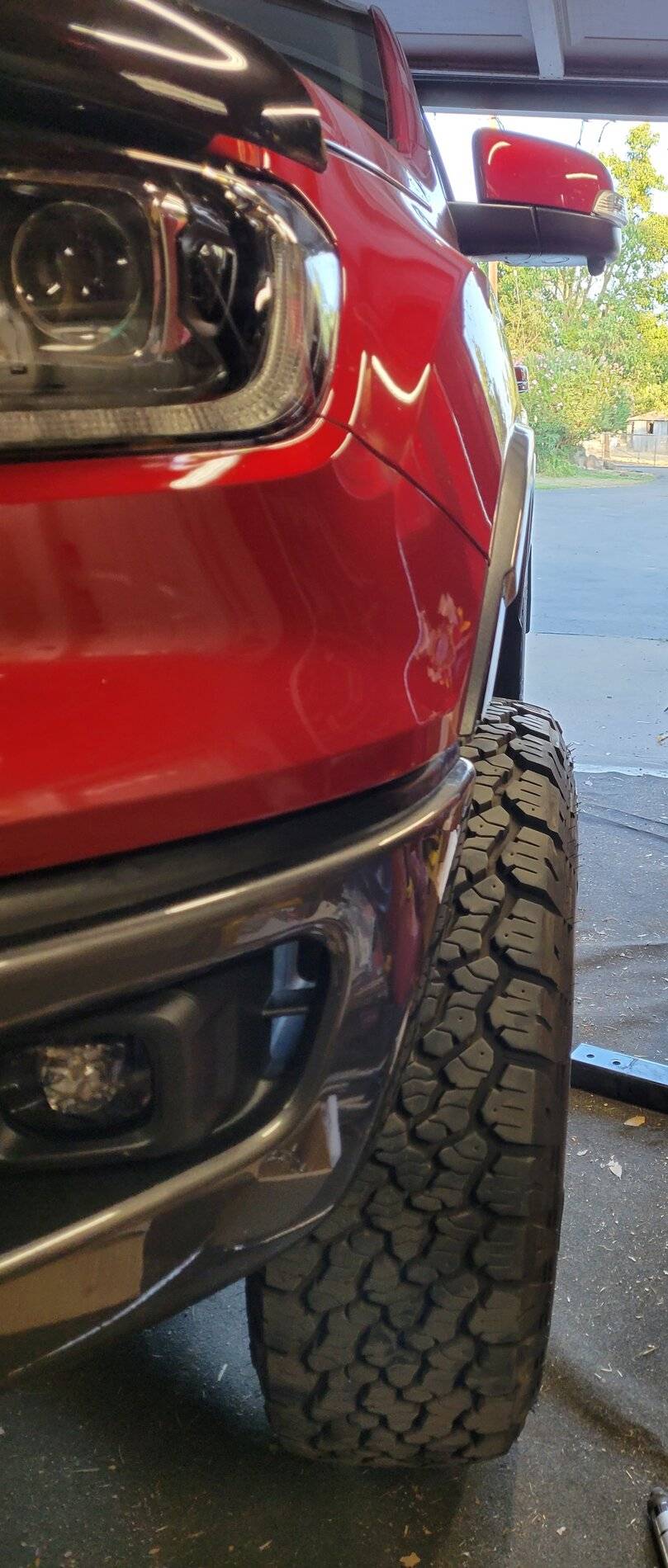

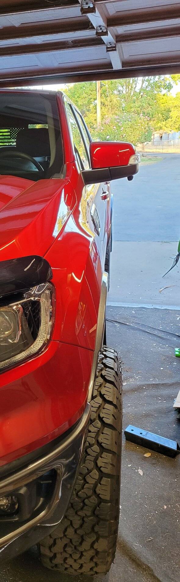

I got some 3" spacers and put them on to fit for rubbing, etc. I had to remove the front crash bar and stock front mud flap. Fit great after that, except my wheel studs arent long enough, so I have to pull it back off for now.
Here is what it looks like on just 1 wheel:

The larger the spacer, the more clearance/rubbing problems you create. Not sure what it is you are after here as you ultimately had to remove parts anyhow.
Raising the vehicle height will resolve clearance issues, not pushing the wheels out.
Edit: Sorry I read that as "fix" not "fit".
Disregard.

No worries, lol. I just wanted a more aggressive stance. I'm very happy with the look, just need to get some longer wheel studs to make em work.
What brand?

Be careful, amigo. A 3" spacer is dangerous territory, in my opinion. Looking at your profile picture you at least occasionally dabble in off-road type shenanigans and I think you're setting yourself up for some catastrophic failure.
If you want the look get some wheels with a better offset and retain your current tires to help mitigate the cost.
Will any spacers fit so long as correct bolt pattern?
You need to match up bolt pattern and center bore size (93.1 is factory size) assuming you use hubcentric spacers, which is recommended. You can also go with a larger center bore on the spacer if you use hubrings. Also have to make sure your existing wheel studs are long enough.
