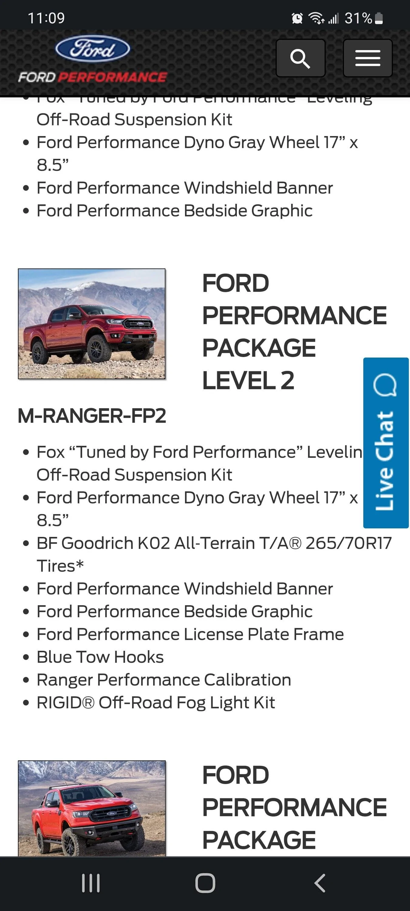

https://performanceparts.ford.com/vehicles/Ranger-packs
Considering it's the same size as the Tremor tire, and also sold by Ford Performance I'd say it's a safe and logical assumption.
It is literally the largest tire size listed by Ford in any remotely official communication regarding the Ranger.
I would say those are but I’m not sure if the the Ford tune will allow sizes over that. I didn’t try it.
Edit: Yes the tune says up to 265 70 17 tire size so I agree. You are correct.
7,142
24,335
so the Ford performance pack paper work states warranty is covered with the package and tires up to 265 70 17 or equivalent based on the factory rim size you have.
