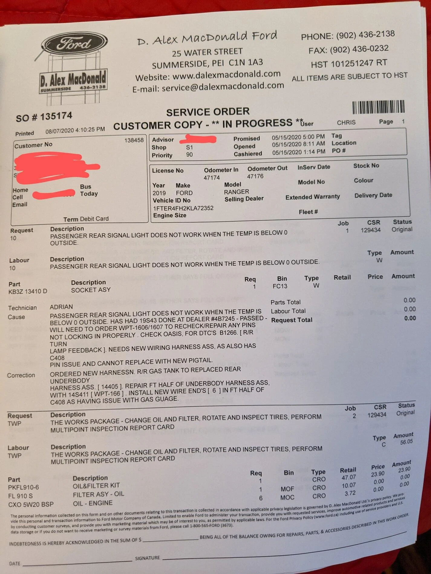

Thanks man. Yes definitely plan on keeping everyone updated. Wether I get a trade, a new truck, buy back or the get to the bottom of it once and for all. Haven't posted an update yet as nothing new to report this week. Ford was able to replace the section of wiring harness and get my fuel tank/gauge working properly again. Still waiting on the faulty cameras to be replaced. I'm moving to another province tomorrow. So getting it on the open highways will be interesting to see how it performs at regular highway speeds. As well CAMVAP sent a letter to ford for me, and ford hasn't responded yet. So just waiting on that. Cheers!
