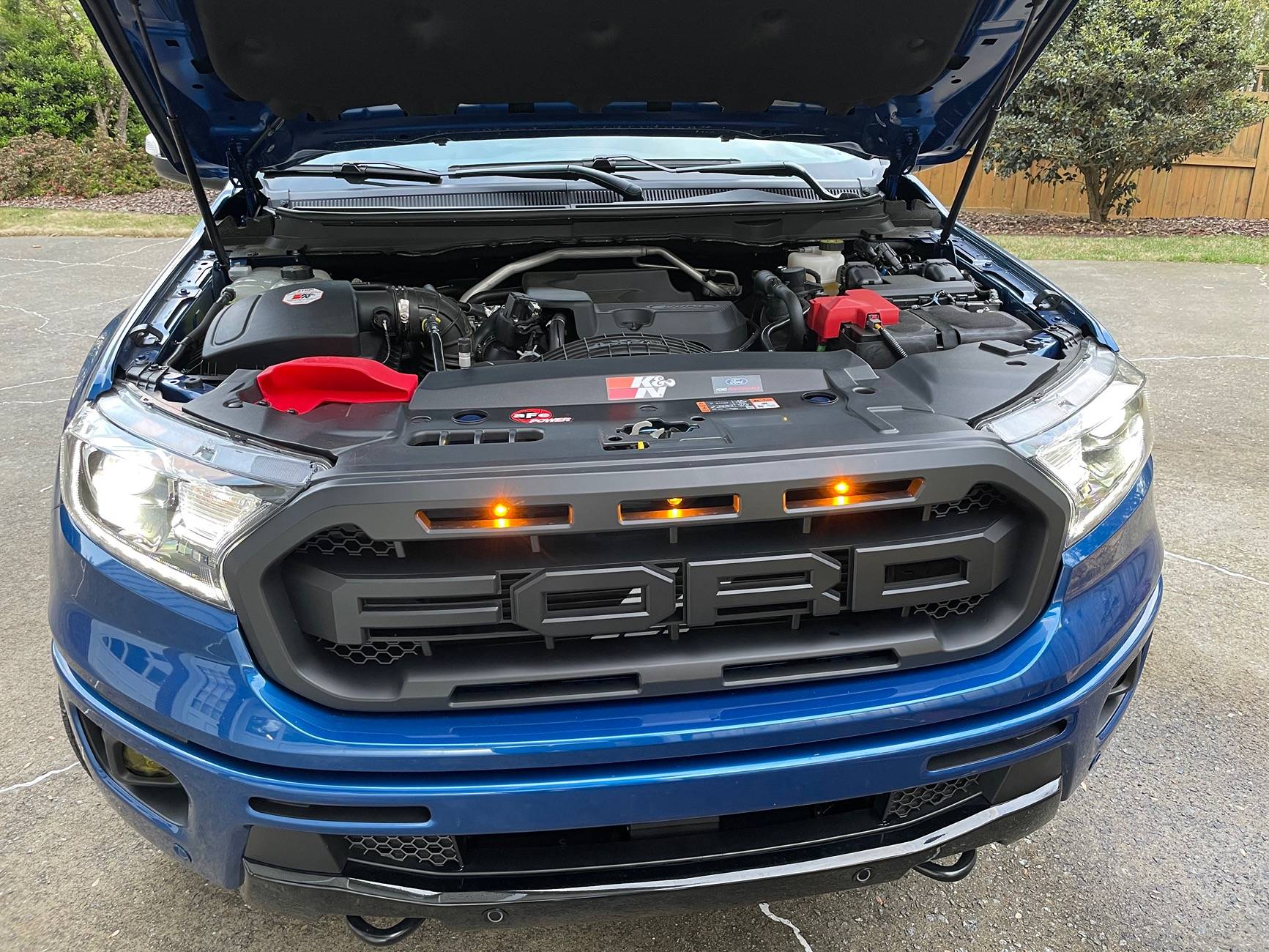

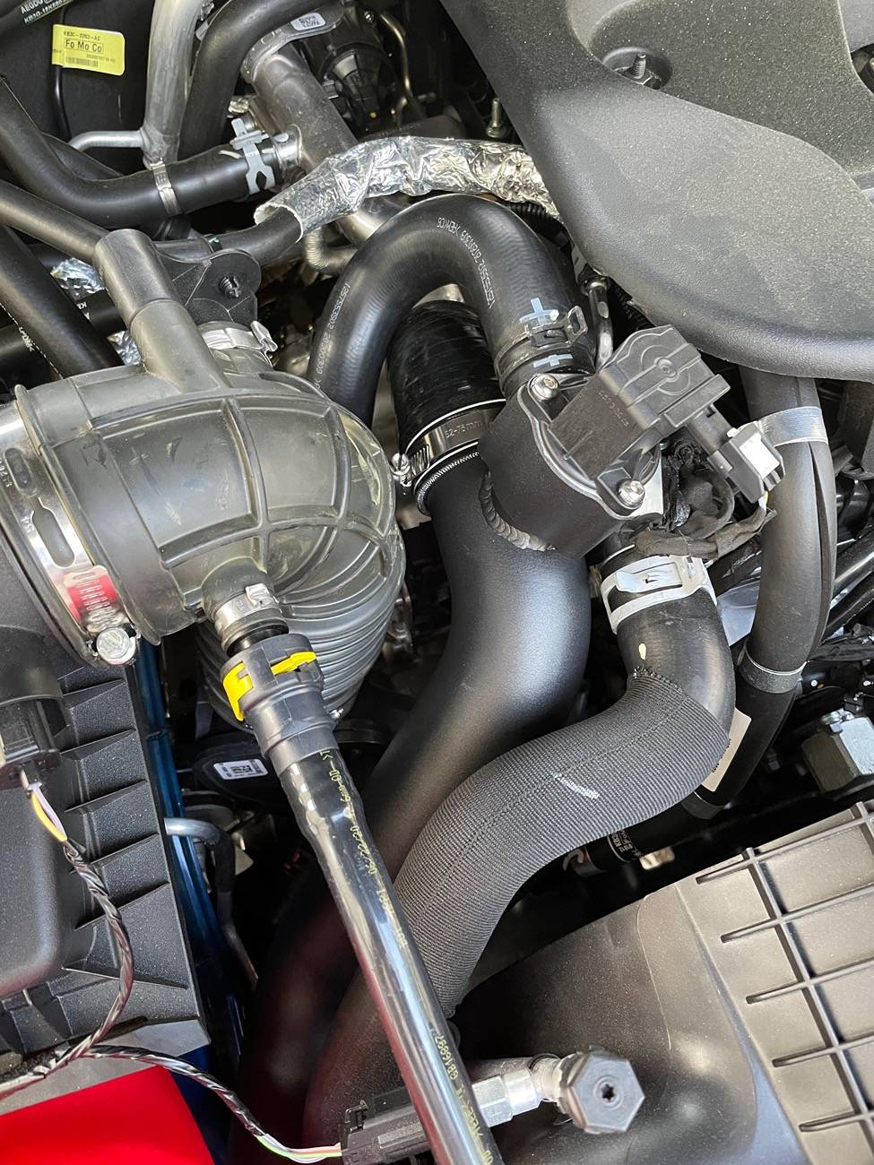

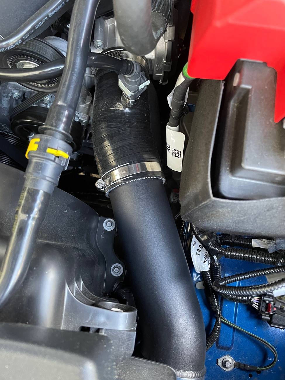

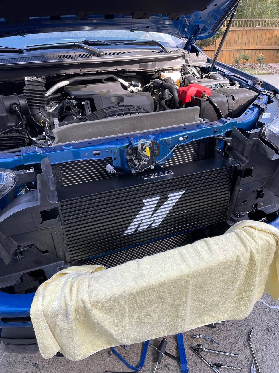

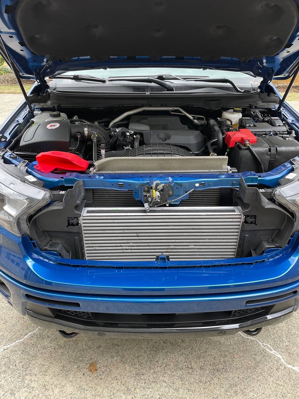

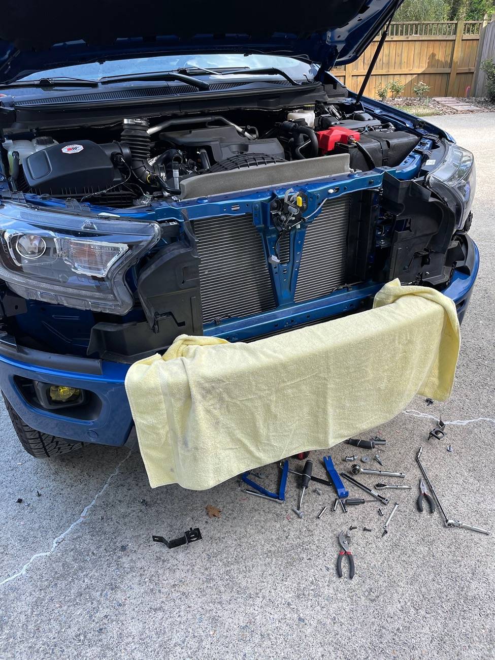

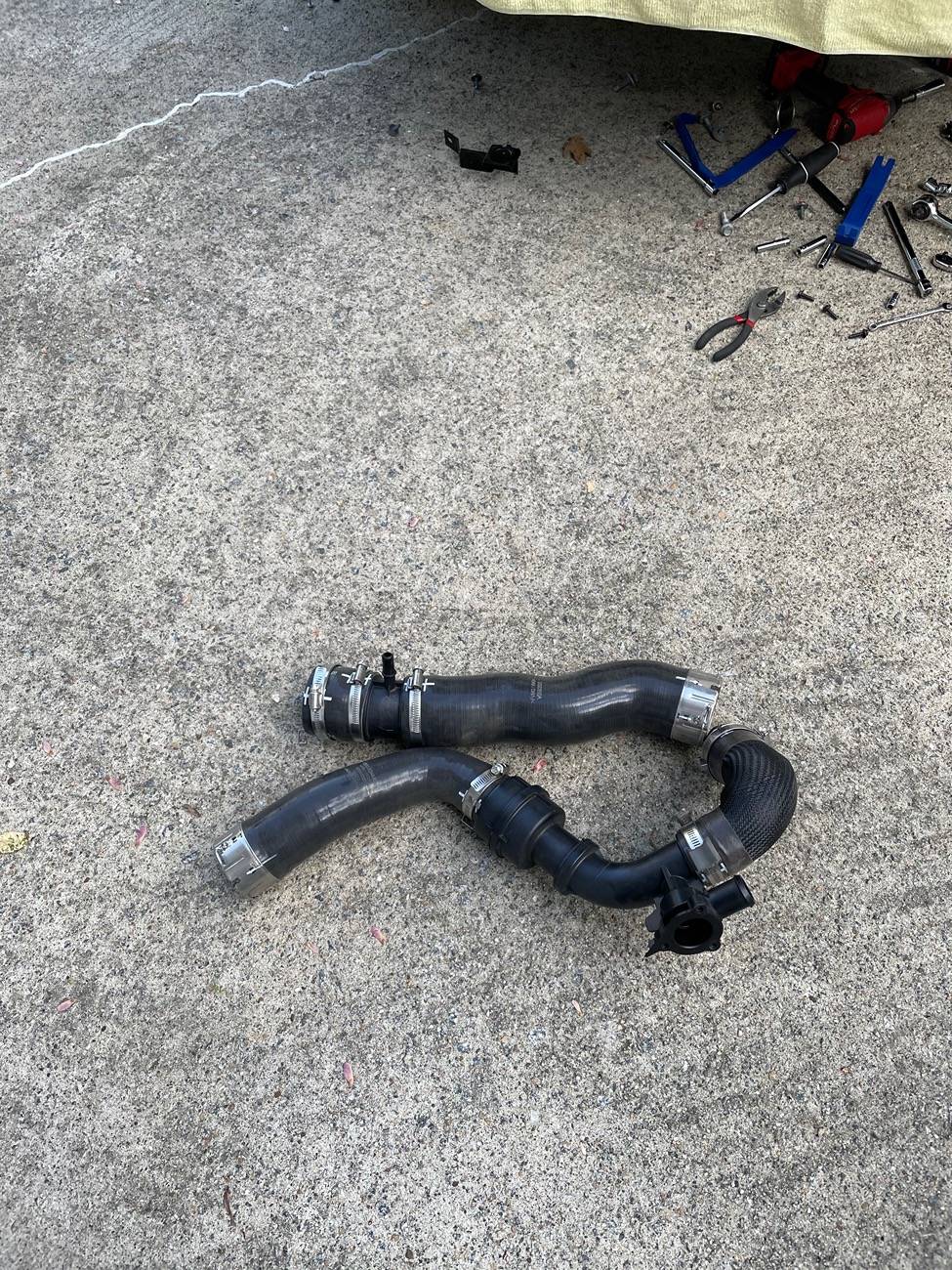

It was a total pain in the ass, but truck runs strong.
I'll echo this, was a pain in the ass to install especially since no one makes GOOD instructions... I went with the Elliot Specialized Performance unit, which didn't come with directions (it was only 400 bucks for intercooler and piping). Ended up using Mishimoto's instructions which were still terrible but I expected that after installing their catch can (which might have been a bigger pain in the ass than the intercooler). However now I know I'll get consistent performance which was the ultimate goal.
My Focus ST benefitted hugely from a properly sized intercooler, so knew the Ranger would also appreciate it as well. I don't regret the decision to get one, just wish I gave myself a full weekend to do it. Also if you're going to install a new grill, this would be the time to do it... I broke about half the clips on my Lariat grill, but fortunately still enough on there to hold it in place.
That looks really nice. I watched a video that showed you have to cut a lot of plastic out of the way on the truck to fit the larger intercooler. Did you have to do that? I haven't found a good video that shows a step by step to get this done. Probably because its such a pain. I'm surprised that Stage 3 hasn't made one.
I've already installed a new grille, so hopefully I want ruin it when I do this.
