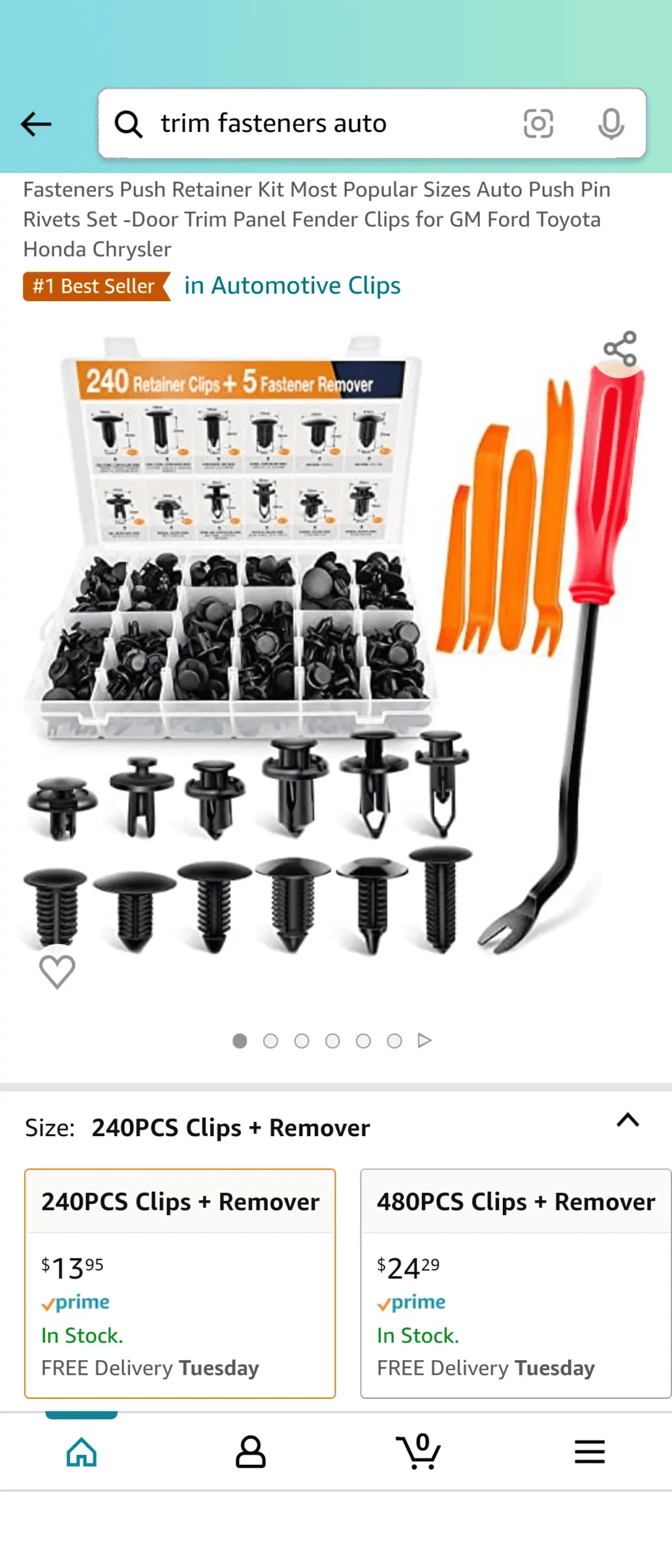

I keep a kit like this in the garage for anytime I break or lose one. 240 pieces for $13 is a whole lot better than paying $3 or $4 a piece for them.
Yep bought the same kit myself.
Added a Fumoco OIl valve too so I don't have to remove the skid plate.
