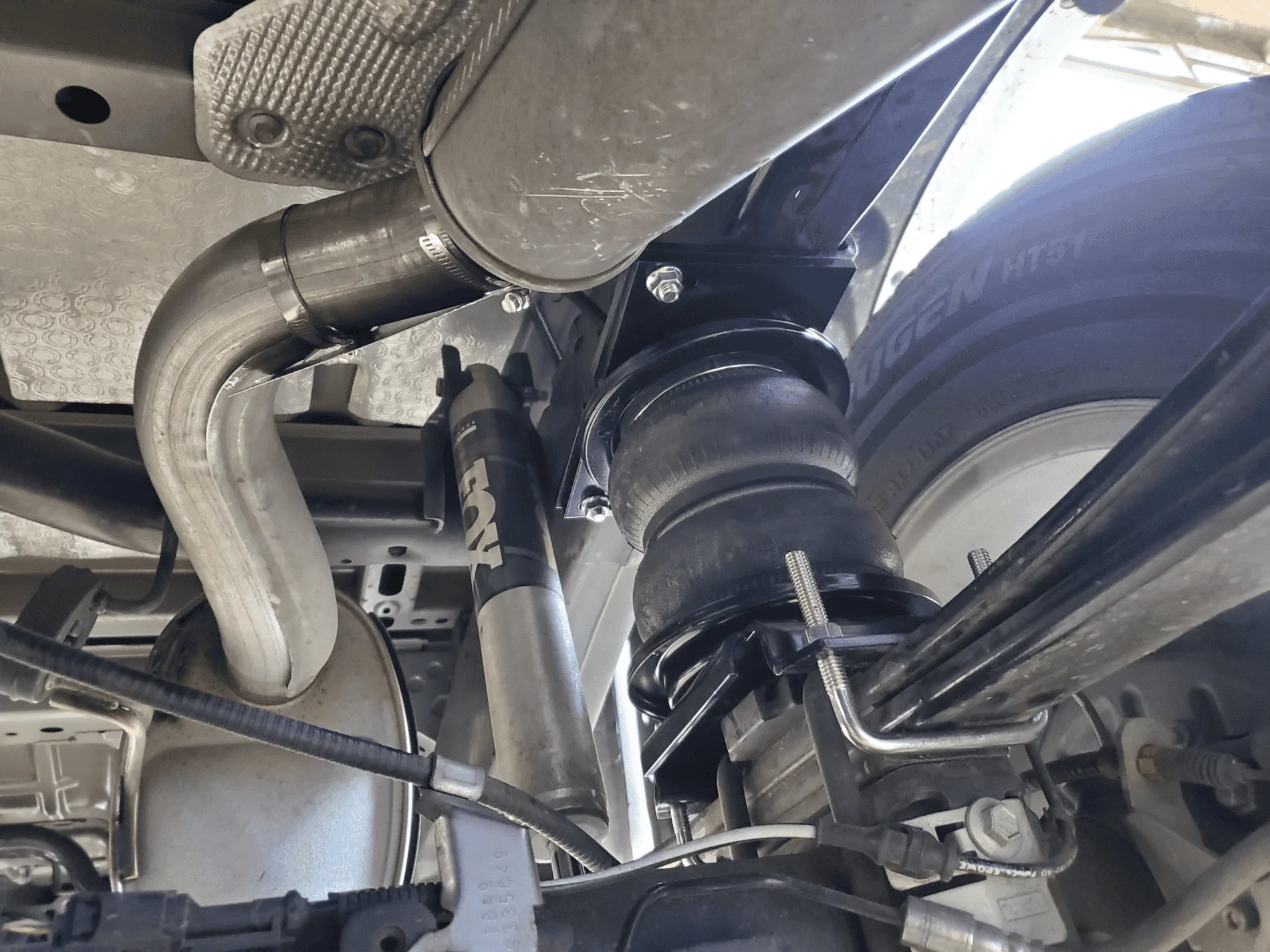

I installed some air springs, they do the job. I run most of the time with little weight in the bed, but I sure do load (overload) it at times.
I spent the afternoon trying to install the Firestone Air Springs on the Ranger. I followed the instructions, removed the jounce bumper and when I tried to slip the lower plate on with the air spring, I found I couldn't make it fit. It seems Ford has added some part that looks and feels like hard plastic that sticks out sideways on either side of the plate the Lower plate is supposed to fit over. The result is that the lower plate cannot fit over these additions so I cannot get the plate to fit. I tried but I am not quite strong enough to bend steel that thick a 1/4 of an inch. So then I had to put it all together and replace the jounce bumper...(that was fun) so I could get the truck mobile again... I was really tempted to just cut the plastic with a zip blade but I thought I should check to see if anyone else has gotten through this dilemma.
I'm really considering that.
Old post, but what bags did you go with?
Yes all of us that installed these got through that delema by...cutting the plastic. No worries.

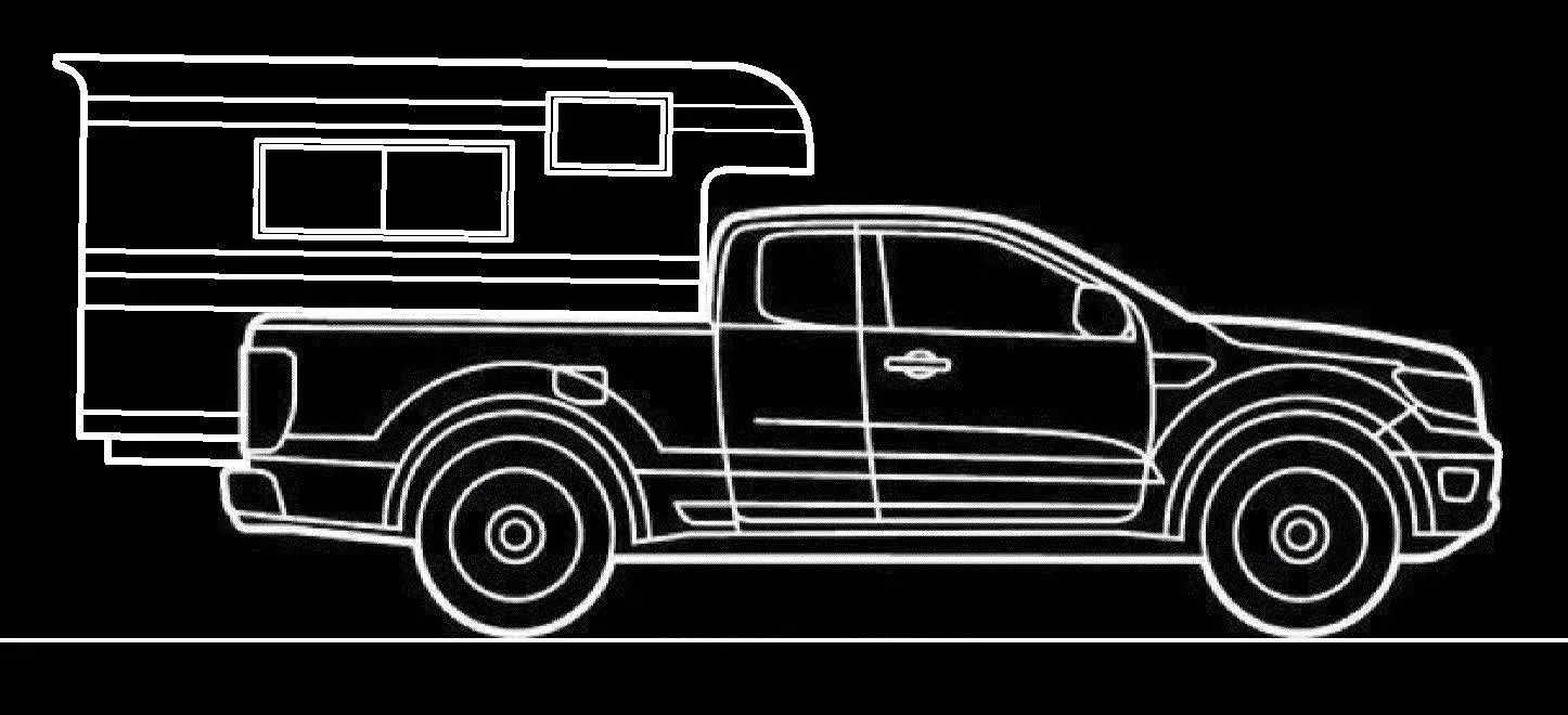

Most of the time, I carry a 1200 lb cabover which puts me right at payload capacity by the time I add two people and stuff.
When I originally picked up my truck, the guys at Ford suggested I ride with the stock suspension for awhile. I've done this for 9 months and while it's workable, my truck's enough of a handful I wouldn't trust anyone behind the wheel who's not pretty mellow -- I get a lot of roll in corners and on roads with deep holes. I spend a lot of time on rough roads.
From what I can tell, helper springs might be a good choice for me, but I don't know what I'm doing so I'm looking for a reality check to make sure I'm thinking of both my problem and the options in the best way.
I posted a question about your camper in another thread, but here you answer it.
Mine isn't as tall, but mine is longer.
I haven't had a chance to put it on to see how my ranger will handle it.
If the slide in camper extenda past the bed(tailgate closed position) then it is not correct for the application and will give the possibility of a Frame breaking on you.

Really don't think I'd put any sort of TC on a Ranger. Just not enough truck for it.
Just my 2 cents.
