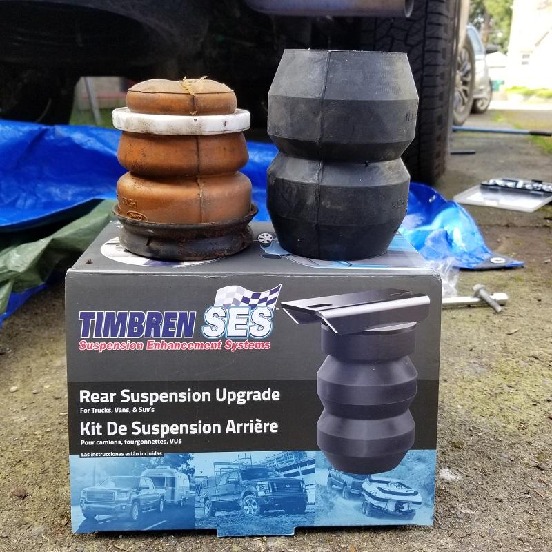

I won't get home until late tonight, but here's a shot of the Timbrens next to the stock jounce bumper (inverted). Not shown is the Timbrens steel plate that contacts the frame -- basically a sturdy round metal disk.
In addition to visible differences, the Timbrens are far beefier and the rubber is better than the stock jounce bumper -- the support difference is massive. Aside from making the truck drive much better, it barely moves at all when I hop onto the trailer hitch step.
I'm very happy with this purchase and think this is an excellent option for those who regularly carry heavy loads.

Timbrens.... I learned something today :like:
"HOW THEY WORK: The SES kits are designed to mount between your axle and frame leaving approximately an inch or less between the SES kit and the axle. When your suspension compresses the Timbren kit will kick in and help to support your stock suspension.
CONSTRUCTION: Timbren kits consist of Aeon hollow rubber springs and any hardware or brackets required for installation. The Aeon springs are the heart of the kits. These extremely durable springs are constructed of a high grade rubber that are backed by a lifetime warranty. "
