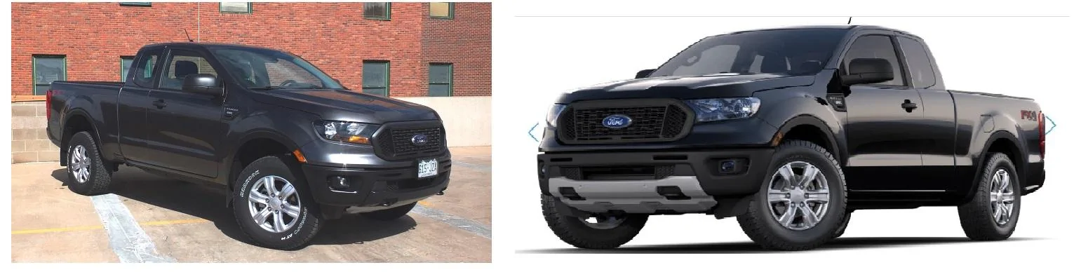

There are two approaches, lower the rear, or raise the front. I don't mind the factory rake, but asthetically the truck would look better if the rear was lowered.
Then the centerline of wheel openings in the fenders would be closer to tire/wheel centerlines.
And don't take my word for it. Every rendered image of every 4x4 or FX4 Ranger posted on the shopford.com site has the front and back lowered.

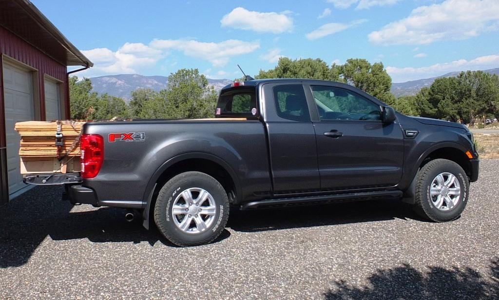

Adding 1,098 lbs of cargo helps to achieve the rendered look.. :cool:

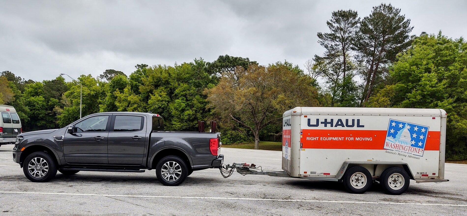

Like others, my truck gets mixed use. Granted I went from a sedan to the Lariat and wanted a 'nice' ride. Fiddled with the engine and some cosmetics, replaced the oh-so-trucklike shocks in the back for a better ride then 'compromised' with an inch and a half lift in the front to keep a little rake but not upset the stance when towing. The 6x12 U-haul trailer doesn't get close to the weight limits of the truck but right now is the biggest thing I care to haul.
I admit the cosmetics were a driver. But I'm upgrading my tires to Michelin's because they perform better (ABS included).
If it's not one's thing, I'm fine with that. Trucks are not precision driving machines (although this one has a lot of refinement I didn't anticipate when I bought it) and I don't feel I'm spending unnecessary monies to get the vehicle I think I need.
