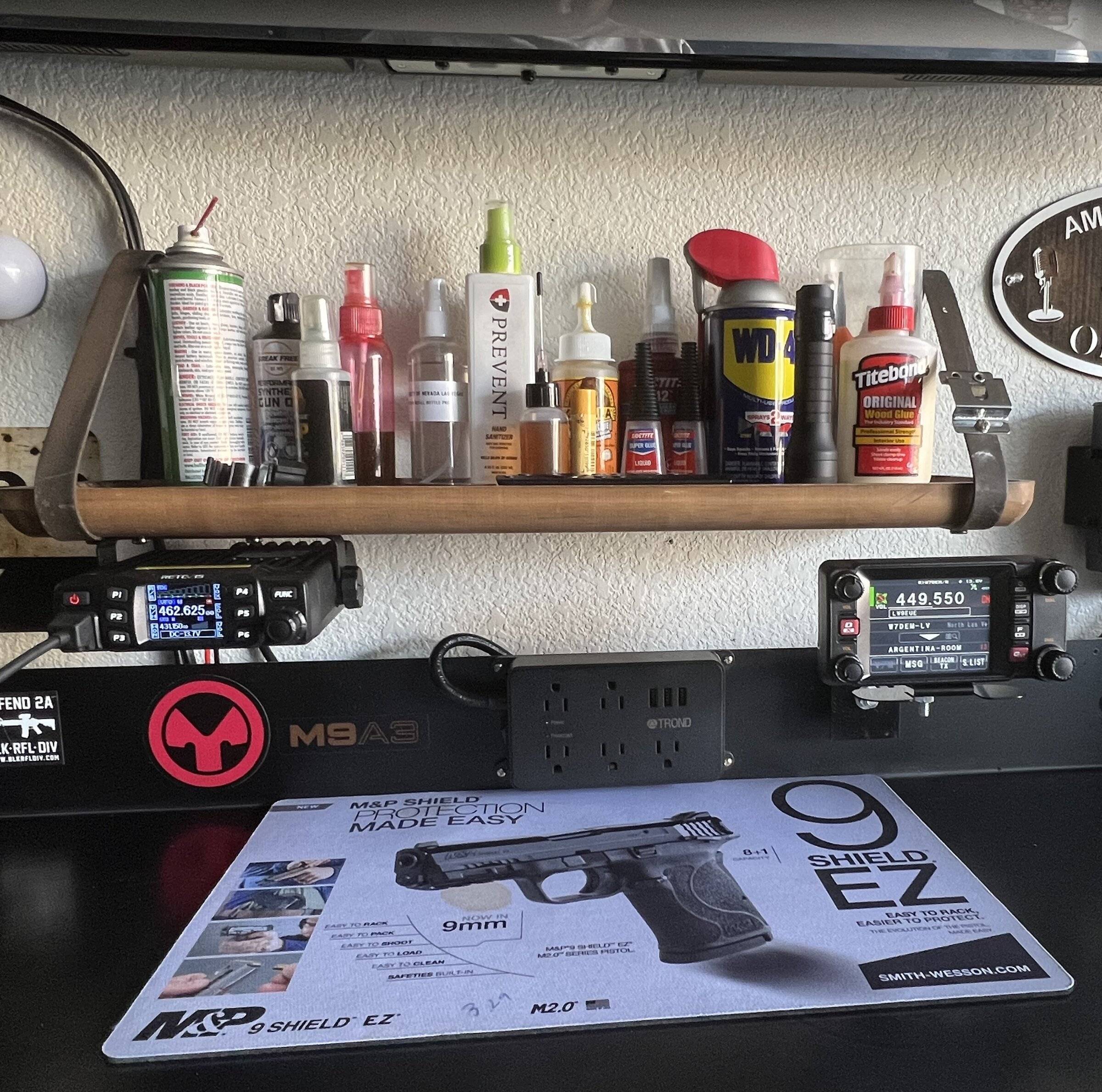

I have an inline SWR and Wattmeter and it shows 1:1.4 and 23.4 watts, which is within error, having a little trouble getting the SWR down to 1:1
Been messing with the radio today all day. Amazing radio, especially for the price.
