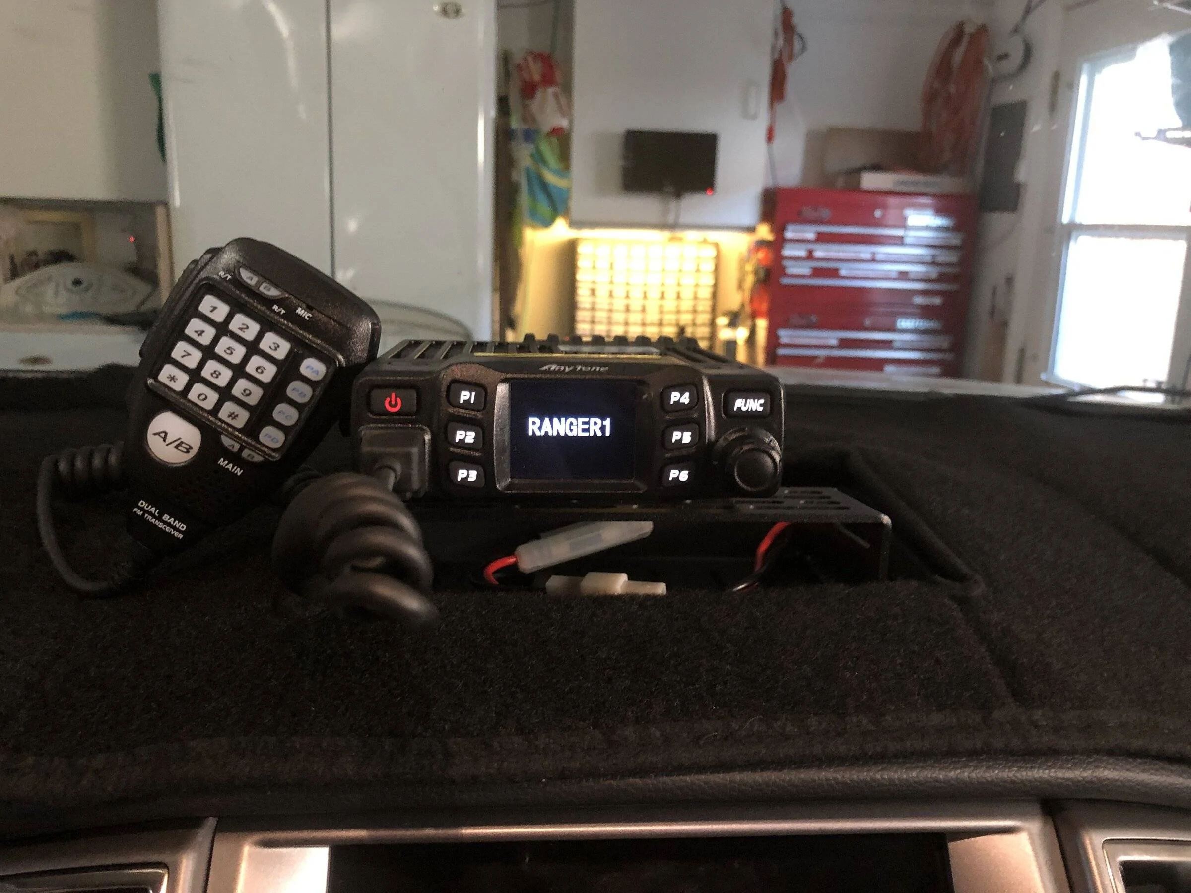

I did the same thing! Since I have a ham radio installed in my truck also, I wanted more SOC.
Same here on the HAM rig, even on mid pwr it pulls 13 amps.....
Bro that’s funny! I actually ordered that exact radio and I’m getting it today! It’s going in my QTH for GMRS use. I have the FTM-300 in my truck, and a FTM-400 in my QTH.
I have been using this one for over a year, and so far no complaints, menu system takes a little getting used too. I use CHirp to program it, and like the fact that I can use my laptop to make changes on the road in case a group is using a channel I don't have. But I do have all of the MURS and GMRS, as well as HAM 2 mtr, and also added ther FRS on low (500mw) for trail crews. Programming at the rig is a nightmare so if you don't have CHirp by all means get it, makes it simple.
Roger that. I do plan on using CHIRP. Have you tested the power output by any chance? Does it do the full 25 watts?
I have an inline SWR and Wattmeter and it shows 1:1.4 and 23.4 watts, which is within error, having a little trouble getting the SWR down to 1:1
