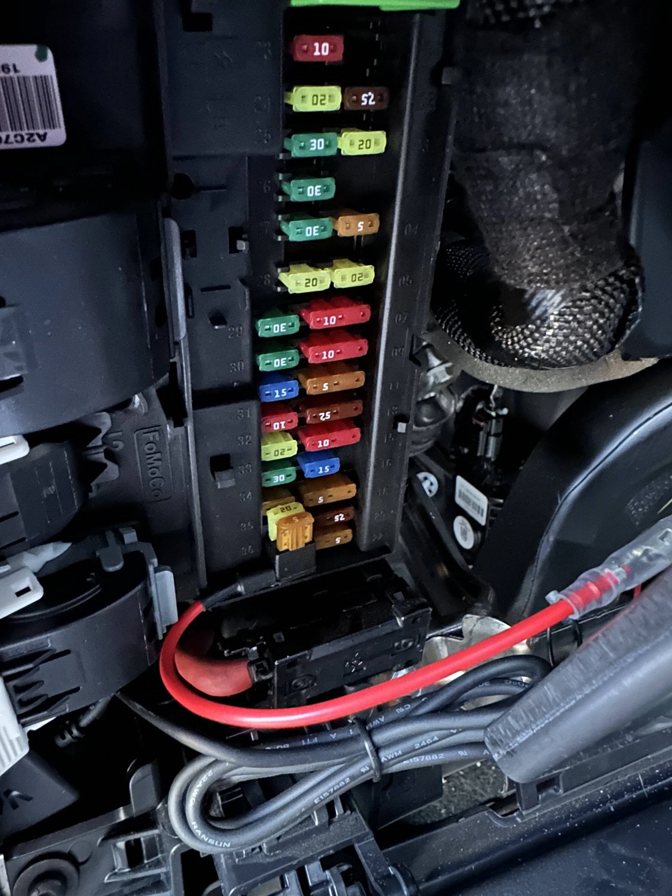

I hardwired it with a vioso cable thinking it would work since they're both usb-c. I liked that over the vantrue one because you can set a higher cutoff voltage. Then I found they're not compatible for some reason. Camera wouldn't turn on at all regardless of truck on or off. Used fuse 30 and 37 and the same ground point I've seen others use.

I just installed a Vantrue E2 in my Ranger this week. The Vantrue hardwire kit is compatible (if that's the one you bought). Use the Micro2 add-a-fuse in fuse 37 behind the panel under the steering column.
