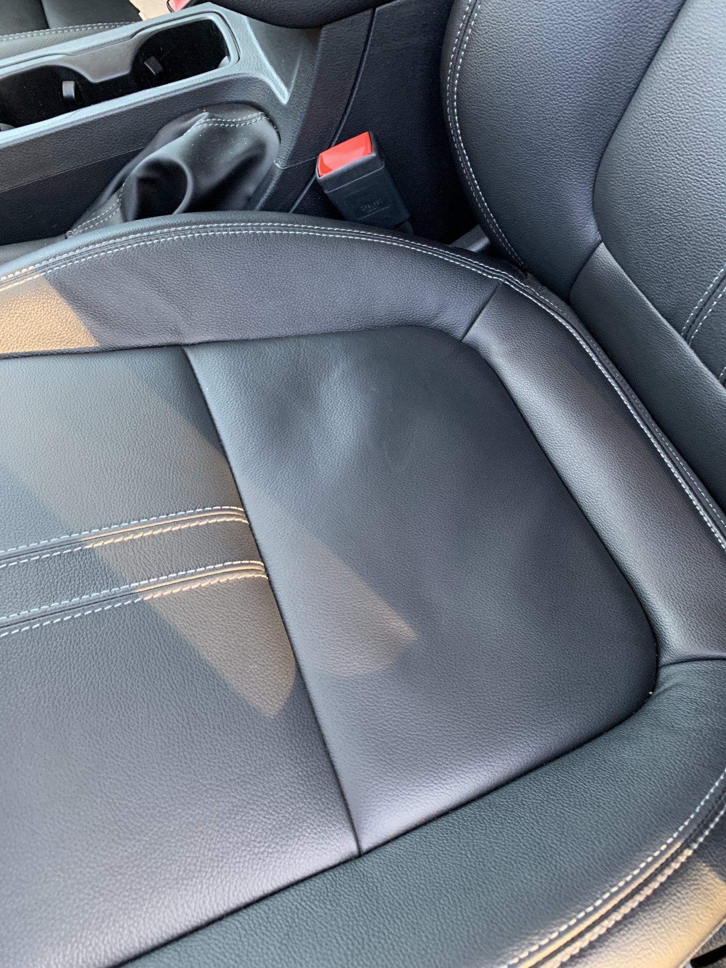

UGH! I noticed my seats a week after buying it were getting a little saggy.... My ranger is only 3 weeks old now. I was wondering if I was the only one until I saw this thread today.

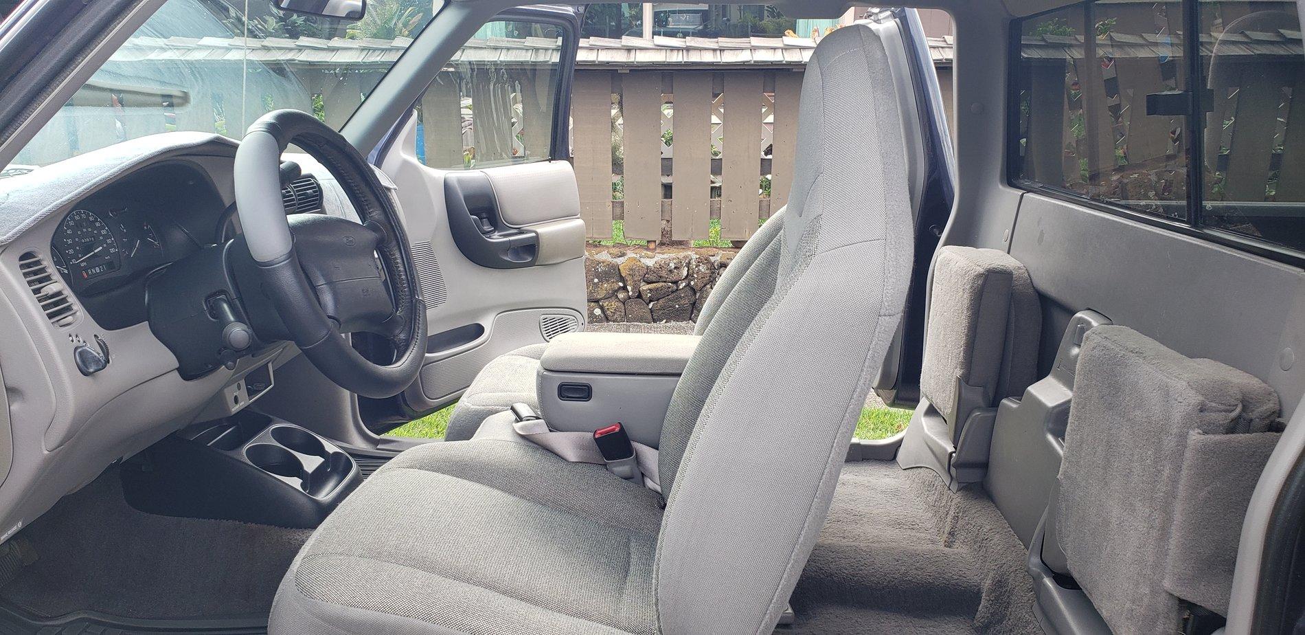

While I know my response here does nothing to address the issue here, I intend to install Wet Okole seat covers on my 2020 because all my previous Rangers had them and they did a marvelous job of protecting the fabric upholstery. Attached is an image of my 2000's seats after I removed the seat covers.
The black leather seat covers on my truck suffer from the same issue, not only on the cushion area, but the bolsters are noticeably wrinkled as well.
Indeed, such appearances does not befit a vehicle in which someone can potentially spend 40K + on, but it's been my personal experience that collateral damages can occur with removing and replacing the seats from the vehicle, such as damaging surrounding plastic trim and scratches on the door sills.
As for the overall build quality of the truck, I'm completely satisfied both in and out, this is the best assembled Ford I've owned and worked on to date. All body and trim pieces are fitted well, with even gaps and seams, all 4 doors latch with a re-assuring clunk, and do not need slamming to do so. Under the hood, Ford has progressed light years with the overall visual experience, it seems as though they've taken cues from certain Asian automobile manufacturers here, who, IMO are masters at this. They only detraction's are the "Jiffy-Pop" appearing heat insulation used and the occasional un-raveling of the black tape used on the wiring near the connectors. The material chosen for the engine cover is suspect though, it appears to be some sort of closed cell foam, in time I know this cover will disintegrate from heat and possibly rodents developing a fondness for it, but then, this is not an assembly issue, rather an engineering or cost
choice.
When given the chance, I inspect family and friend's new vehicles for build quality and can truthfully say this truck ranks high on my list.
To quote some advertising slogans from the past "The Closer You Look, the Better We Look" and "You've Come a Long Way, Baby", well, Amen to that.

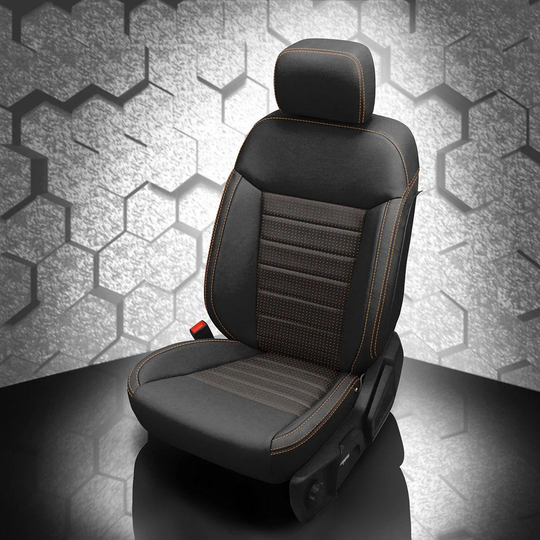

Leather will stretch and form over time. Heat from seat heater and body will aid this shaping to match your back side. The large flat leather panels are the issue.

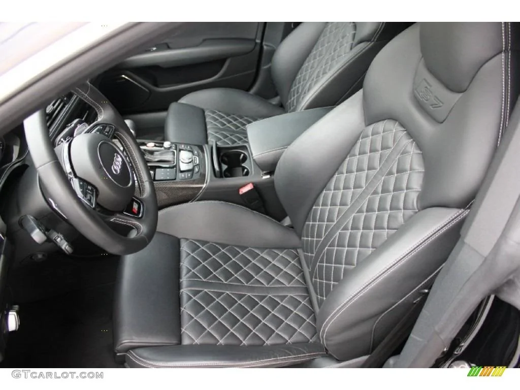

Katzkins seat replacements have a better design. The perforated material would also help. An Audi diamond stitch pattern will also help as it breaks issue into smaller sections. On the Katzkin sight they show a diamond pattern option. Not sure if it can be added to Ranger seat but if I upgrade my XLT this will be a question of mine when I design the interior.

I'm not saying there isn't an issue with these seats but my scrawny ass has done this to every leather seat I've owned. My 2011 Flex Limited and 2014 Fusion even had stitching across the cusion cover and it still bubbled like that.
