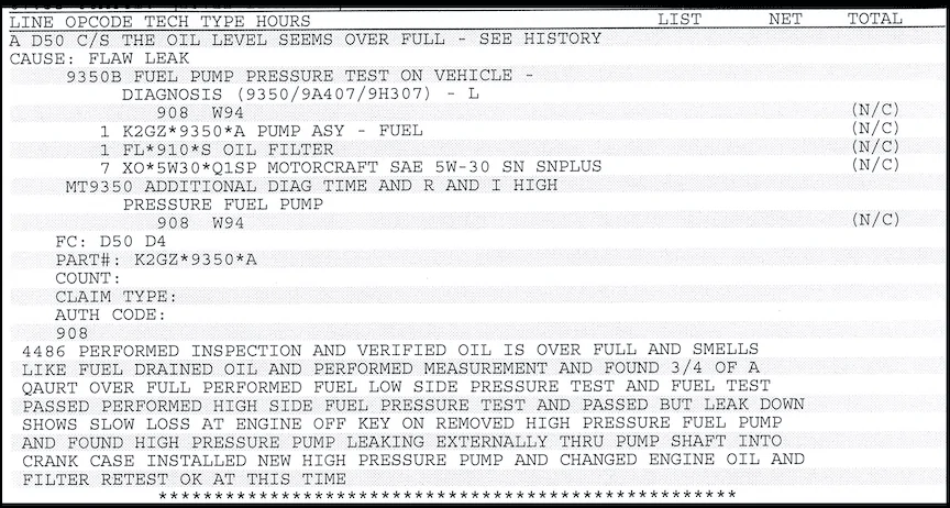

I have yet too see one post showing 7 quarts or more being drained, measured and photographed/certified...
The dealer drained ~7 qts only 2000 miles after an oil change on my truck. Mine was for certain caused by the HPFP as it has now been 5k plus miles and the level has not gone up.
My dealer seems to have done a pretty thorough testing of the system to find my problem, also my HPFP might have been leaking more than most and making it easier to find the issue.
Update:
Picked it up today.
Now I just have to watch it closely until my apprehension is sated.
Hopefully others with this problem can have a dealer perform these tests and witness the bleed down.
As I have stated previously, the major fuel levels in the crankcase have to be coming from a "plumbing" leak and are not a running issue. The very slow increasing levels are from faulty pcv systems and/or not enough crankcase air volume turn over.
