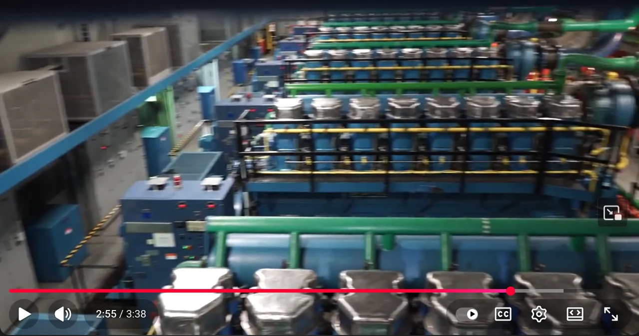

When I stationed at NORAD CMC, I remember visiting the generator area. 6 very larger diesel generators lined up pretty as you please, with cat walks up near the top of the engines. 2 running, 2 for backup, and 2 down for overhaul. (Nothing like a nuke power plant in scale)
I remember seeing two men up on the catwalk with what I would describe a very large ratchet, both men working it to remove the head bolts, there was a large electric hoist installed onto a big I beam mounted into the top of the granite ceiling that lifted/moved major parts,
I remember looking up and seeing copper infused into the granite ceiling. When I inquired about it, one of the mantenance crew told me that one of the previous generation of generators had caught fire when the fuel line was breached and ignited when the fuel hit the hot exhaust manifolds, that they had to evac the area, seal the area and pull the air out the generator area to put the fire out.
That copper was what was left of the electrical mains that powered the entire complex. This incident happened years before I arrived for duty there. The facility was still mission critical back then, before the fall of the USSR and the end of the cold war.
I found this 9 year old 3 minute video, and those generators look just like the ones I saw back in 1976. Same light blue engine, green fuel rail and lines, and the same black catwalks. The video gives you an idea about what's there and even shows the generator room. I grabbed this image from that video. And I remember that row boat in the water reservoir!
This picture is taken from the control room that overlooks the generation plant. It is behind glass and actually very quiet until you open the door. The squeal is deafening without headgear.
