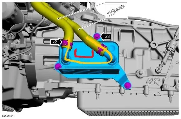

The Ranger uses an external Fluid Cooler, coolant lines run to the cooler vs transmission lines to the radiator.
So Transmision fluid does not flow through the radiator on the Ranger, however IF the fluids were intermixing then yes - the radiator should be replaced.
The Transmission Fluid Cooler should have been flushed or replaced along with the T-Convertor (if they used the old one)
If old fluid remained in the system, these are the only 2 ways for it to be induced into the system.
Fluid Cooler or T-Convertor.

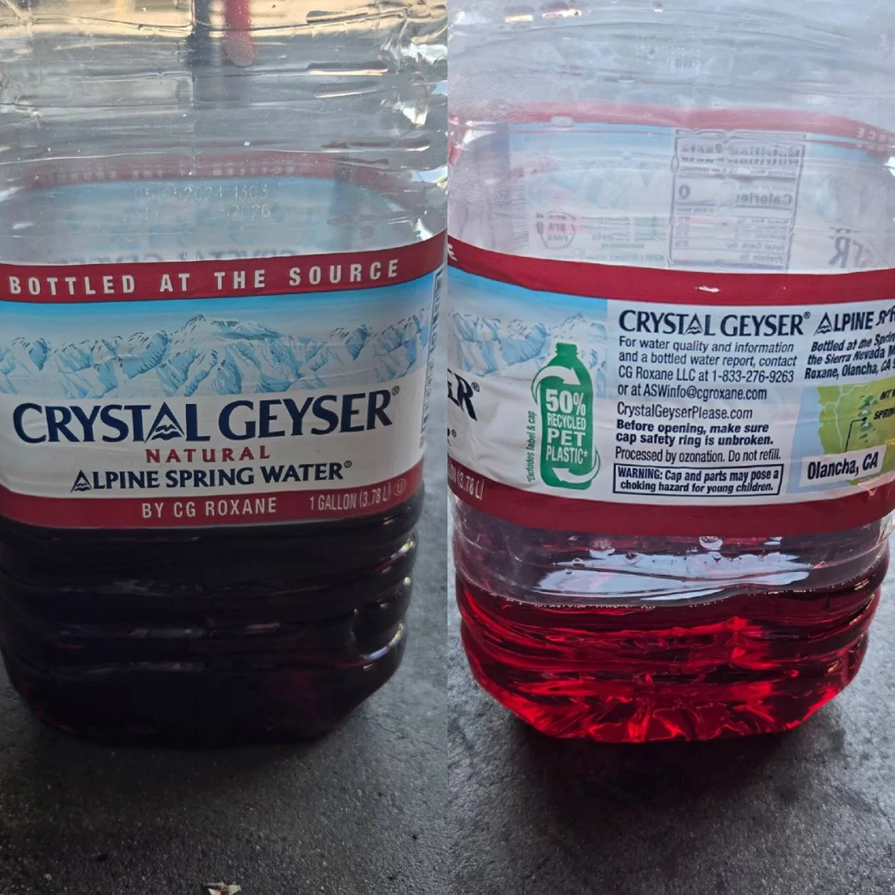

One dealer says they come prefilled, the other says they don't. Either way my fluid was pitch black and was not transparent. I'll show side by side pic of what was pulled vs new.

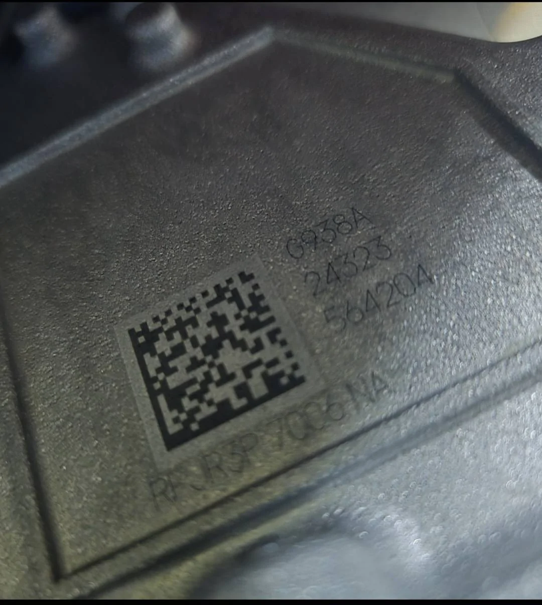

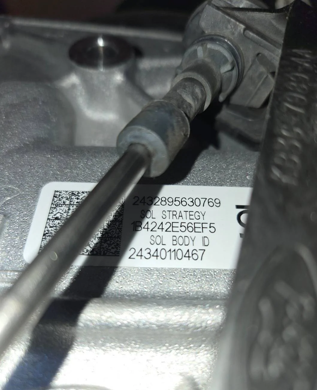

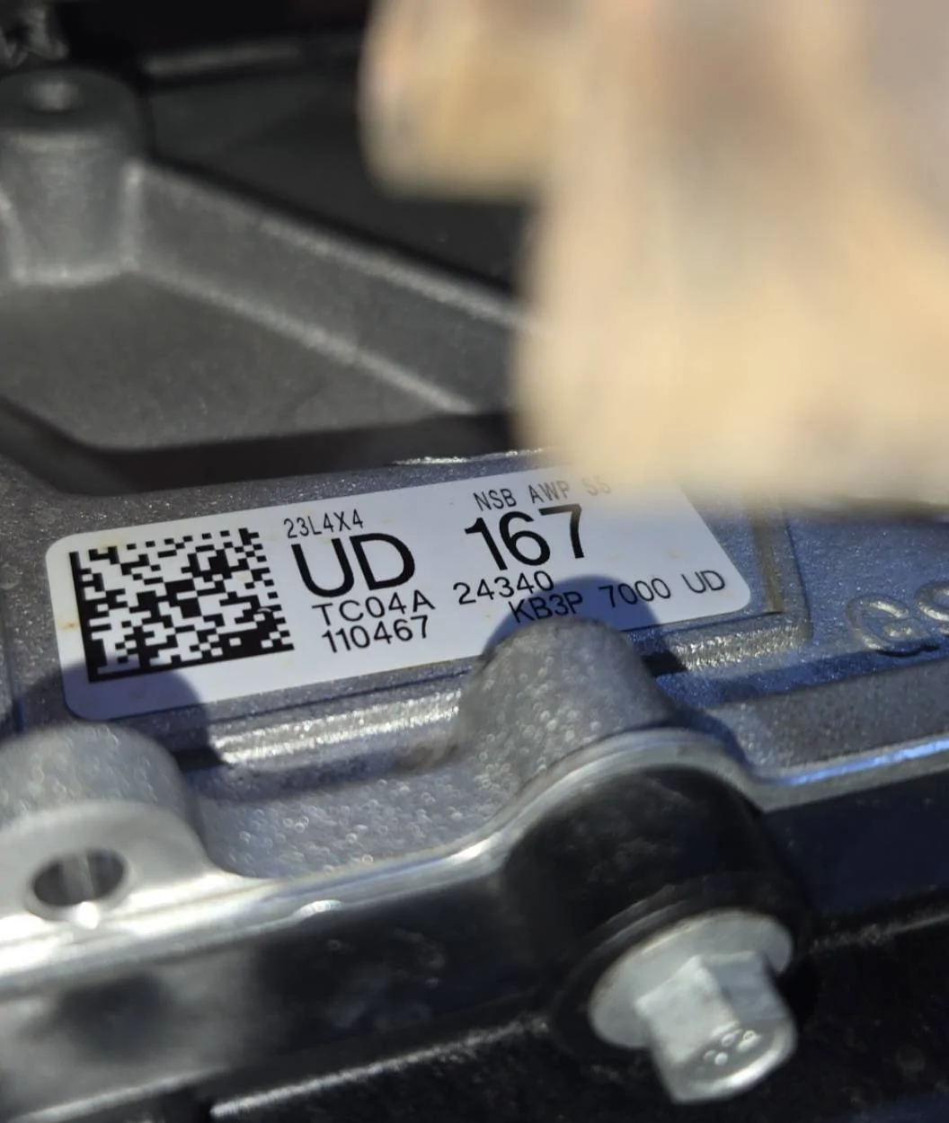

Some form of dealer shenanigans. The part number indicates new transmission. It comes with a converter and fluid. Can confirm this from others posting on here and my conversations with the tech who replaced mine ( an old timer who’s replaced plenty). So the dealer did something. I’d be crawling under and reading the data tag to see what’s actually in the truck.
I took photos of the tags & stamps. All I could decipher is the build date. It looked brand new aside from the fluid.
Stevedbvik1
Oct 4, 2021
2,898
8,780
2022 Ranger Tremor XLT
Yep that’s definitely new . December 2024 build. What the heck did that dealership do ?
