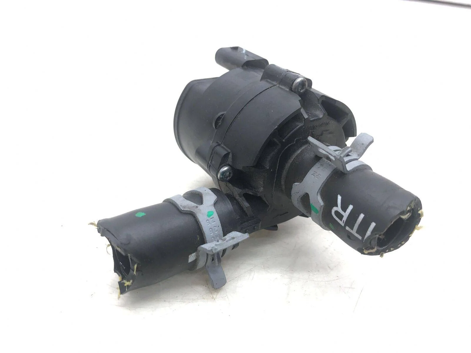

so then is the pump also deleted for the lucky few with the ASS delete from the chip shortage? IIRC it was a $50 refund. how much does the pump cost?
My '23 has the ASS Delete and I still have the water pump under the coolant reservoir/surge tank.
If memory servs, the H2O pump also functions to cool the turbo when temps are high after engine shut down.

Where would I be looking for that electric coolant pump? By the overflow bottle? I have a 2022 with the auto stop-start delete, but my wife's new Nautilus (2023 model, 2.0L EcoBoost - very similar to the 2.3 if I am not mistaken) does have auto stop-start. I'd want to poke around that car too.
I often do wonder about the turbo in that Nautilus when the engine shuts down in traffic.

It's behind and slightly below the coolant reservoir/surge tank on the passenger side, hoses connect to the fire wall / heater. Found a pic on ebay of the pump
