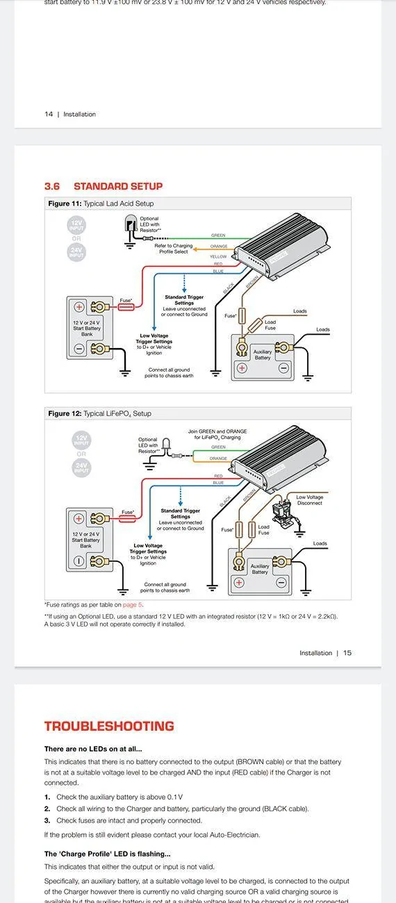

Here is the general wiring recommendation from RedArc
