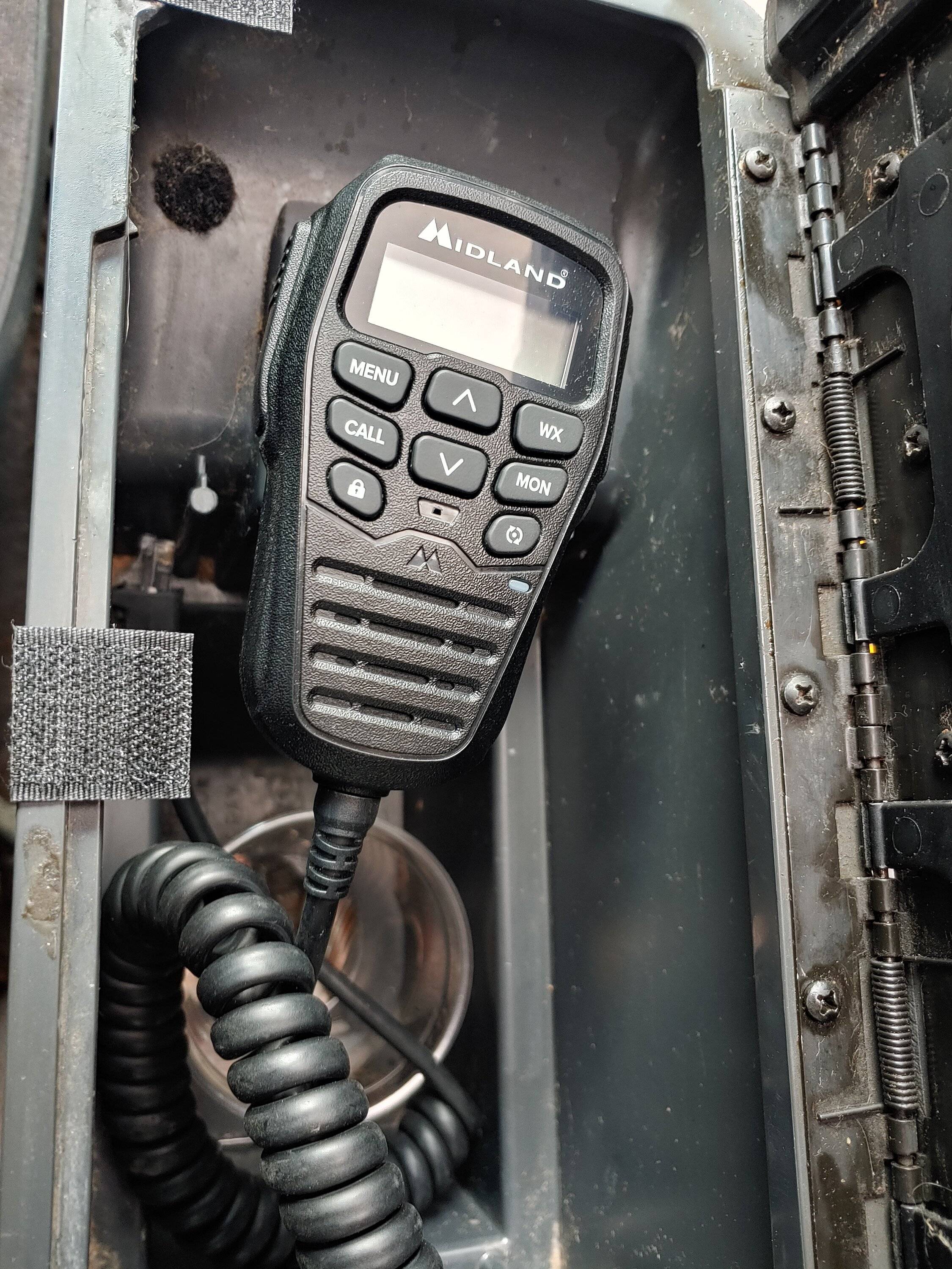

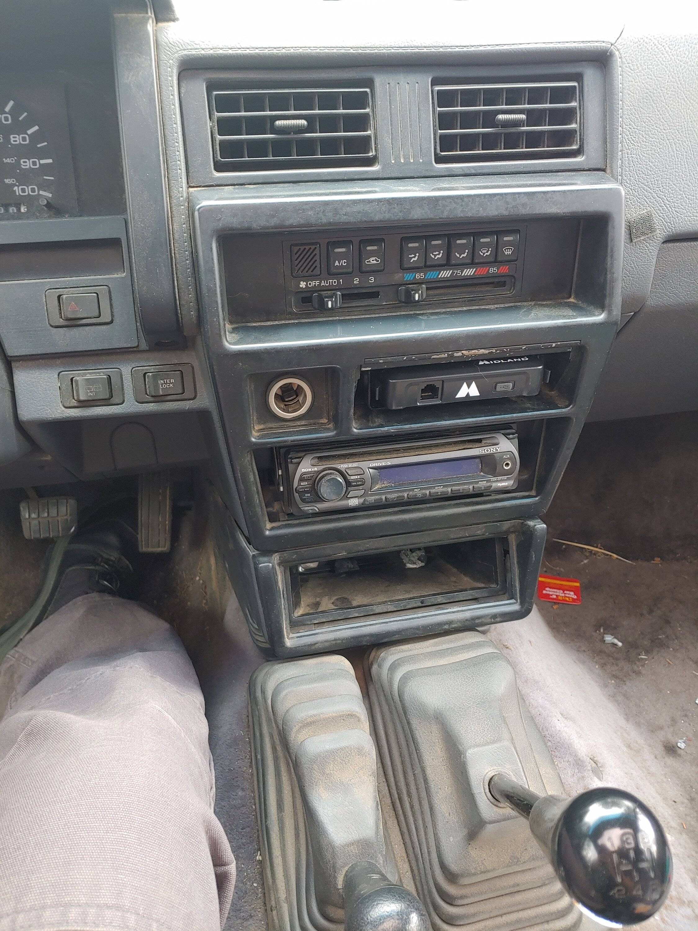

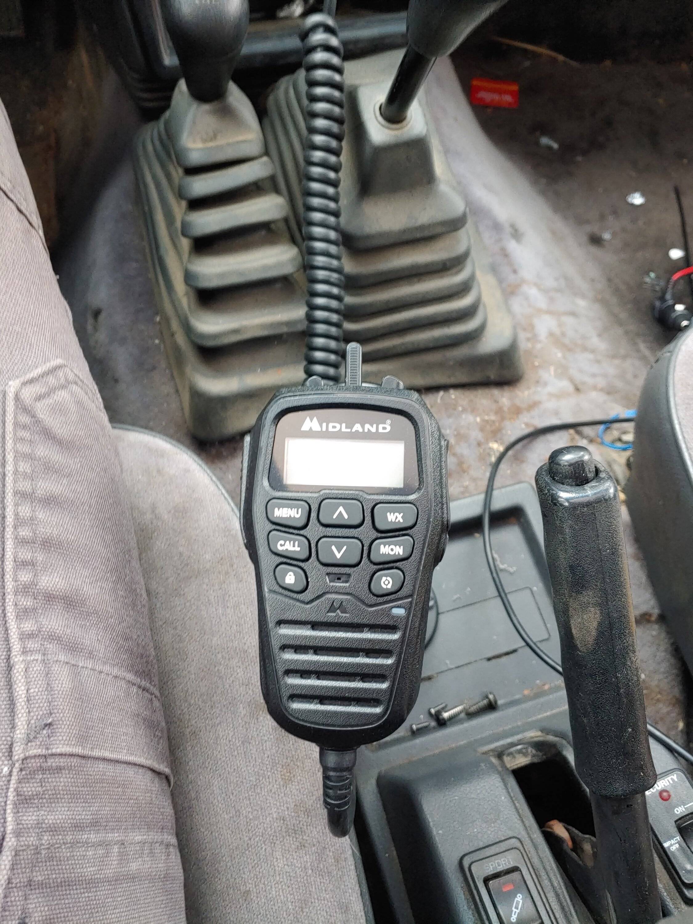

) . I ran my cables from the dash down and under both door sills and through the rear cab air vent to the bed, where I mounted it in the fixed portion of the Backflip cover. I will make a custom pole mount at some point. I also have the 1/4 and 1/2 wave dipole for it also, the 1/4 wave is shorter and good for like 3-7 miles, and the 1/2 wave loaded is taller and gives much better range. I really did not want to put a hole in the roof of my new truck, there are other options but I like simple.
