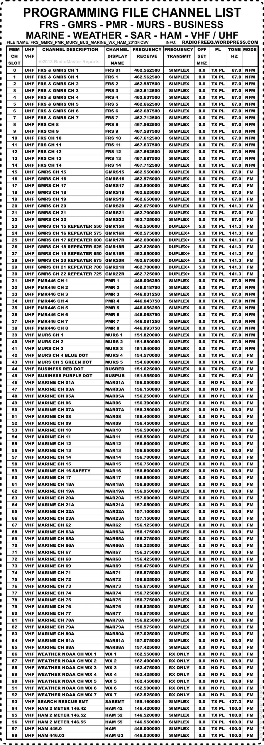

If your radio is programmable here is a good list you might find helpful.

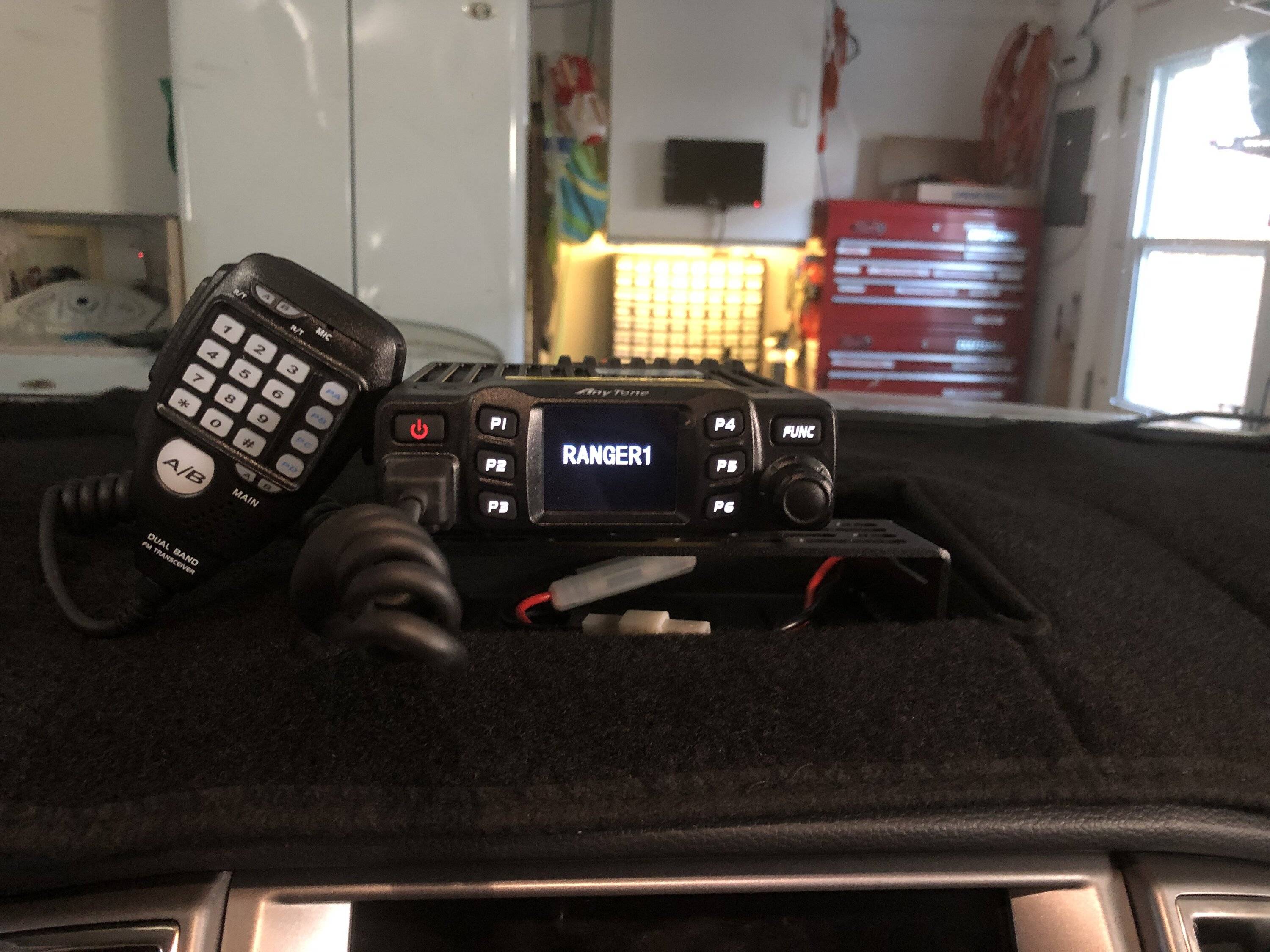

I'm thinking of getting that same radio, how are you liking it? Mind sharing how you've run the wiring & mounted the antenna?

I like it, it's not high end, and only 25 watts but plenty for what I use it for. I have one in my RV with a Ground plane antenna on the roof, with switchable 1/4 & 1/2 wave dipoles. I get about 30 miles range between the truck & RV not using a repeater, I have gotten 100 miles hitting a mid point repeater. It is dual band with a wide frequency range, so be careful what band you are transmitting in and with how much power. As its lowest power is 5 watts you are restricted from some FRS & MURS channels ( :lipssealed: ) . I ran my cables from the dash down and under both door sills and through the rear cab air vent to the bed, where I mounted it in the fixed portion of the Backflip cover. I will make a custom pole mount at some point. I also have the 1/4 and 1/2 wave dipole for it also, the 1/4 wave is shorter and good for like 3-7 miles, and the 1/2 wave loaded is taller and gives much better range. I really did not want to put a hole in the roof of my new truck, there are other options but I like simple.

Awesome info, appreciate it thanks! Did you run the cables through that tray or just across the dash? I think I'm going to pop the tray out to see if the wires could be routed neatly through the dash. I haven't decided on an antenna or where/how to mount it yet, definitely not going to be putting any holes thou.

I drilled a 1/2 hole in the rear right corner of the tray, (hidden with dash cover) from there it is an easy path down the passengers side behind the glove box to the kick panel and door sill. Pop the door sill and run the ant cable under that, I did have to loosen the B pillar cover to get it past the seat belt detractor. Get a solder on PL-259 connector and cut the one on the antenna off, makes it MUCH eaiser to run the wire, then just solder a new one on when the cable run is done. (of course you do this in reverse)
