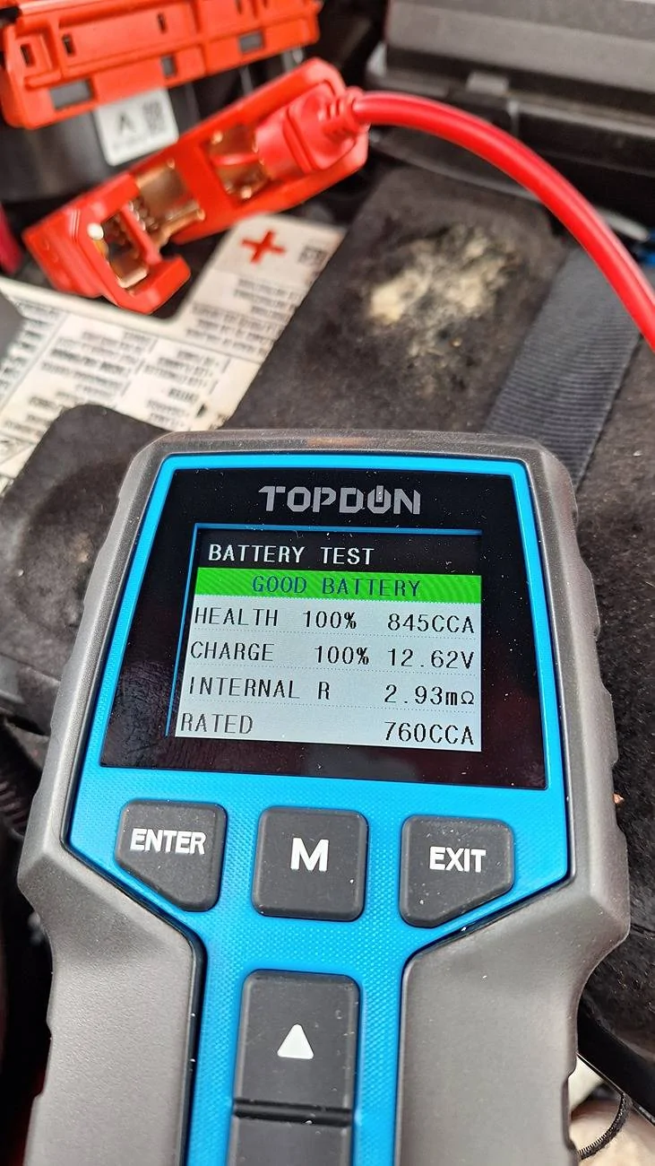

6 years on an OEM battery is probably a record breaker. IMO, time for a new one.
I have an April '19 build with 65,000 miles that is still on the OEM battery. I've got a voltmeter on the 12vdc outlet to keep a close watch on it as I know it's a short matter of time before it's done. But for the moment, it's still going strong.

I replaced mine in the middle of September. 2019 with around 44K on it at the time. I was getting the Sync message "start the vehicle, saving battery" or something like that. I always turn off the ASS as my pre-flight anyway. I wanted some piece of mind with hunting season and winter coming up.
