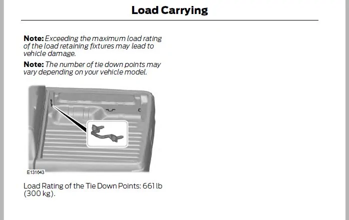

In looking into it I found another thread on here that says the factory tie downs are rated for 661 lbs. idk what they can max out at but I guess that would be the number to shoot for

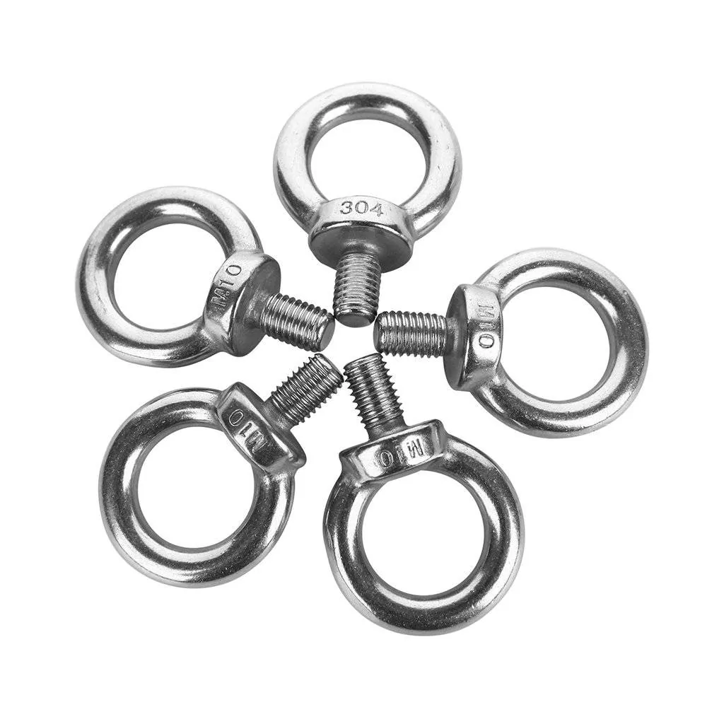

Google "footman loop" and take your pick...
Now that could be a option for sure. I never knew what they were called. now just to find them the right length. but who knows what those are rated? I just know I do not have the need to spend $80 for two tie downs.

Any idea of ratings? I was worried about just one bolt holding the item down.
Hi Buddy,
Without testing what it takes to pull through just one threaded hole in the pickup box, I think you can take the OEM tie down rating cut in half. Rating is 661 lbs for the OEM tie down so 330 lbs might be a good working number. I have several of these stainless I bolts and use them frequent more than the OEM tie downs of which I have six...
From the owner's manual
