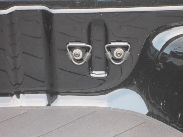

Press and weld set-up
If you're cheap like me this is under $20 for four. Amazon and Ace hardware. Looks like a robot face.
I'll be doing the same thing. The price ford wants for the correct ones is insane. Do you happen to remember the bolt size/pitch?

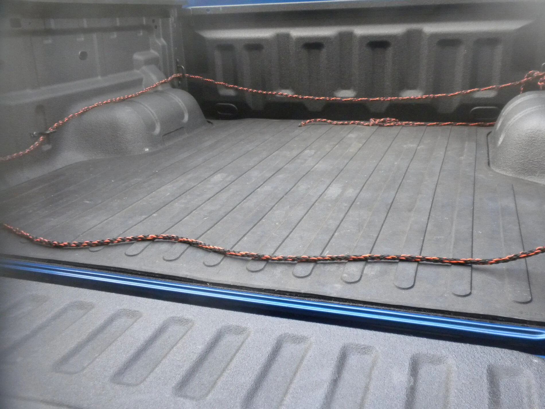

That is why I like my rope. No direct pull from corner to corner except thru my cargo net. Depending on load I will double up 5in hooks using the factory hooks on the corners to raise the net using either the net hooks or maybe one 5in hook for other connections. Also it gives me connections front & rear.
They are M8 1.25 pitch and pretty sure 25mm

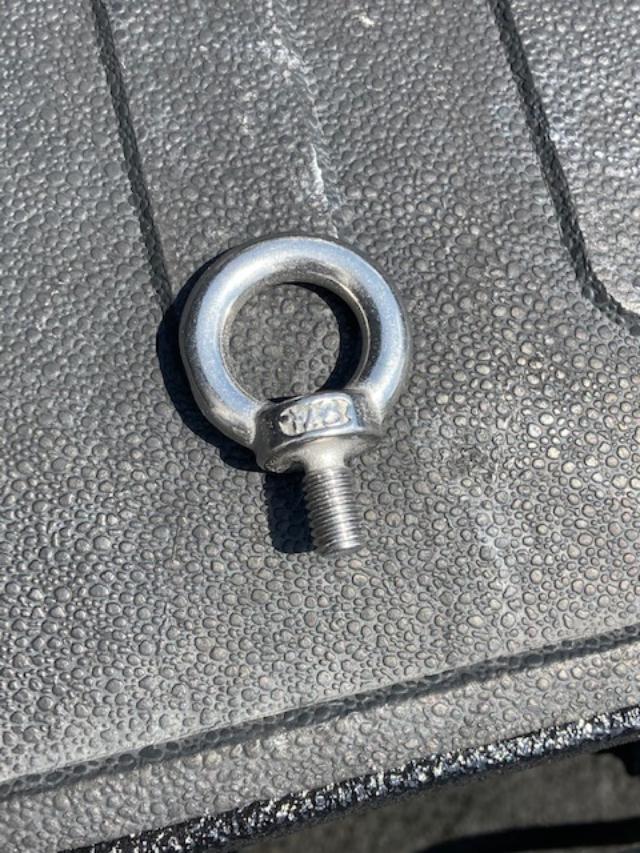

I bought these metric eye bolts on ebay or amazon last year they werent too expensive they are Stainless steel and fit in many of the threaded holes in the truck bed check your thread size

Hi Steve,
Got a link? Most of the threaded holes in the bed are M8x1.25 or M6x1.00

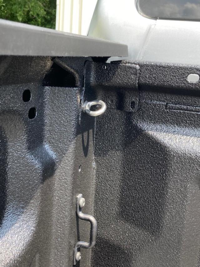

Hi Folks,
Just installed a few minutes ago. Threads in the location shown for upper and lower hole are M8x1.25. Had to drill out one hole caked with spray-in liner using a 17/64 drill bit before I could clean up the hole with my M8x1.25 tap.
