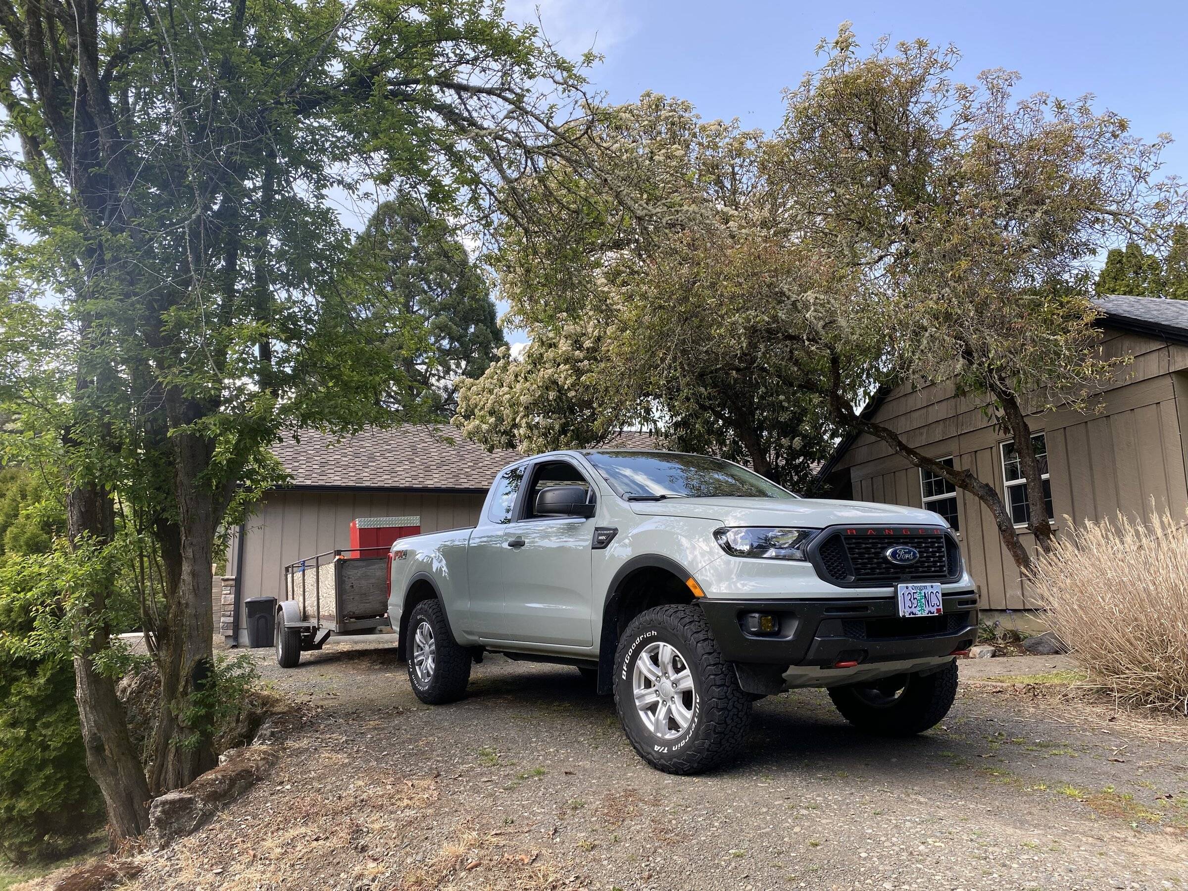

This is a slow build of my 2021 Ranger. I ordered it in June 2021 and picked it up upon delivery in September 2021. 6' bed supercab, Cactus Grey, 101A package, tow package, 110v inverter, FX4 off-road package, keypad, carpet delete, pretty much nothing else :) Currently just ticked past 13k miles. Wanted to document what I've done so far and what I'm planning to do in the future.
I am a big off-roader, and I do several "overland" trips yearly. My ultimate goal is to acquire a canopy shell to build an in-bed camping setup, maybe add some more lighting, make the suspension work better, and add more turbo noises.
Mods so far:
Ford OEM tri-fold cover - scored a new factory take off on CL for $450.
Spray-in bedliner - $500 i think. Was not a fan of the factory bedlining durability so I opted to have one done aftermarket.
FordRangerlifts 3" front leveling kit and 1/4" BORA front wheel spacer.
285/70/r17 BFGoodrich Ko2 (load range C). Would not buy these tires again, I had Falkens previously and they were a better tire in my opinion.
Huskyliners floor liners - Love these for dumping water out after poking around the woods.
Rokblokz Mud Flaps - These look great but I'm not in love with the mounting solution. Hard off-road use makes these come loose, I even had one fall off the truck on a trail once.
Rough Country Jeep Wrangler skid plate - Made for a Dana M220, bolts right on! :)
Diode Dynamics SS3 Amber Fog kit - These things rock. Dollar for dollar one of the best upgrades on the truck.
Raised "Ranger" letters on the tailgate
Custom painted factory tow hooks red
Red "Ranger" letters in the front grille
Stubby antenna from Amazon

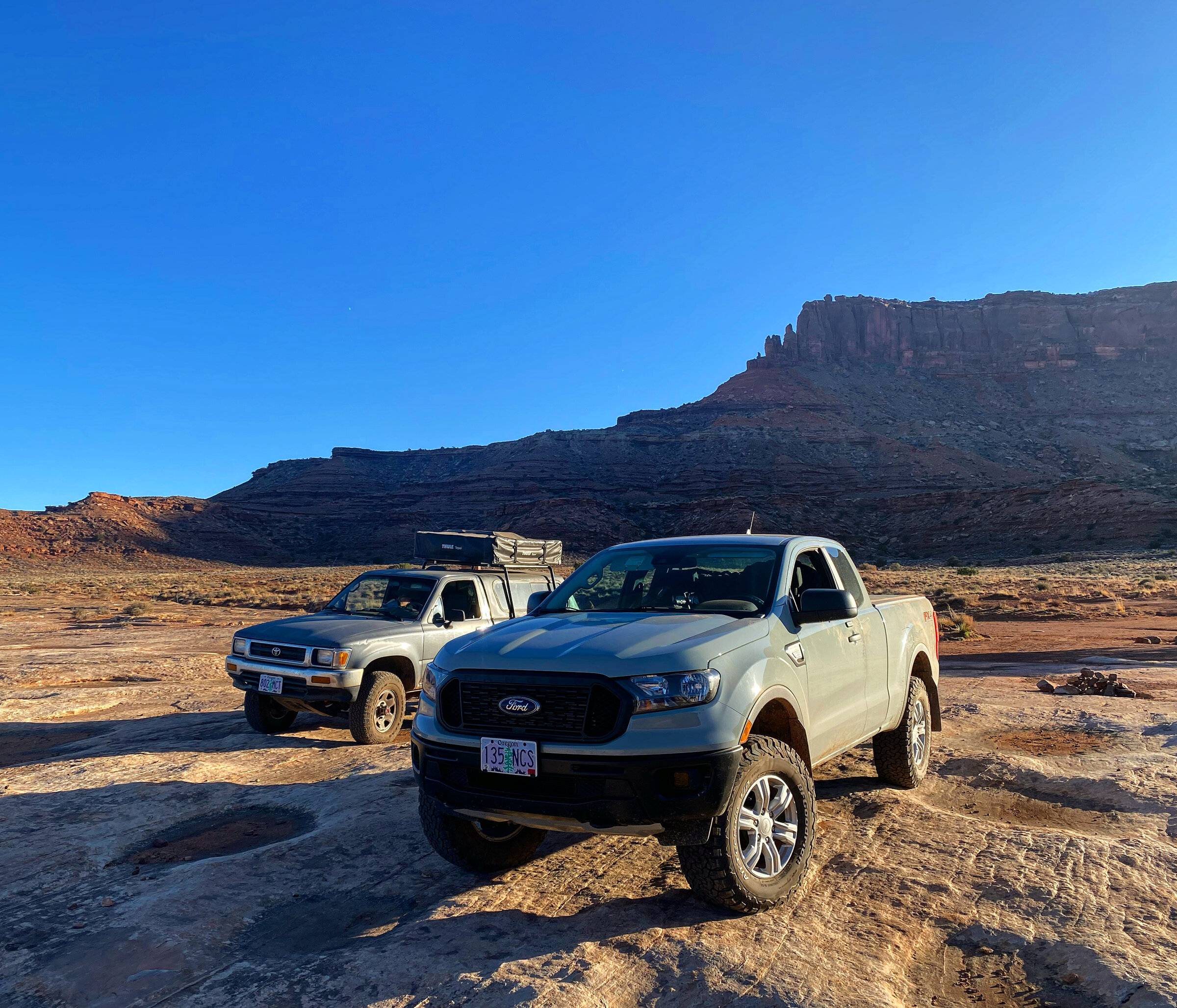

Check the video below to see the truck in action in Moab this spring. I've also attached some pics of the truck at various points along the way since I've owned it.
