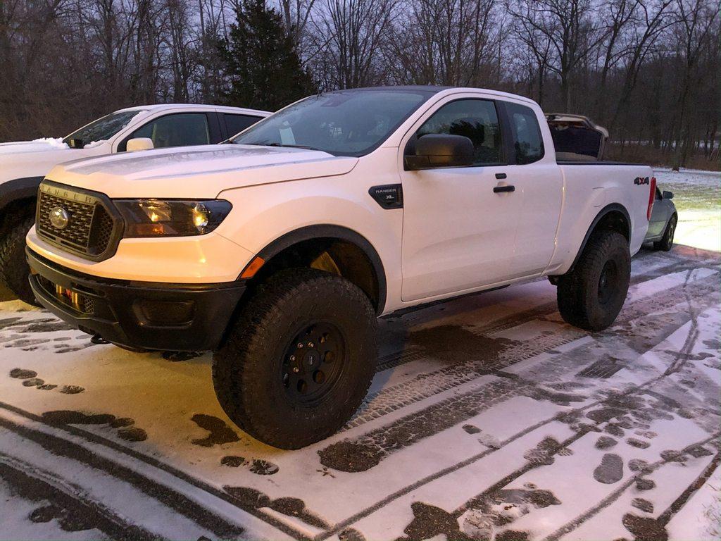

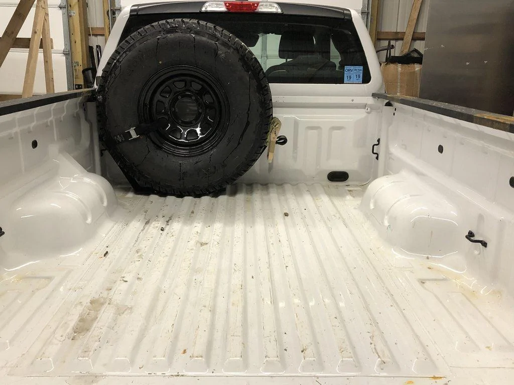

Quick update on the truck. Here is how it's sits currently, unwrapped and with a bed again.
Also got the spare tire mounted with our new In-bed spare tire mount that is now available on our site.

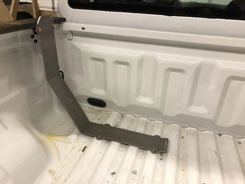

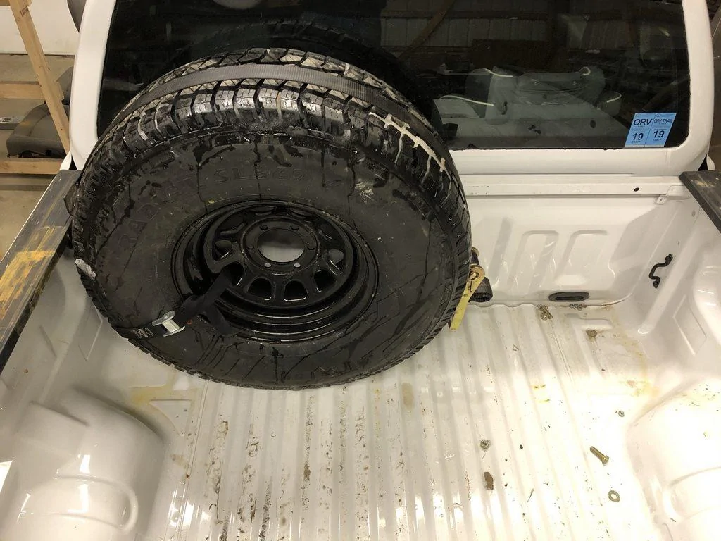

Did you consider mounting it in line with the truck, against the rail, so it doesn't obscure rear view mirror?
589FAB
589FAB
Thomas
Sep 29, 2019
132
Fenton, MI
2020 Ranger SuperCrew XLT
Oops! I always forget to check this forum!
You can install it that way, as we do that with our Colorado mounts too. You will need to install two more riv nuts up into the bulkhead of the bed. You also need to slightly bend the mount as you install to get it to line up, as the holes are a little high for that configuration.
