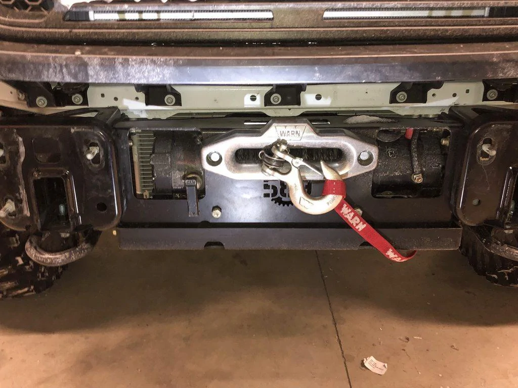

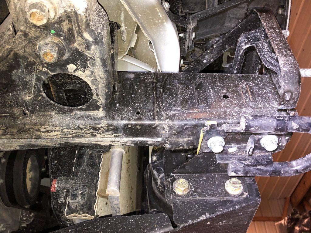

I took the bumper off real quick to grab some more pics. When I get some mounts back from the laser cutter, i'll get some pics off the truck.
Sorry for the dirty truck, hard to wash it when its 20* out.
Here you can see the full mount. It has the two large holes to allow air to pass through, and allow access to the winch clutch lever.
Now you can see the top side of the mount and see that it is a formed 3 sided box. This really adds a ton of strength.

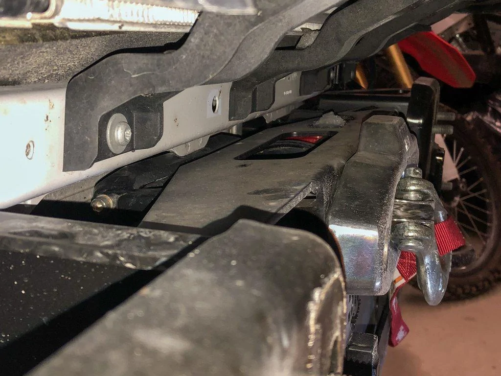

This is from the passenger side, looking up. You can see the lower bracket that ties into the factory Tow hook mounts, and a triangular upper mount that ties into the back side of the frame horn. All factory hardware attaches the mount to the truck.

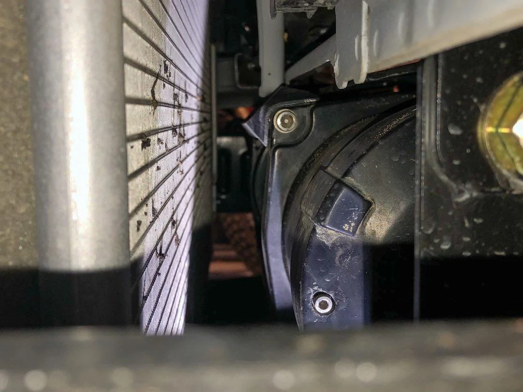

Here is the clearance between the winch and the radiator/condenser. The intercooler is mounted on the topside of the radiator and not affected by the winch.

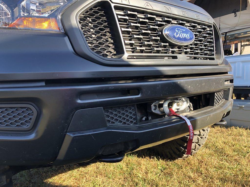

Hopefully these pictures help you guys out! We have decided that this mount will now include powder coating for the existing price of $499.99 + shipping.
Excellent pictures thank you! It fits like it's intended to be there. I appreciate that you will powdercoat the mount.
