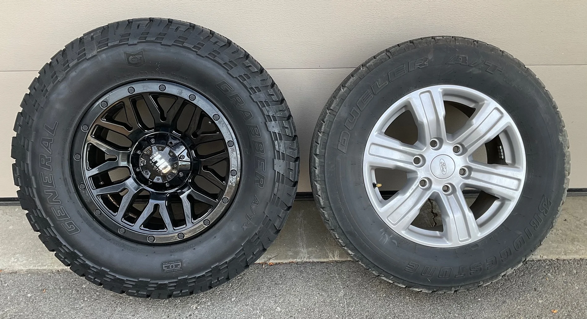

You should be able go up to 275/70R17 (32.2”) without rubbing on crash bars or wheel liners if you keep your offset to +25mm or greater. They also won’t stick out too far and will likely come up flush to the wheel lip.
Those Black Rhino wheels in the pic you posted are nice and look a bit like the silver wheels that came with my XLT. This pic shows those wheels and also how much bigger a 32.2” tire is compared to factory 255s.
I think I got the tire size just right for my Fox shocks set at 2” but I might have gone a touch low on the offset of the wheels at +15mm. It was very close to rubbing on the crash bars even after I removed the plastic covers from the fronts, loosened the fronts and rears, angled them out of the way, and gained 1/4”. Just to be sure, I installed the ReadyLIFT anti-intrusion beams - it’s a bit of work. With +25mm or higher, you can likely avoid this extra work and expense. This pic was taken when the flares were off and it shows how much poke my truck has at +15mm with my 275/70R17s. Those Black Rhinos would be pretty much flush.

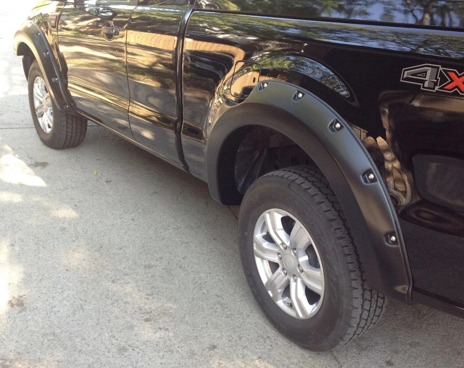

They stuck out enough that mud and stones were an issue. I have deep pocket style fender flares but a slimmer version would do the job just as well and look better. My choices for fender flares were limited due to it being a SuperCab because some (not all) rear flares have a flat spot at the front of their arch to account for how close the SuperCrew cab and rear wheel are to each other. You can see it in this pic.
It’s too bad Ford stopped making the Tremor wheel trim pieces - they would look great on your truck. Also keep in mind that deep fender flares with OEM offset wheels (+55mm) will make your truck look like it skipped leg day.
Here’s a pic during fender flare installation, moments before the new wheels and tires were installed. Yep, looks goofy.

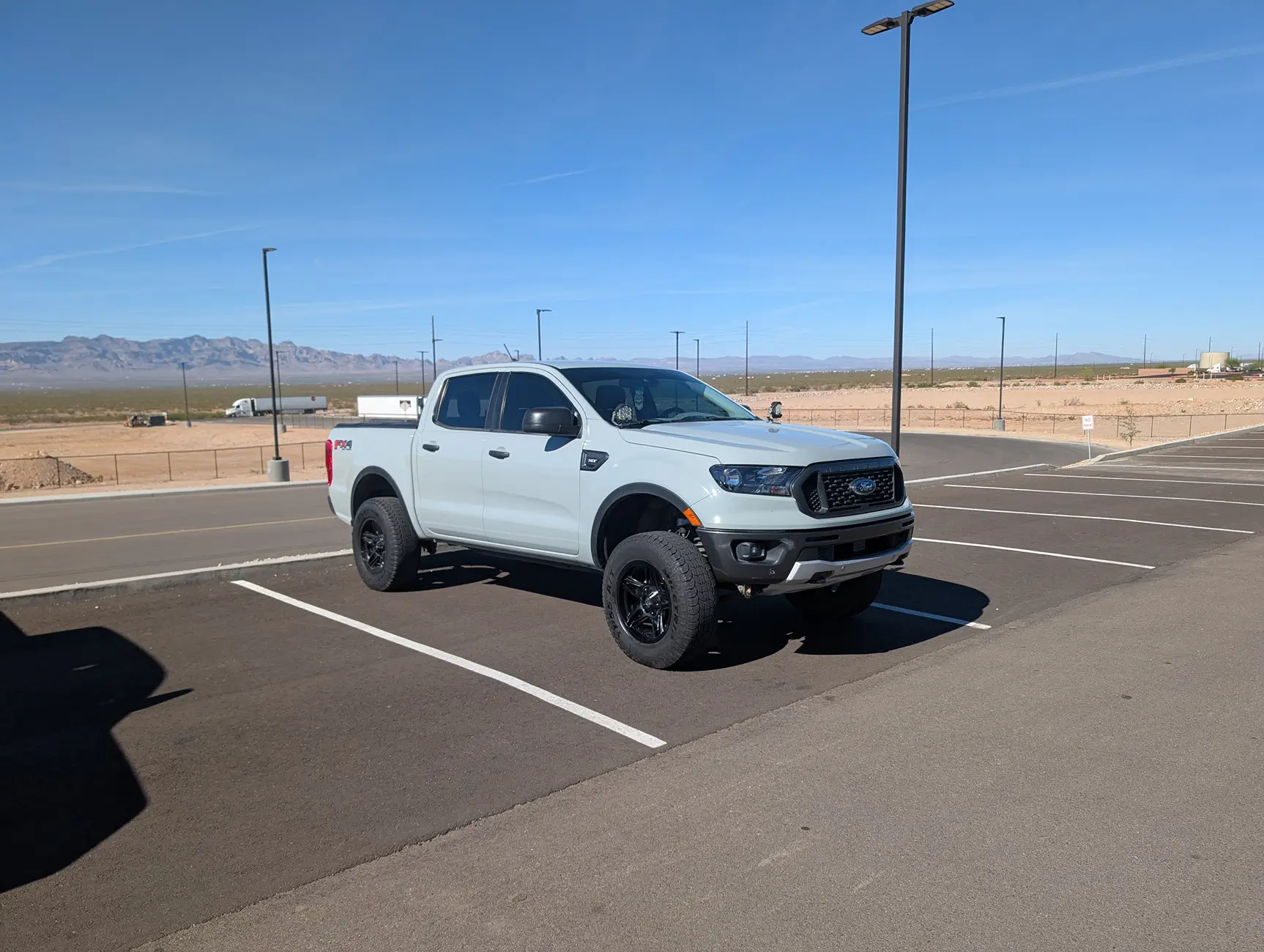

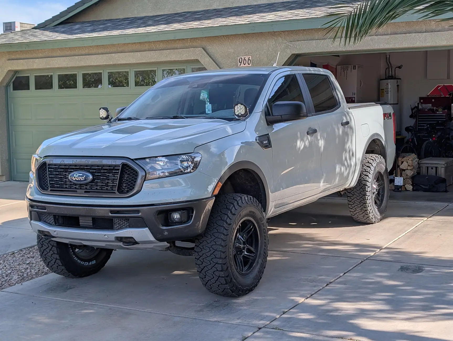

Go for the 17's. They'll give you more tire options and a more comfortable ride both loaded and unloaded.
Food for thought; Black wheels are not easy to keep clean, especially if you live in a dusty or muddy environment. Every time the sun hits that gloss/semi-gloss paint you're going to see the dirt and brake dust caked on. Grey/Silver/Bronze will "look" much cleaner regardless of how clean you keep them.
For some additional context making your decision, here's a set of KO3 285/70r17s on some 17x8.5 -10 American Outlaw Lonestars. Just got these tires a couple weekends ago.
Going up from a 265/70 to a 285/70 tire with that low of an offset required a considerable amount of cutting on the front crash bars and the rears to be notched. Otherwise, I was rubbing at ~1 - 1.25 turns on my steering wheel.
New: 285/70r17s
Old: 265/70r17s

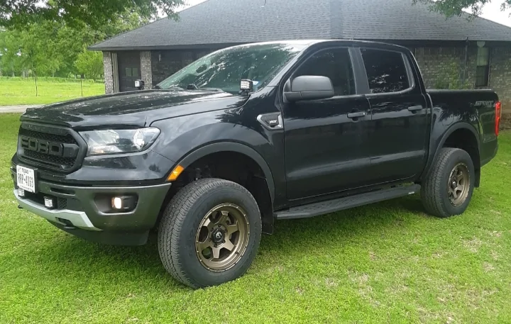

Here is my truck with the Fuel Shok bronze 17x9 with the +20 offset.
Reality check.
My truck is...
On road 99% of the time
And off road 1% of the time.
After the ATs wear out. I'm going back to the Goodyear Wrangler Fortitude HTs that I was running on it when I first joined. They are good all season tires for the changing weather conditions.
