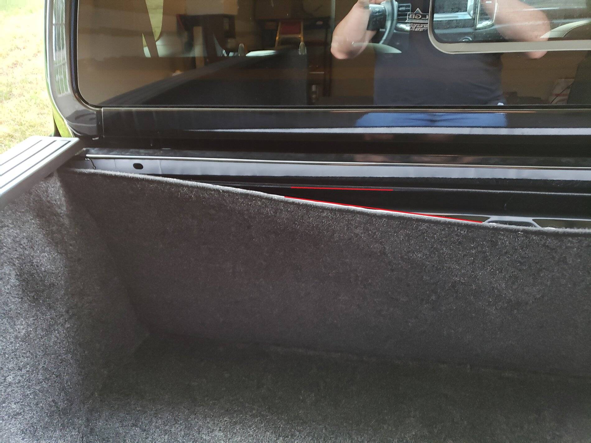

This was install day, several months ago. I put the front up near the top of the bed. On the tie downs-you can cut a slit and poke the tie downs thru or you can remove them, poke two holes for each, and reinstall them over the bedrug.

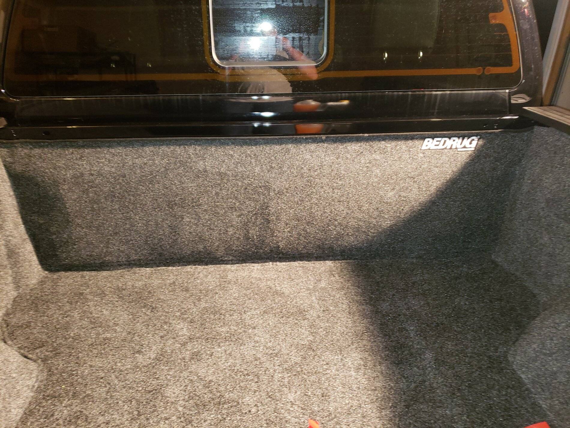

I originally thought i'd attach like that but i just did it on the front and I am pleased with result. Next post is a picture. And thank you for posting your picture!!

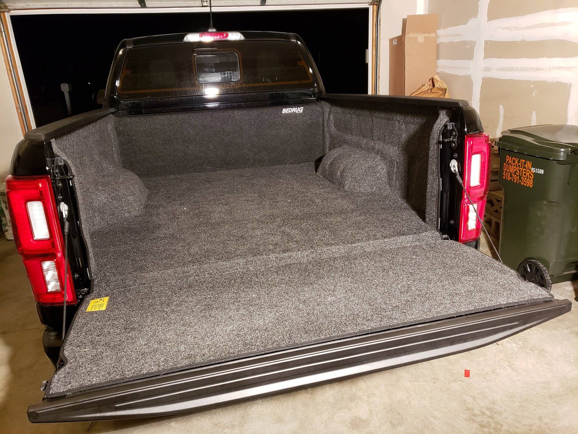

Yes i did this at 11PM EST .... lol neighbors must think im nuts. I am in garage with door open and truck half way out...
What I did is, pull a couple inch of backing off the tape, stuck it on the corner and push in the rest of the edge in and pull tape and press it onto slanted side, and keep pulling tape and pressing the edge. worked out great.
Now I gotta go back out and do the sides.... and tailgate.. ugh this is like a 10 hours job to me... lol. I"m so anal about this.

Completed.... two small issue.. one is the passenger liner wall near the front keep popping out, I can press it in and it's perfect but it kept popping out.. know any fix except putting double sided velcros on that side?
Other is the velcro can be seen at rear of the truck. No biggie, I am very happy the way it turns out.

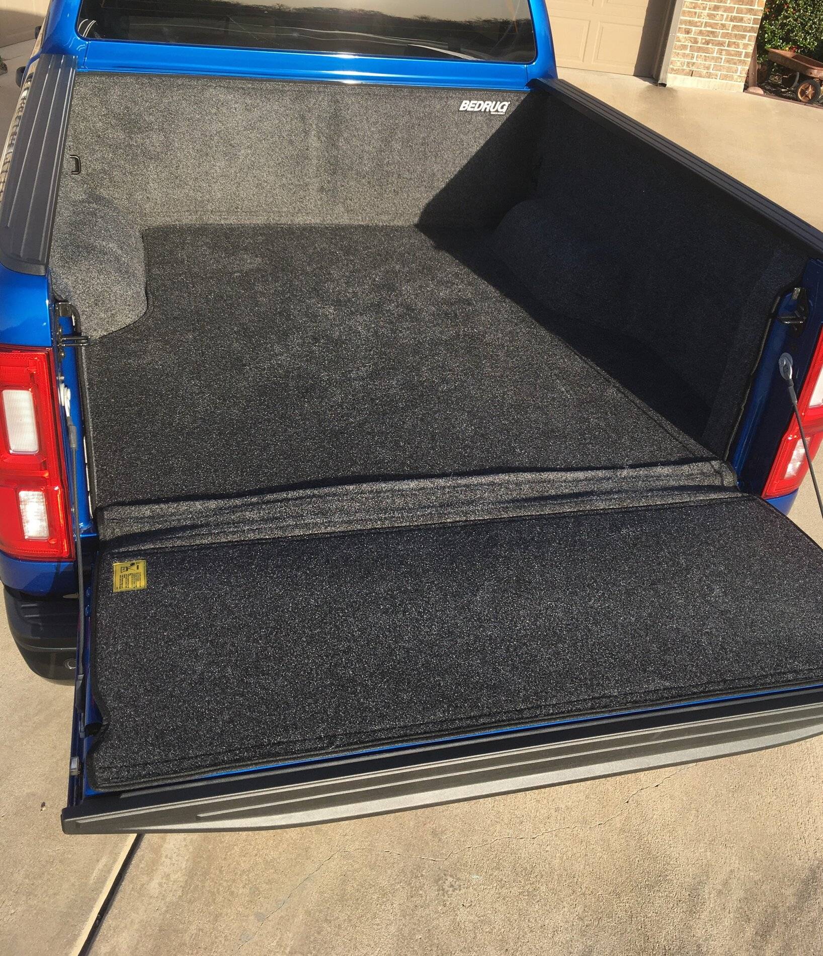

Came out great.
Sorry about yesterday, but my frustration level was thru the roof. How could bedrug.com not know wth was going on with that damn zipper?
It's never coming out, so instead of cutting slits in it, I just poked holes and ran the bolts thru it. Gives it more if a "finished" look.
I also bolted the tie downs right through the BedRug. And I also found it frustrating to get in. Not hard, just cumbersome and a big PIA!
But I like it and am glad to have it, seems to work great so far.

I pushed that tape onto the sloped area just under the top. The thing has enough stiffness that I don't think you can really install it wrong. I do wish it would less "baggy" but once in, it looks great!
I used an awl on a pocket knife to find the tie down holes and just screwed them on through the BedRug.
Ain't know way that the BedRug will ever fly out! That said, I know some of the tape is barely sticking on to some spots but it's in there.
