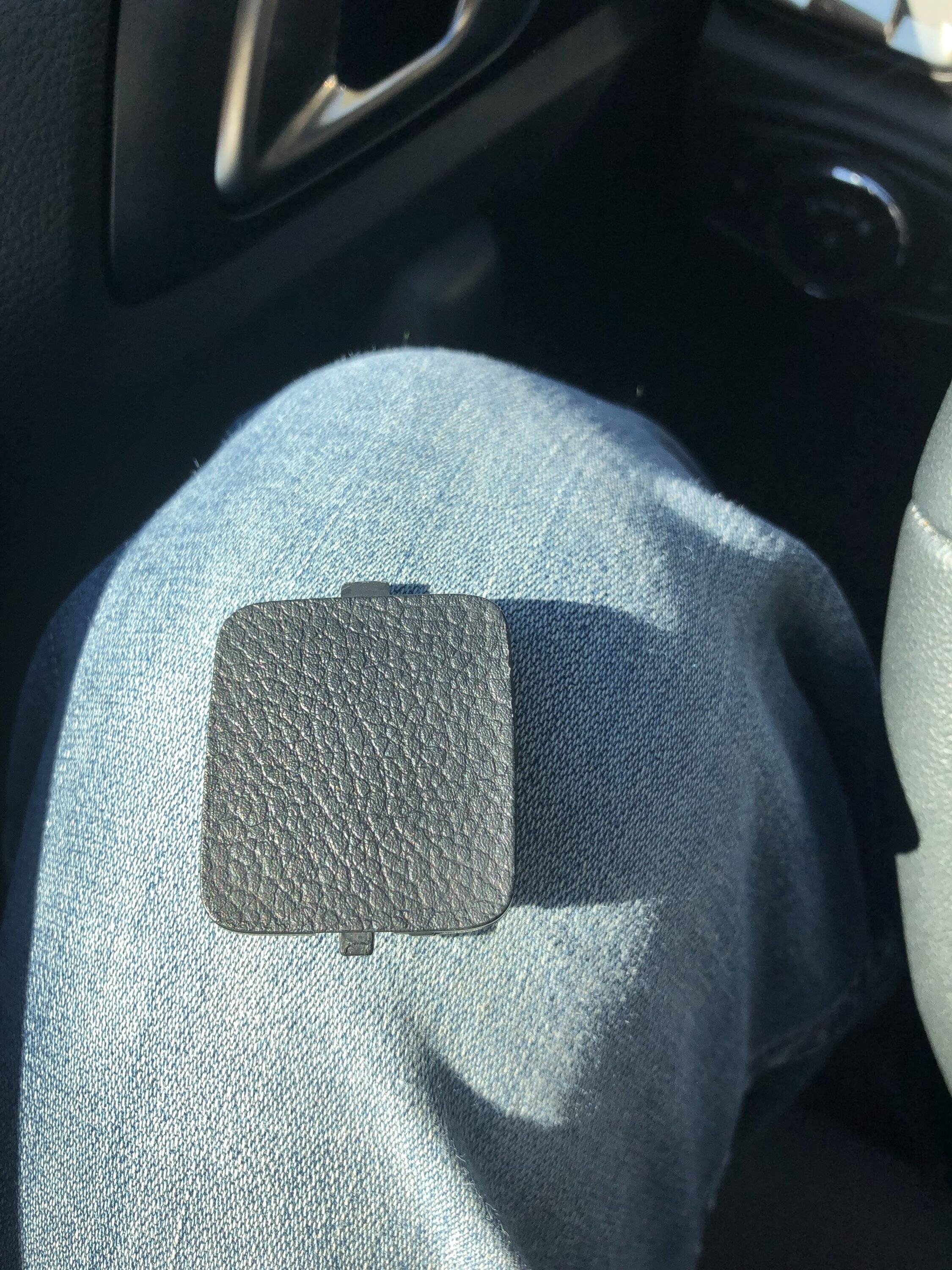

They dont go on the floor of the back of the front seats to help cover up these bolts. That got vacuumed up at the car wash.
Soooo......just send it to me in texas. Ill pay for shipping. Message me for address
Did they really get vacuumed up?!? o_O
I can confirm that the OP's piece is the seat bolt cover because I had to pop mine out to install Seat Jackers.
And I think they are different sizes from front to back.

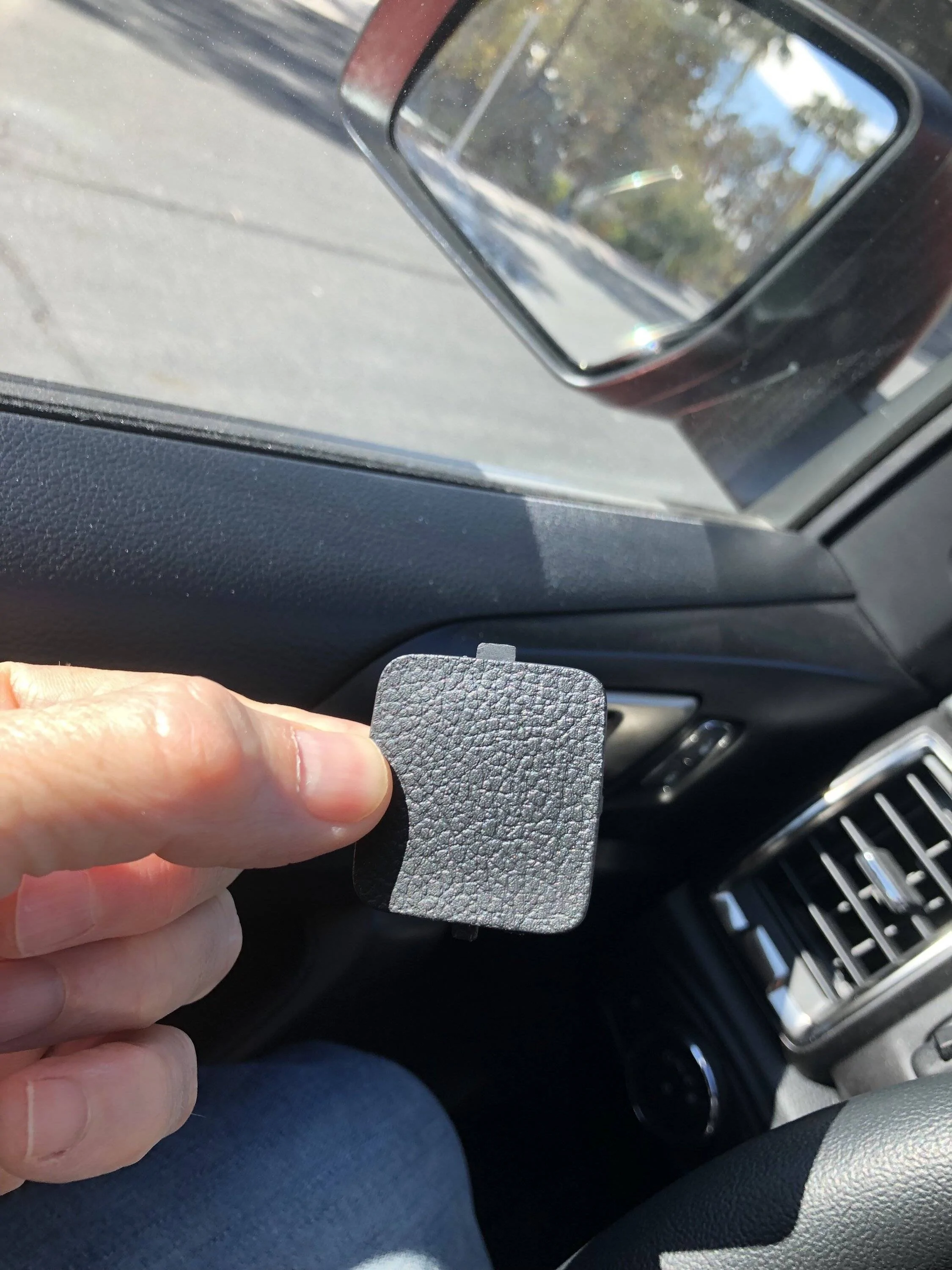

I have a 2023 Ranger Tremor and I found this on the floor of the truck a week ago. It clearly belongs to the truck, but I can't find the hole that it snaps into. Can anyone here help?

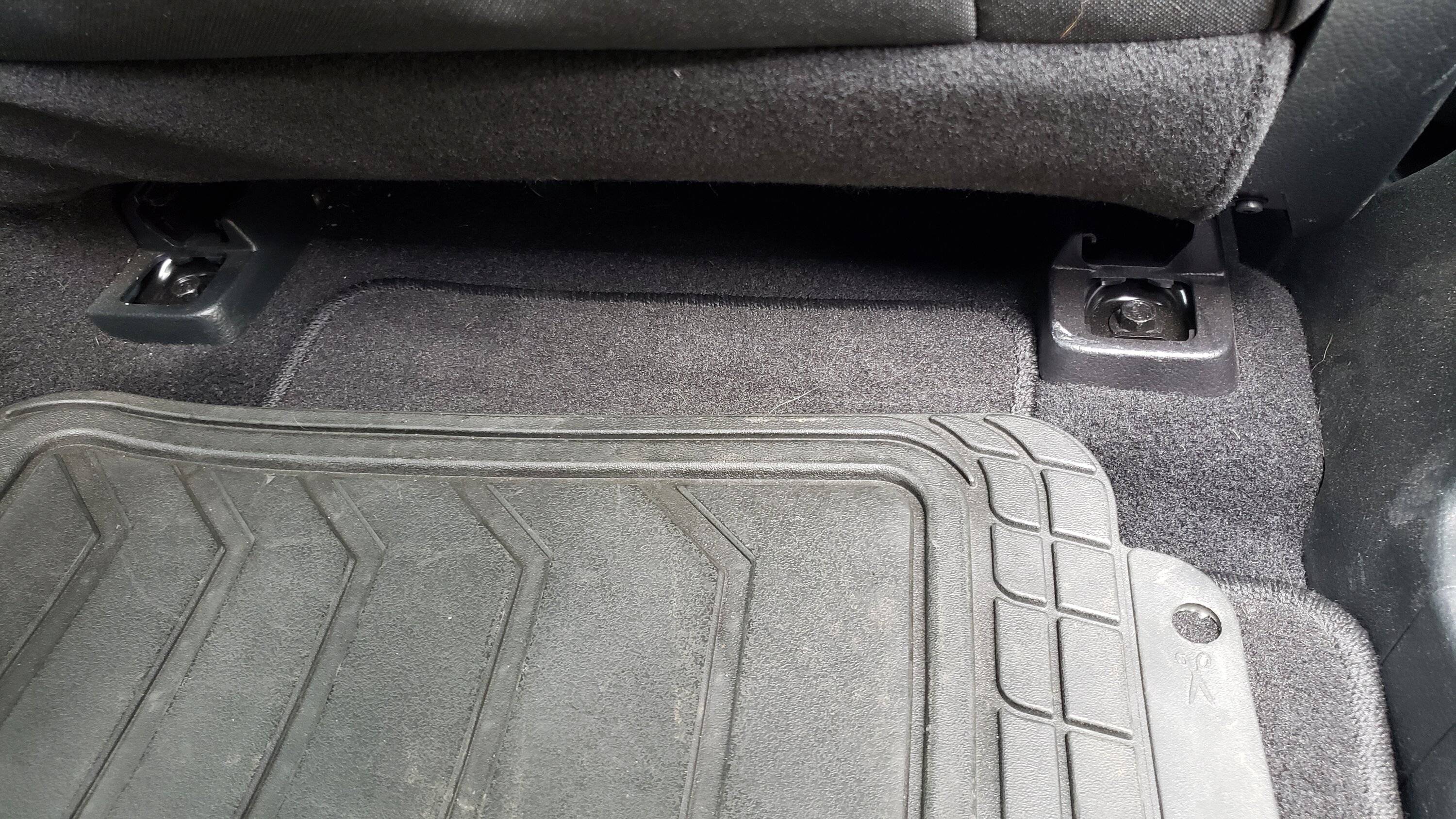

seat bolt covers look at the tracks

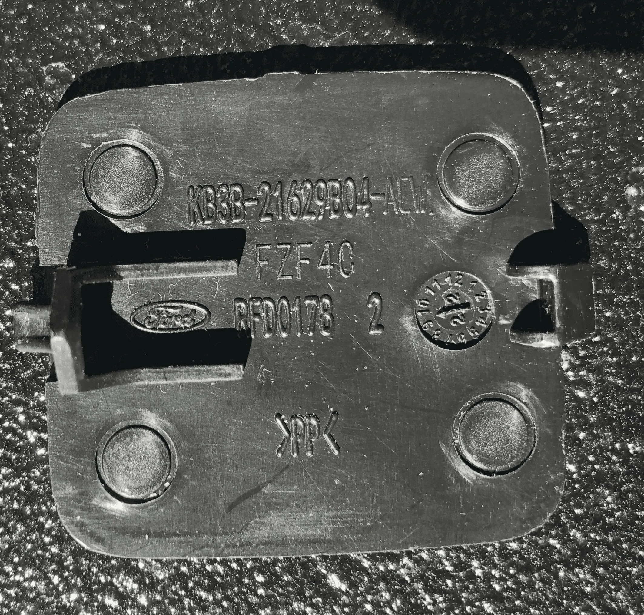

For some reason, Ford likes to give everything two part numbers; An internal (Engineering P/N) and an external (Service P/N). The molded-in P/N is the Engineering P/N.
This is correct. There are actually eight of these per vehicle. They cover the mounting bolts of the seat tracks. Four each for the driver's seat and front passenger seat (front/back and left/right).
Hi DK,
Yes...the Engineering Part number and the service part number do not always agree. Engineering part number differs by the last suffix ALFA letter based on a revision. A substantive change might affect the part number by the first Alfa letter... Service uses a single digit and usually a Z in the part number...Reason old part number and new engineering part number are interchangeable and does not require part stockage of both part numbers. In other words the old part is still good to go, ie interchangeable for function/appearance!
Make sense?
best,
DaveT
best,
Phil, do you see a service number here? Because I'm sure I'm gonna need some of these in the future!
Hi Dave,
It can be cross referenced by the Dealer. Likely it will start KB3Z... There may be several engineering part numbers associated with one service number.... Confusing?

Very easy way to prevent them from comming off....
Get 8 Ford Bed Tie Down's...2 per cover.
Bolt a tie down to each side of the cover, making sure bolts go thru floor.
Then simply use some 1 inch wide ratchet straps to keep them in place...
Easy Peasy !!!
