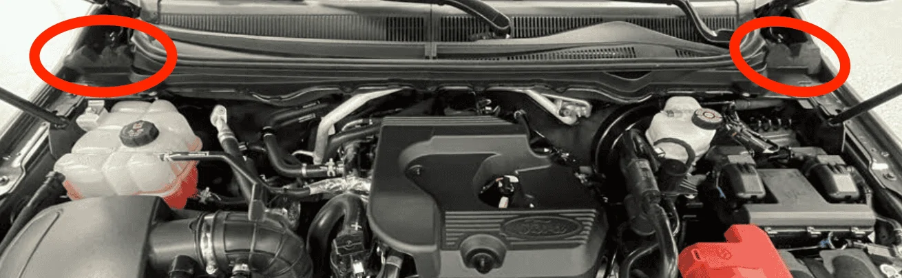

I just picked up a 2019 Ranger Lariat and these foam gaskets near the hood hinge are all tore up. Looking at parts sites I'm not finding them... Anyone know what these are called?

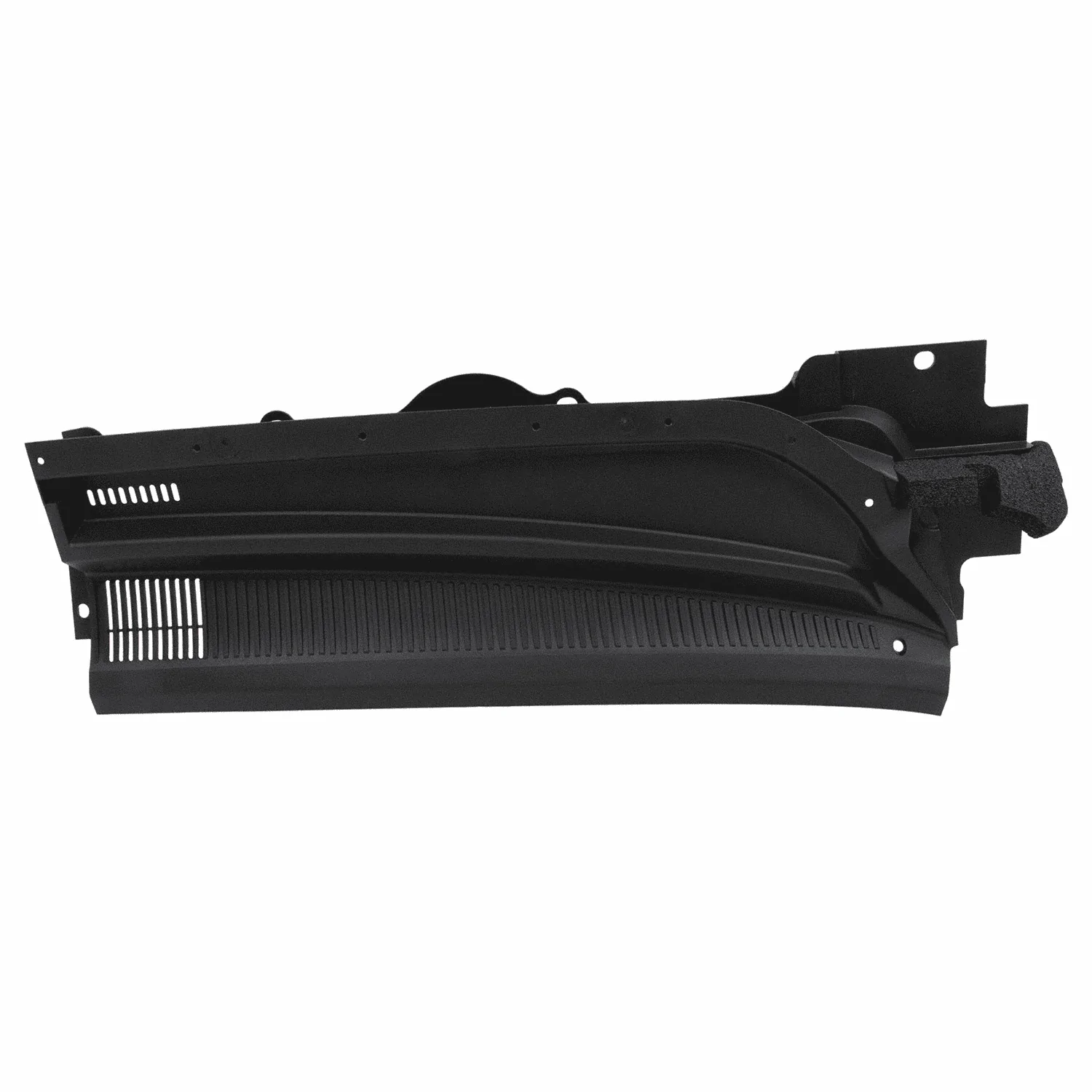

I am sorry but it appears these are only serviced with each cowl side assembly as shown below
Here are links if your interested and for future reference
Left Side
https://parts.levittownfordparts.com/oem-parts/ford-cowl-grille-kb3z21022a69a
Right Side
https://parts.levittownfordparts.com/oem-parts/ford-cowl-grille-kb3z21022a68a
Please let me know if you have any other questions.
Left Side
Right Side
Thanks,
-Benny
Are there any "clips" on the bottom-side?
Do you have a "parts-bag" for the plastic-clips that press each cowl section?
Reason I'm asking, Is I had to have the windshield replaced & both side cowl sections are loose and they won't snap down tight. I keep trying to press down when I have the hood up.
Any suggestions?
Any suggestions?
Hi,
I do not show any clips on the bottom side, Only these that go through the part itself
https://parts.levittownfordparts.com/oem-parts/ford-cowl-grille-rivet-w715256s300
Please let me know if you have any questions.
Thanks,
-Benny
