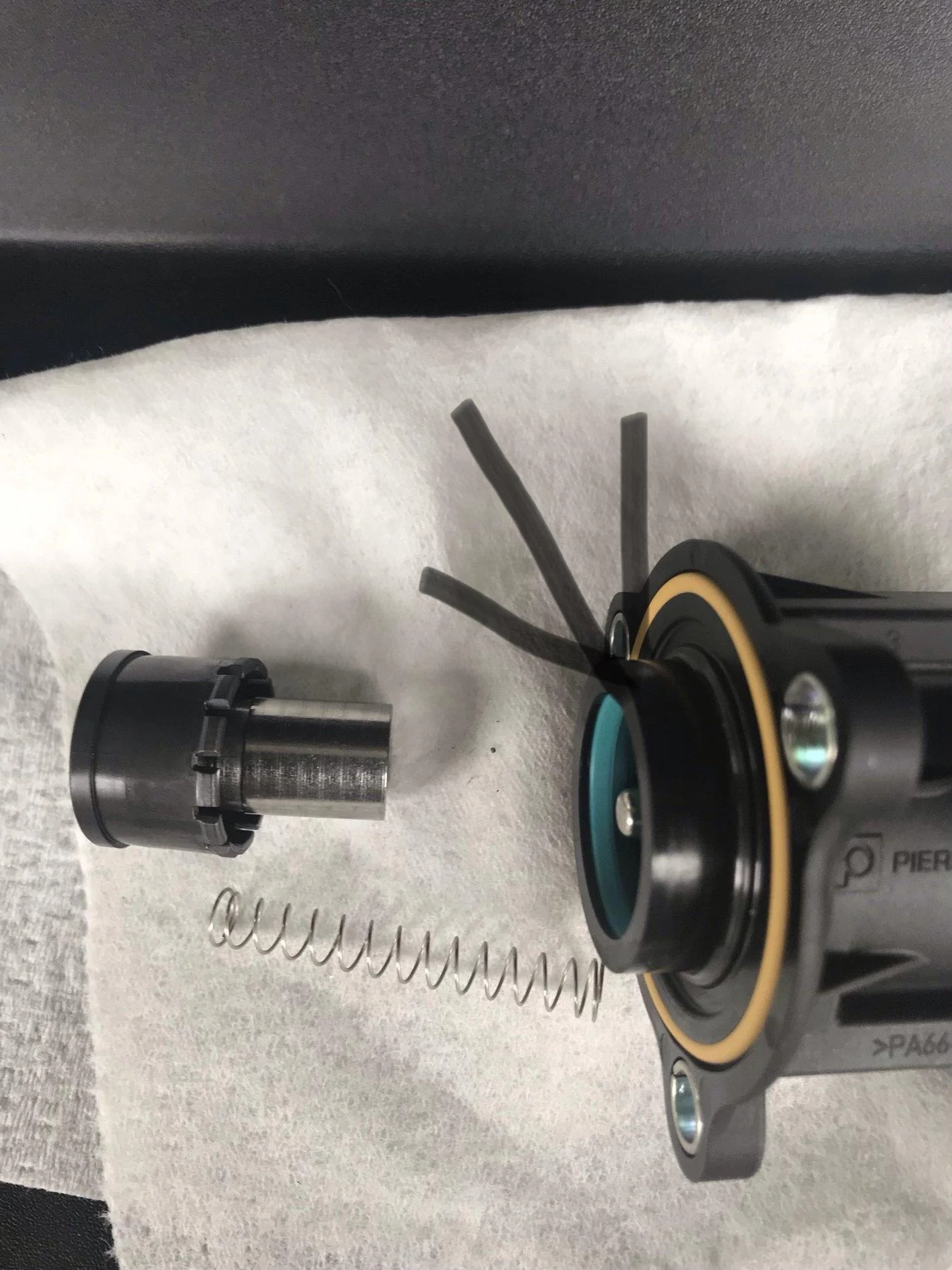

I need to make sure of something that appears obvious.
This part I have the arrow on also comes out?
Feels like a tight fit. Don’t see how it would fit otherwise but it’s snug.

That's the crackly part I mentioned that is removed with pliers.
