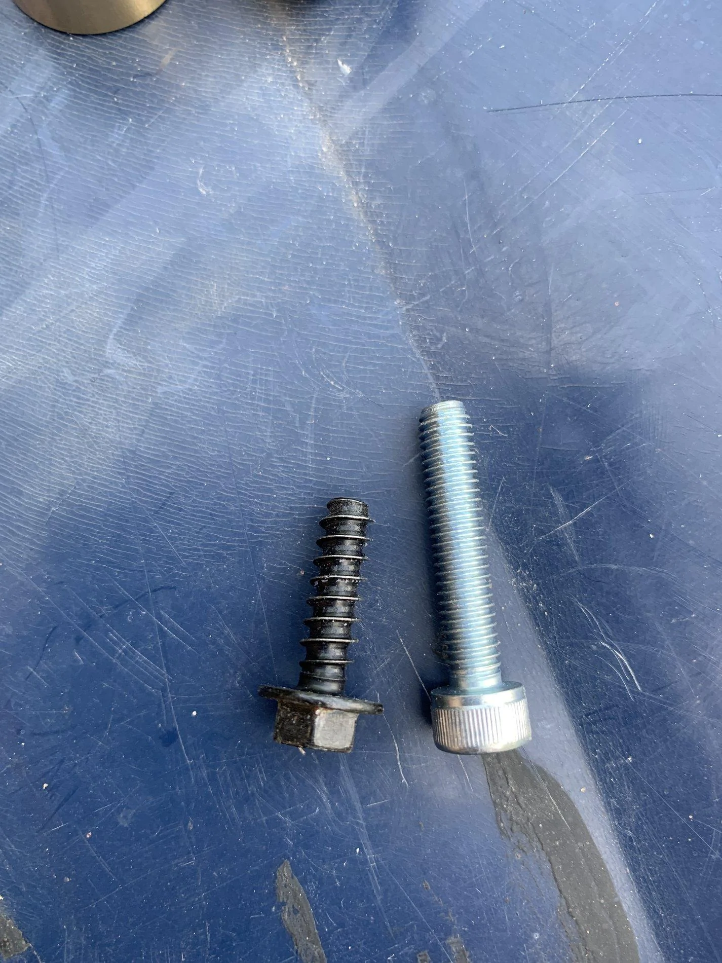

The provided bolts are not like the originals. Am I missing something?

Just use the new ones. The base is plastic.

I uninstalled mine today and returned to the factory valve. I had installed it when I had less than 100 miles on the truck and I never got to "know" the truck without it. While the DV+ makes the throttle slightly more responsive, I think it also makes acceleration choppier so i want to test to see if that proves true. The stock screws with the course threads went back in fine but I don't think it would take many switches before the holes would get boogered up.

I am going to install without the main spring and run that way for a while and see how it compares to stock before going to “sport mode”.
I was concerned about how many times I would be able to use bolts vs screws.
