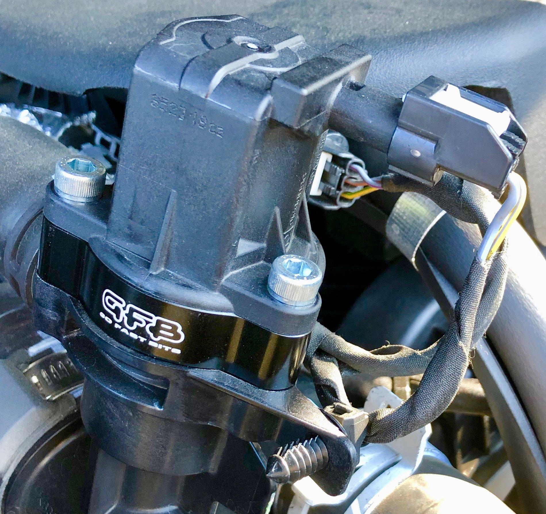

Fast shipping and 10% discount from Panda Motorworks....installed today in about 15 minutes start to finish.
Didn't even disconnect the electrical plug, just took out the stock screws, flipped it over and put in the new Go Fast Bits.
As suggested, put a light coat of Mobil 1 on the new piston prior to bolting it all back together.

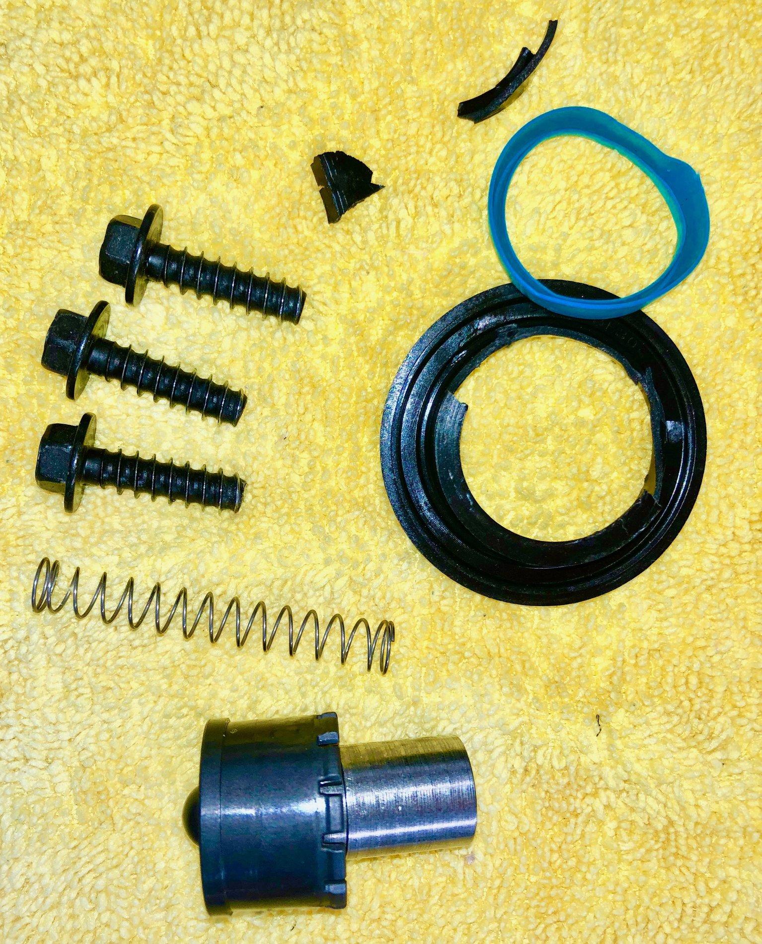

The stock ring that needs to be removed is "crackly" indeed...mine cracked as I tugged/twisted to get it out. Almost freaked out...but then just kept going. Not likely we'll be going back to stock.

Received at local UPS today and installed in about 10 minutes
No joke; I think it took me longer to retrieve it from the porch (where Brown Santa left it), unpack it, unbox it, and go over the instructions, than it did to install it. I didn't even break the crackly bit. On the bike today so I have no input on drivability, but I did stomp the pedal a few times in the garage-- Love the PSSSSSSHHHHH!

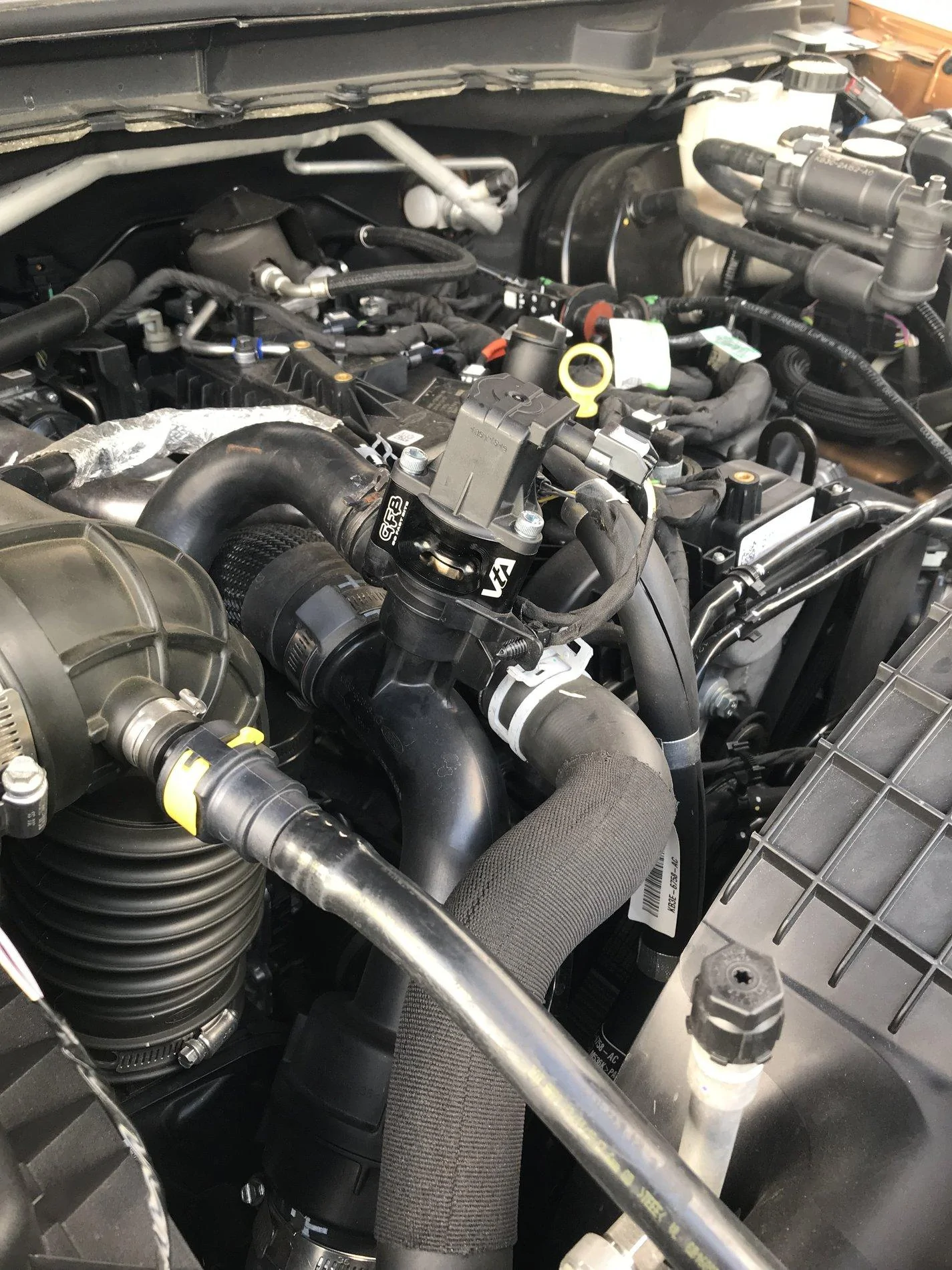

s. Super easy swap out, and what an improvement in throttle response. And the VTA is awesome, I can finally hear that little turbo kickin!!!
Love that you are enjoying this!
