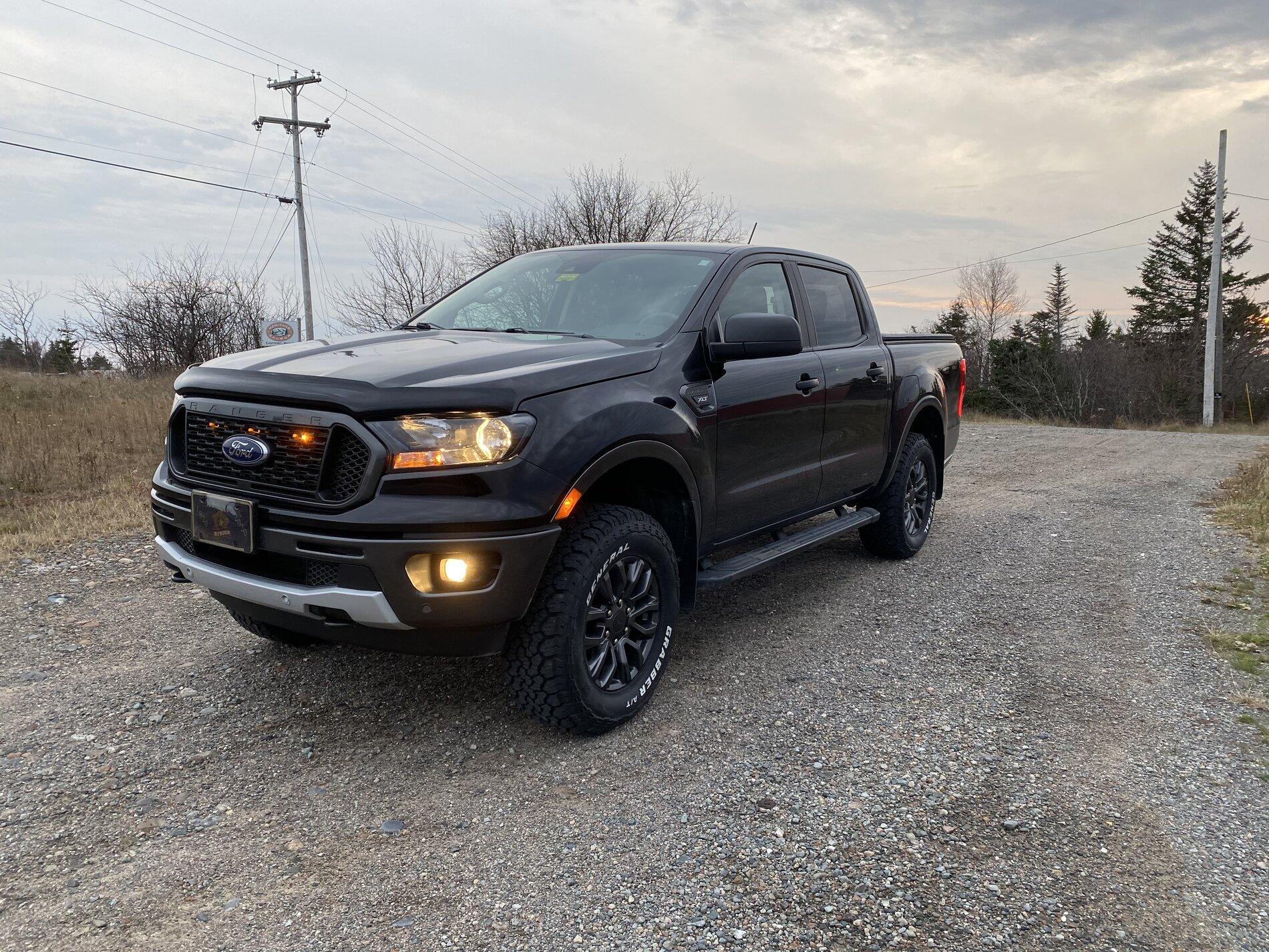

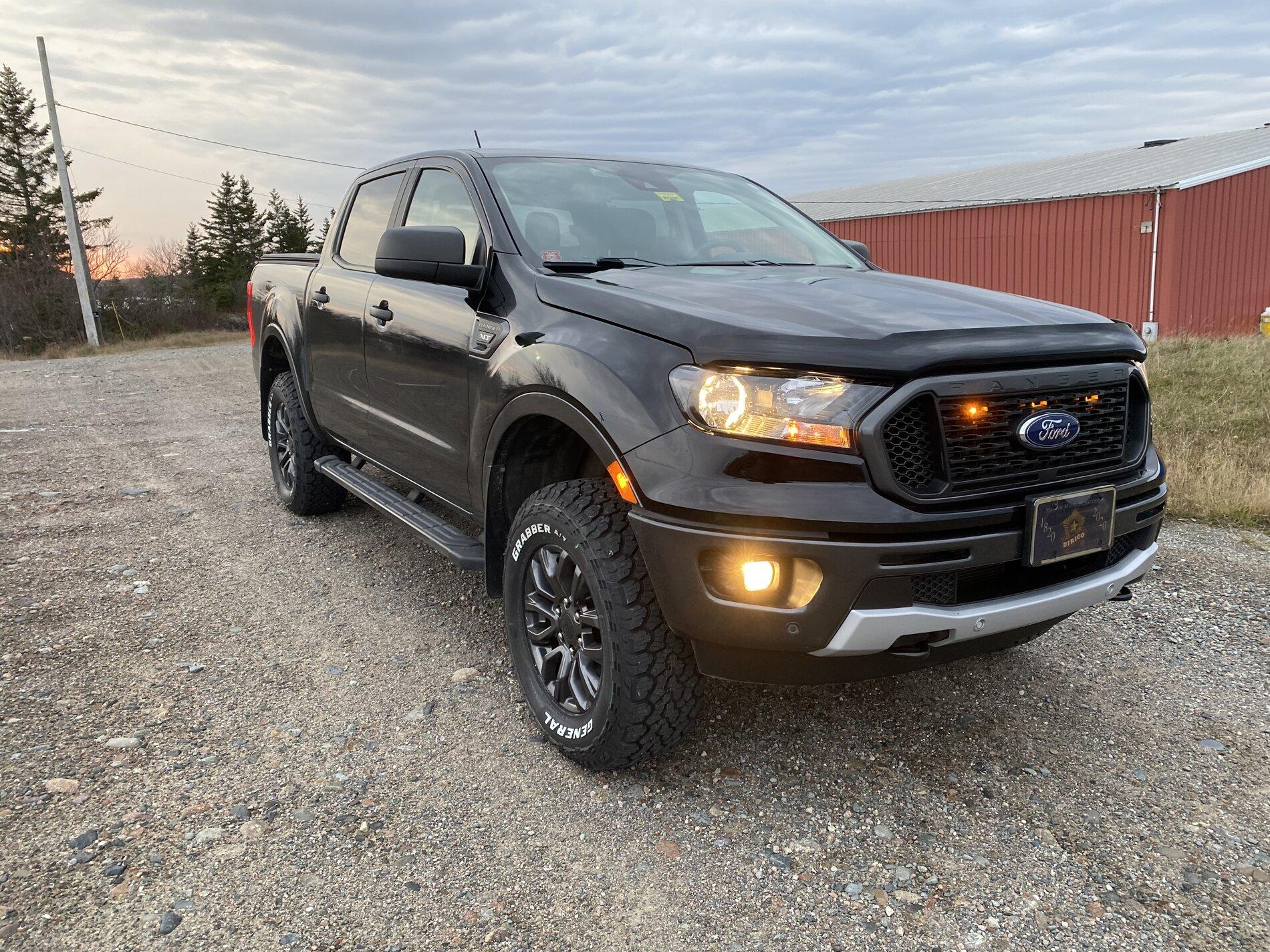

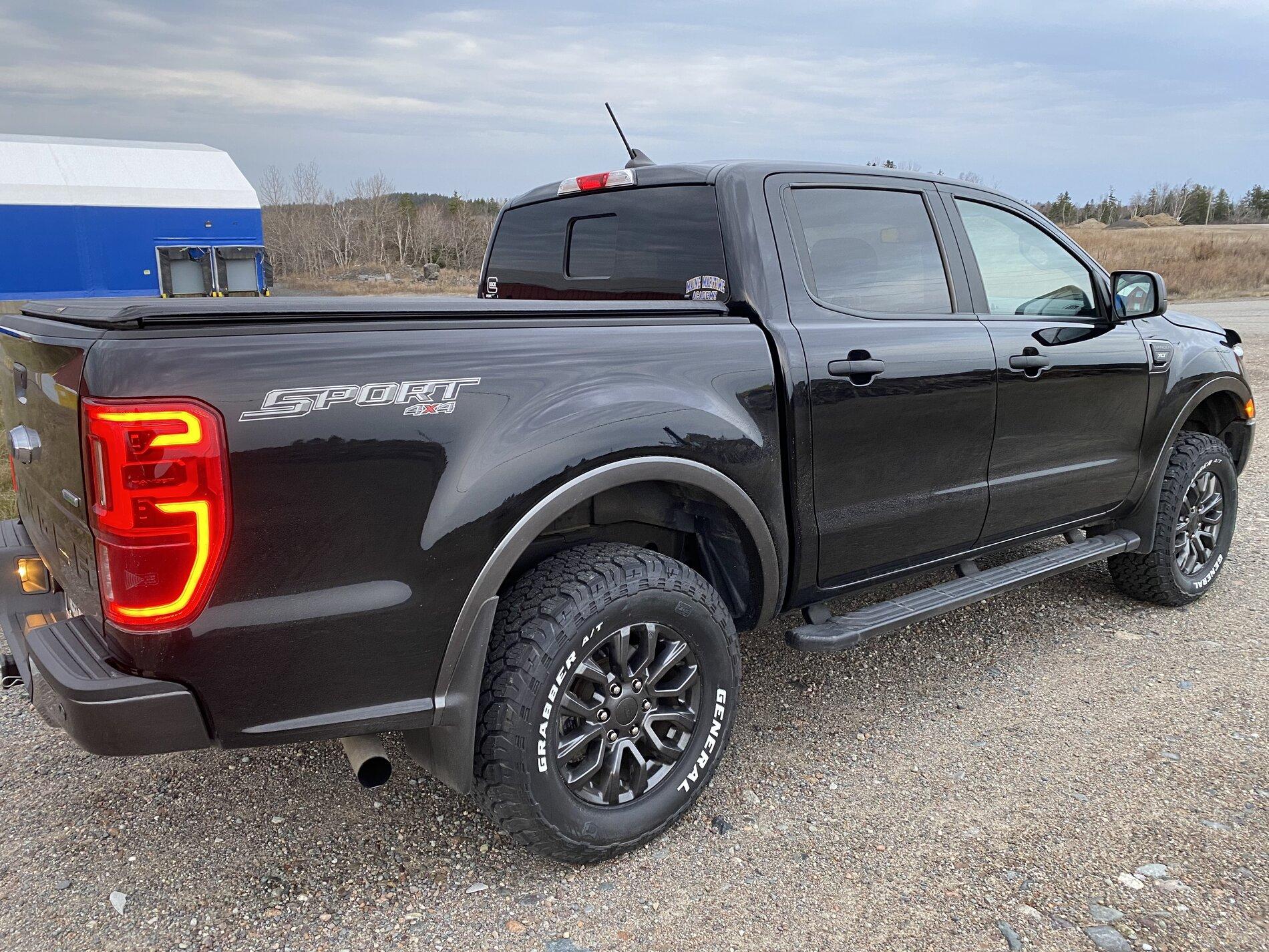

I had the old General Grabber AT2's on a few of my old trucks over the years. My main concern was not offroad capability, but overall tire quality. I put a 2.5" Rough Country Level in over the winter and decided now would be a good time to upgrade the rubber. Honestly quite happy with the outcome. The ride is more comfortable. Gas mileage hasn't suffered. Traction is better, oh and the Ranger finally looks right!
Since these weigh less than the Falken Wildpeaks and I found them cheaper I really think more people should look into them for everyday use. ( I have nothing bad to say about the Falken bandwagon, I just like my tried and true General Grabbers).

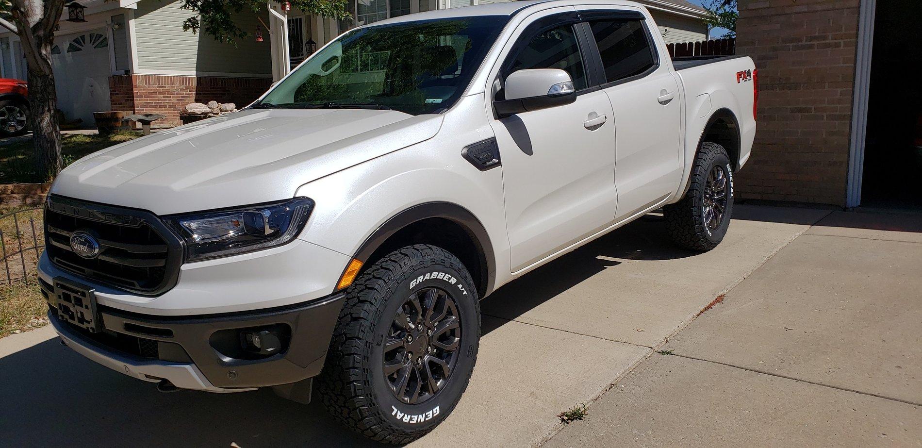

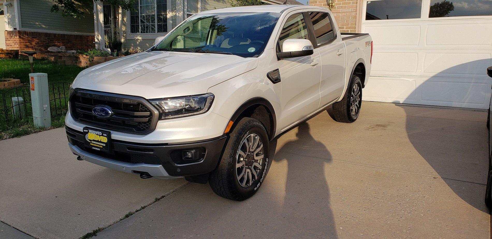

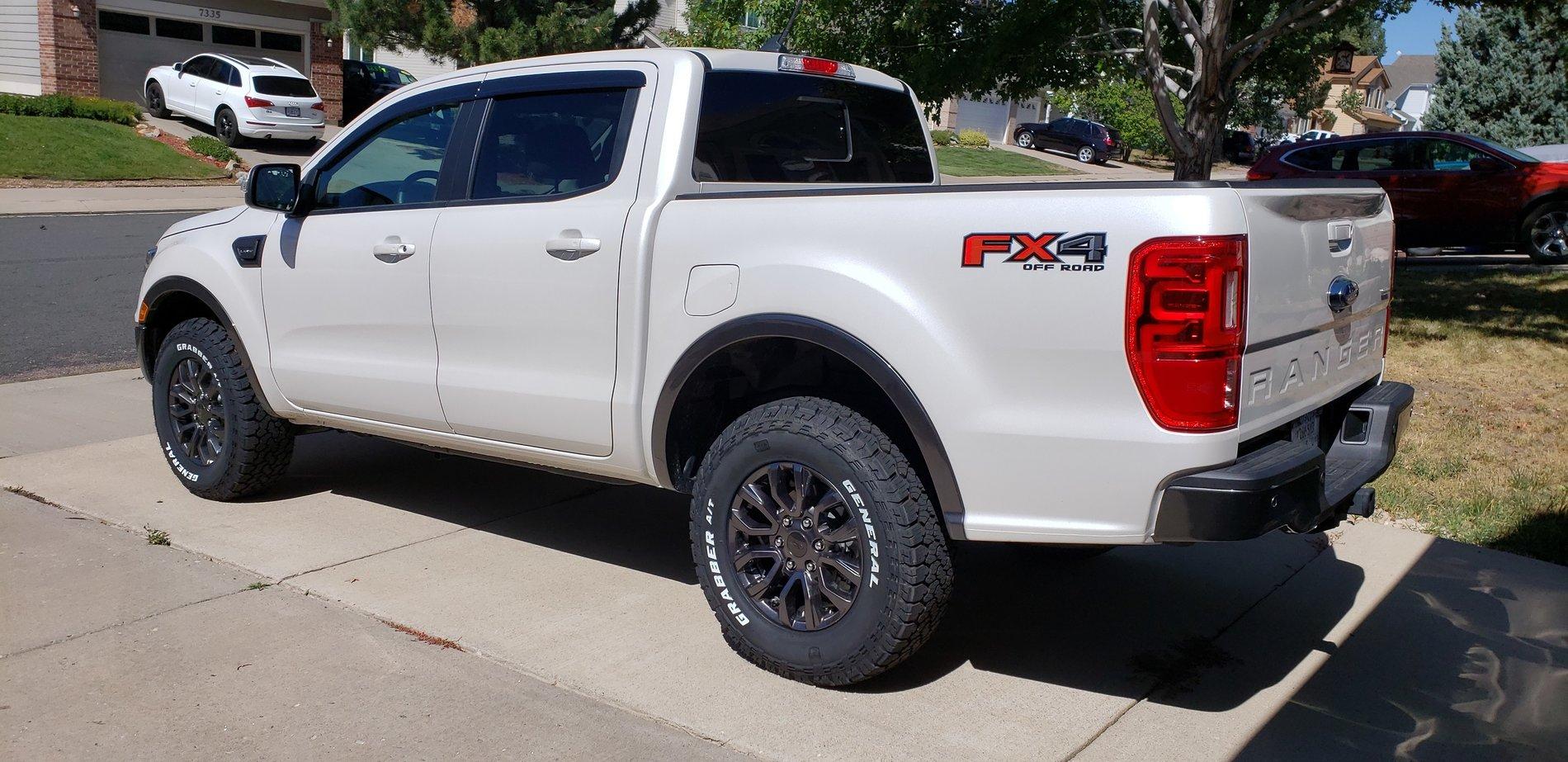

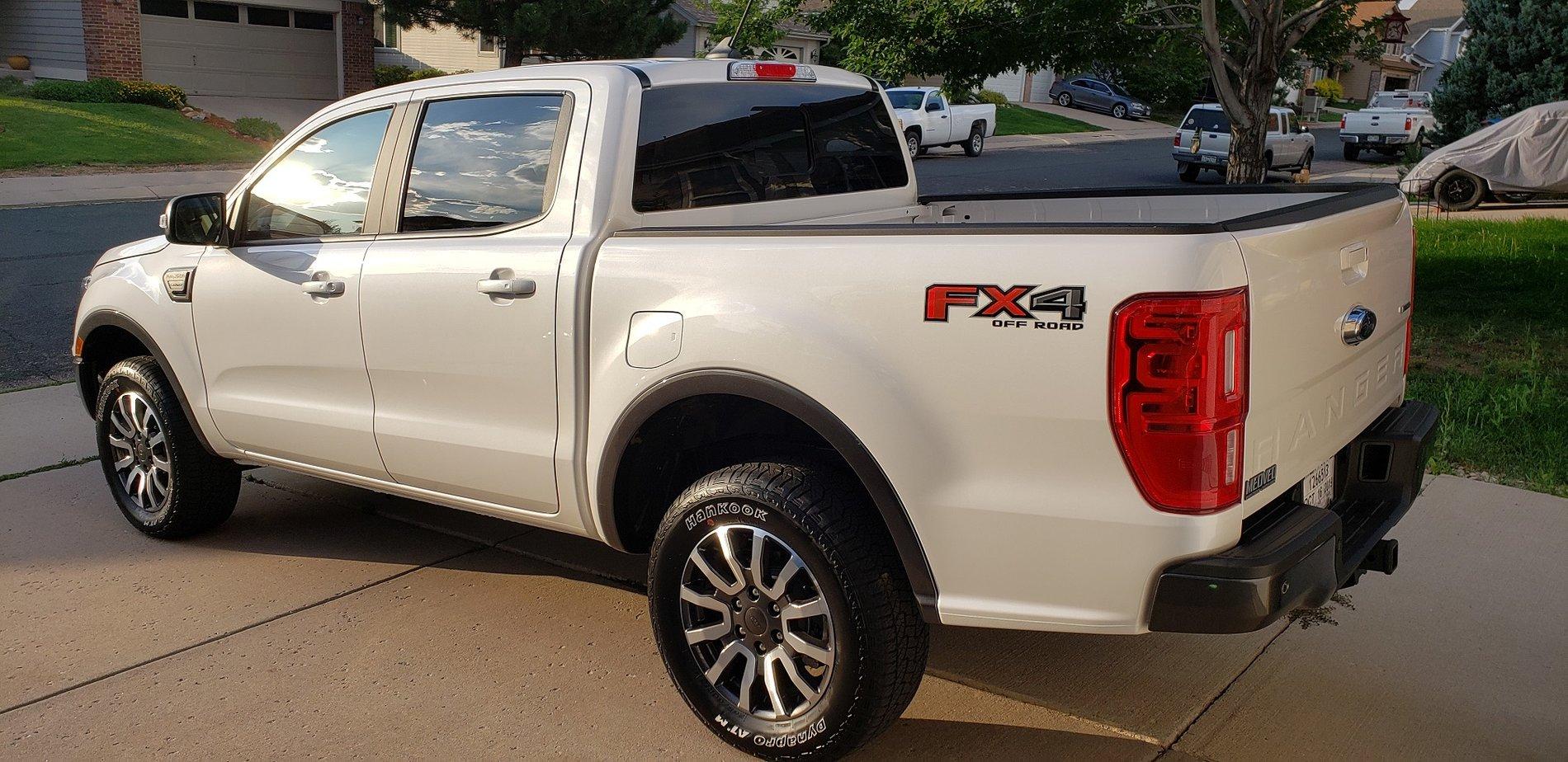

I had Grabber AT2s on my Jeep and really loved them. The ATX is the new version of it which has sidewall design from the top of the line off road X3, and supposedly thicker sidewall cords than typical 4-ply rated tires. Someone on the internet measured and compared it to a KO2 and the ATX was all of 0.5mm thinner. Load rating is a little higher, with the same speed rating, than stock at 115T over 112T.
Here's before and after, the stock 30.5" 265/60 R18 Dynapro ATMs on the machined magnetic 18" wheels, and now new Grabber ATX 31.5" 265/70 R17 on the magnetic painted 17" wheels.
