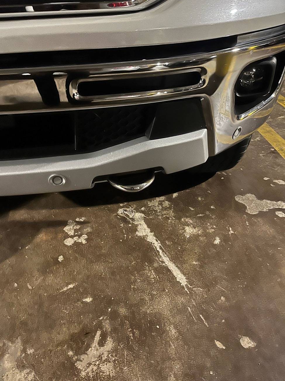

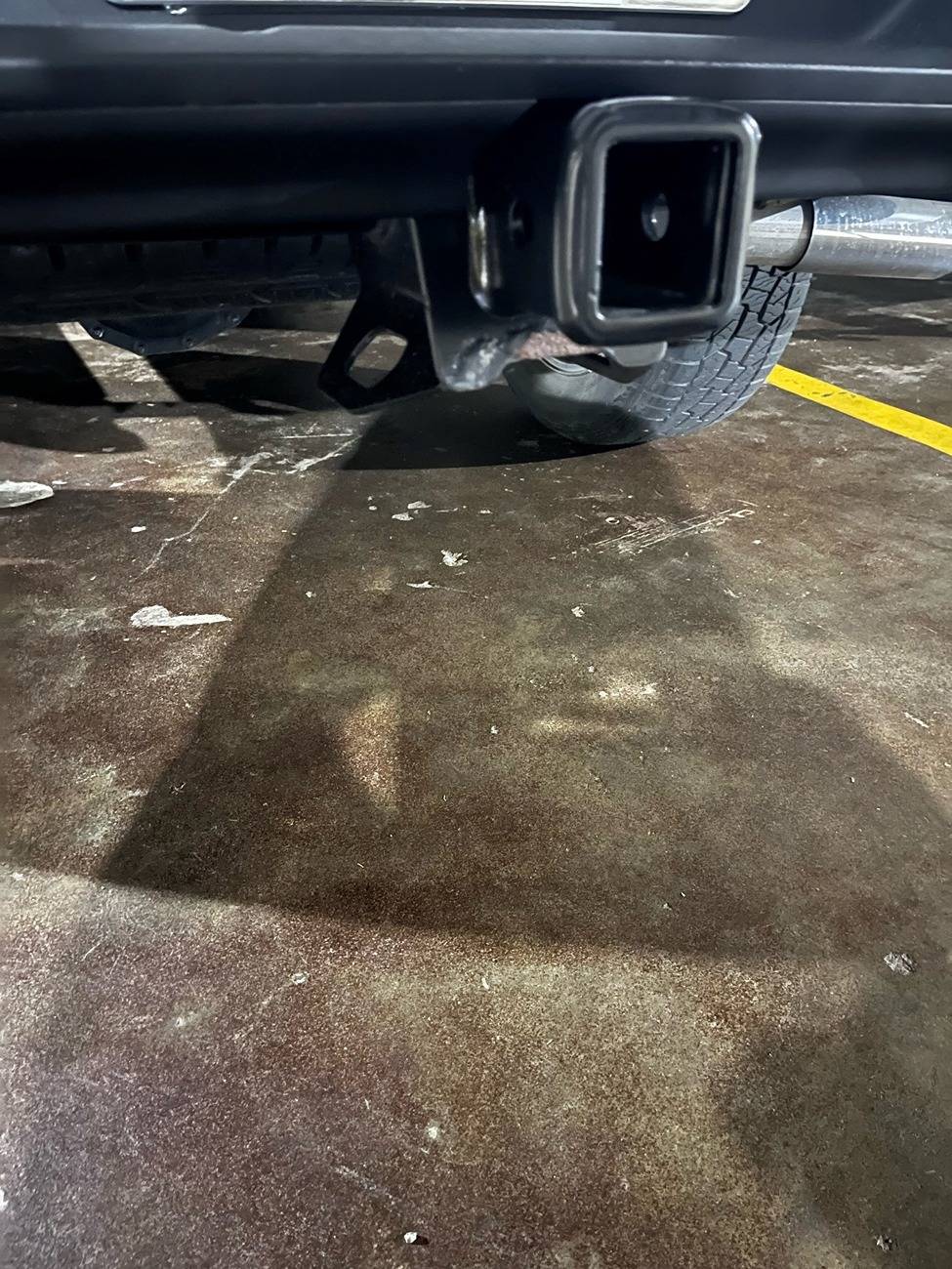

Taking the 2019 FX4 offroading with a friend this weekend & I wanted to verify what my recovery points are for the truck in case either I or they get stuck & we have to pull eachother out. The truck is stock with the towing package although I know to never use the towing ball itself as it can come undone.
See attached pictures & advise what I should use to recover my or their trucks with the straps we have if someone gets stuck so I don't damage my truck. thanks

Front hooks are good to go. Slap on a d ring or soft shackle to get the strap on.
You can get a hitch mounted d ring or just slide the hitch pin through the end of the strap.
Make sure you use the strap properly. If it's just a tow strap don't yank it. Recovery or kinetic ropes stretch and can be yanked a bit

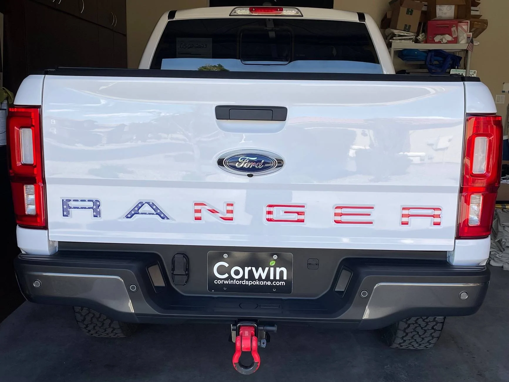

I bought the hitch ring off Amazon cheap enough and two extra D-Rings, also if you are going to be off road a lot a short tree saver strap comes in handy too :)
I snapped a strap last week snatching a tree out of the ground so make sure your not using a cheap snatch strap
and buy a Lock for it so no one can walk away with it!

Great minds think alike, I have the same one. lol I bought it a couple years ago for my Jeep and as luck would have it I got a Tremor so the red worked out perfect.
Good looking rear end you got there ??
I went with the rhino USA… black slide in and red shackle (they forgot to put in the little washers, told them and they’re sending a pair so that’s nice of them.) It held up pulling my parents John deer ride on top mower out of a muddy spot that my pops got stuck in ( not that impressive but it was the first time I got to use the rear point ?.) so it’ll at least do that ?.
