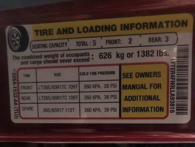

Here is the sticker from my 2020 XLT FX4 crew cab.

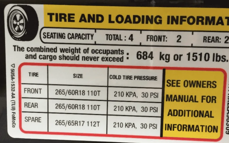

Sure is a lot of variation. Mine says 1510 lbs. 2020 XLT Supercab FX4 302A tow package.

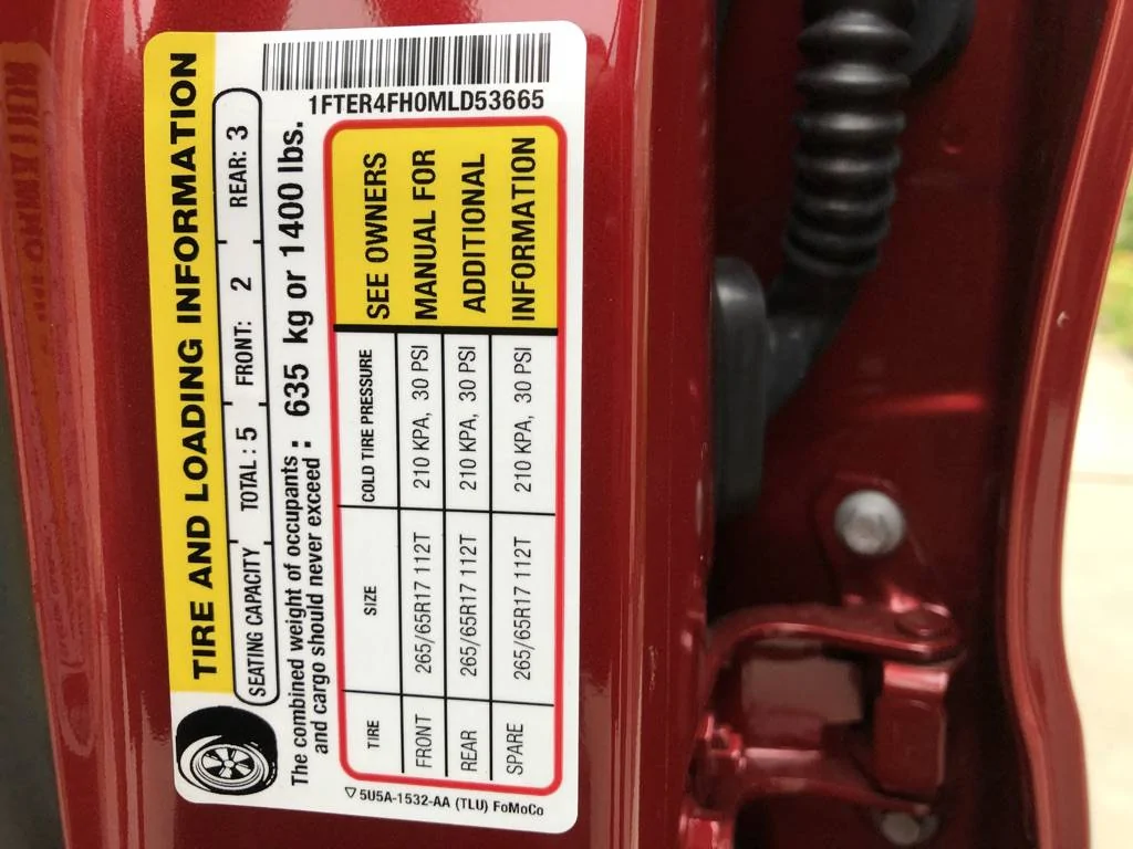

Interesting... my 2021 XLT 302A, tow package, FX4 crew cab says 1,400 even.
