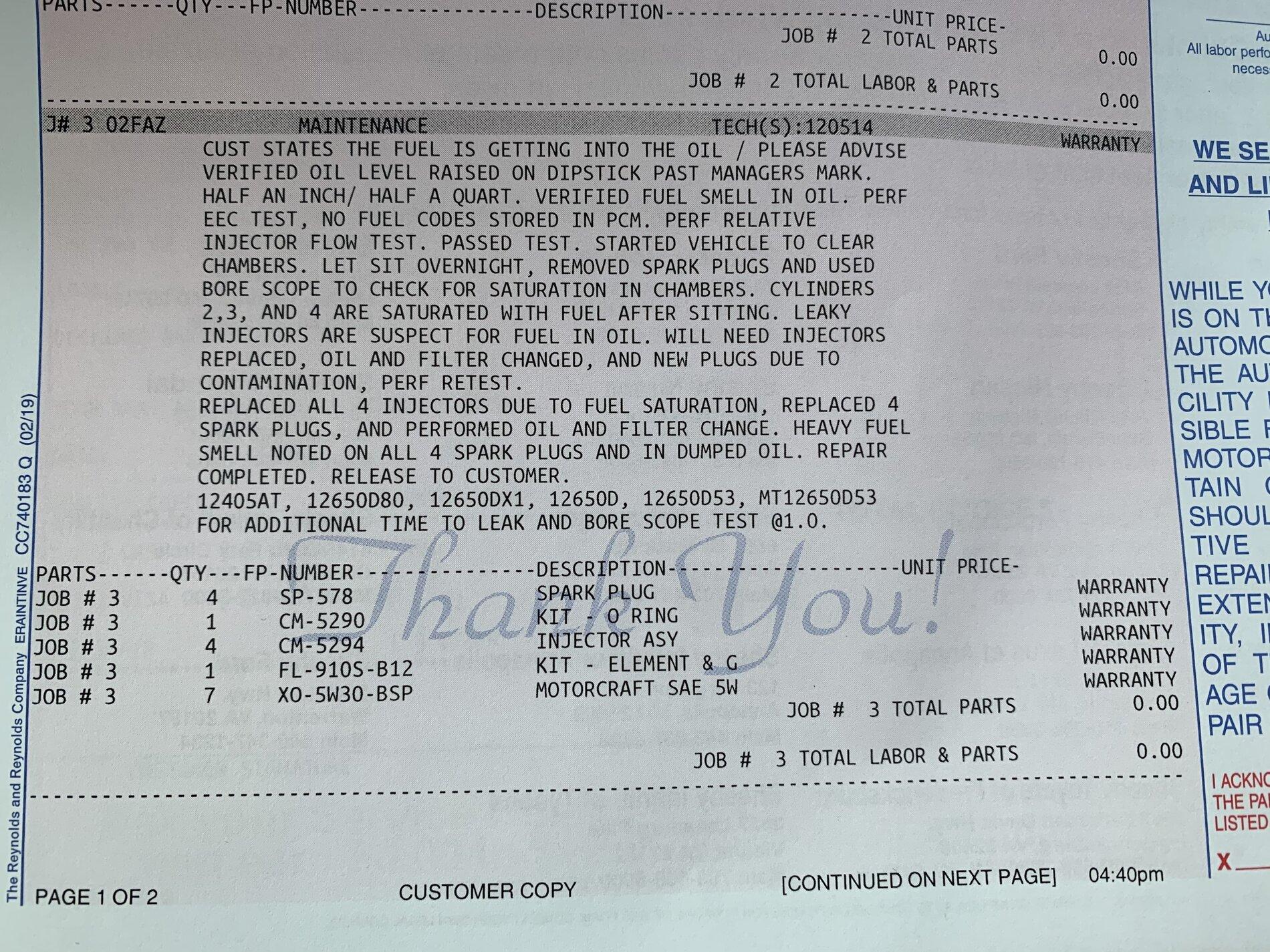

Dealership just called me - the new injectors won't be in until April 7th. "If" they come in I am looking at getting the truck back on April 9th. They never used the words "back ordered" but said parts were getting hard to get.
Just picked up the Ranger from the dealership after 15 days. Here is what they did:
They claimed they did all those tests on mine and it passed them all! Before that they did change the HPFP, that helped it was really bad at that point!
I have no idea what to think. Hopefully they are being honest and this fixes it. I will give it 500 miles and see where it is at.
Mine is going in on Tuesday next week. Not sure if I should show this to them outright or let them try and diagnose. The service advisor was very short with me on the phone and didn’t leave me feeling like they were going to take it seriously at all. This was the dealership I bought the truck at so hopefully they treat me right. Not been fun dealing with this one a brand new truck that I otherwise really like. My oil is now at the top of the twist and reeks badly like fuel where you can smell it just pulling the dipstick.
How long did it take to get to the twist?
I printed put the pics (of service write ups) that other members posted and gave it to my service advisor. No idea if she passed the info along to the tech. My attitude is it can't hurt. I honestly feel like the dealership took a vested interest in this issue. They took care of me so far. Gave me a loaner for 15 days when they did not need to, and the service advisor called me a couple times each week to keep in touch.
