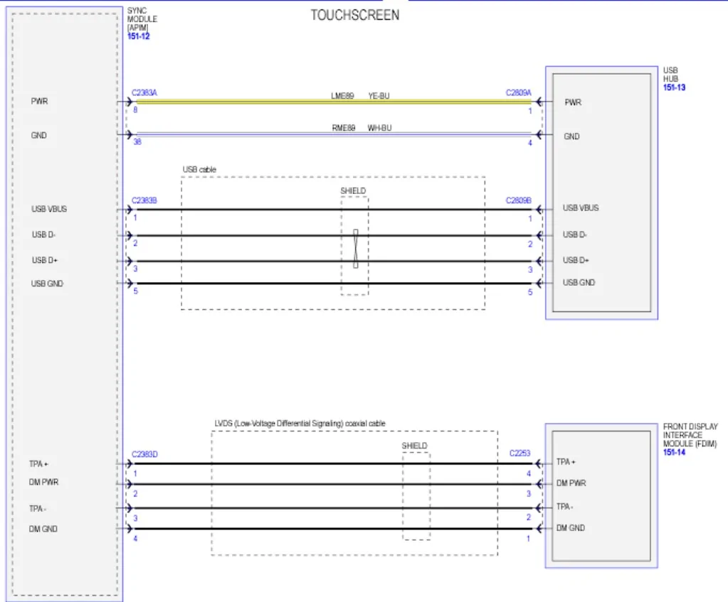

Here is the diagram of the front hub. Check the wiring between the APIM and the USB Hub. If wiring is ok and hub is new, it would seem to be a bad APIM Sync module.

Thank you for that diagram. That will help tremendously tomorrow.

Make sure that C2383A and C2383B connectors are securely plugged into the APIM (Sync) module as shown in the diagram. Perhaps one of them came loose when installing the new hub.

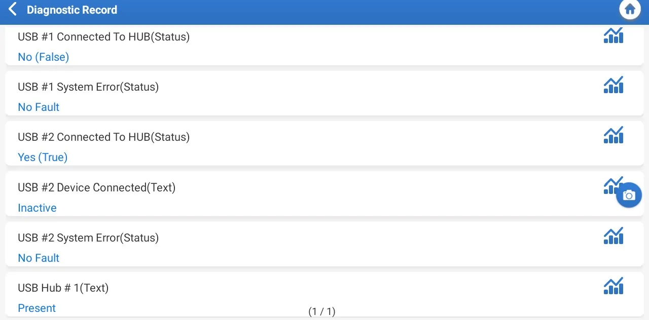

If you have a scan tool capable - check these Live Data PIDs
Check that Yes (True) displays when the USB is connected in each port and you do not have any error status displayed.
Pay attention to:
Do the Hub (Lights) go out when it faults? or do they stay lit?
Noting that: - (Determines if HUB Power Issue or USB Issue)
C2809A = Hub Power & Ground - Powers the HUB & Lights
C2809B = USB Cable (APIM to HUB) - Data & Charge

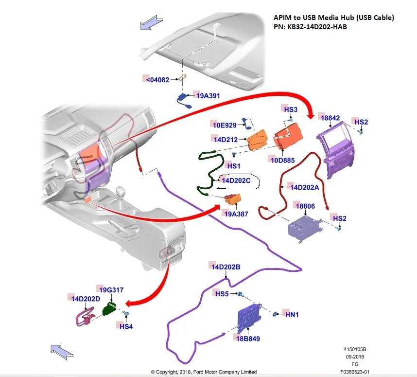

For your issue - if it is not resolved by (Re-Indexing) the USB, before I would replace the APIM, I would try a new (USB-Cable) between the APIM & Hub
10-4 on a new cable. This will cure the majority of connection problems. Also, go to settings and check for updates,
